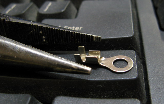

WOW...huge Photos!!..hey YWH...pretty soon i will place an order with you....hopefully within this coming week!...thanks!
No results with thingy... I must find place where someone do spot welding 😛 ****
Why my lamp wasn't spot welled...!!

zeims said:No results with thingy... I must find place where someone do spot welding 😛 ****Why my lamp wasn't spot welled...!!

yes nothing happens. only way i have done it was using some wire around the 2 wires.

I didnt use solder... I dont know what is causing it.
Do you know where to find spot welder? Maybe jewrlers shop or dentist as ywh said..
No, but I try to find. I don't want to go to the dentist and say "Hey I need to get my lamp fixed" 😀 Jewelry shop may have it and some schools.

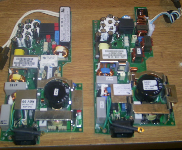

Hi guys,
I have an Infocus LP530 with an ageing lamp and I was thinking of trying to replace the bulb in an old lamp module that I kept. The thing is that my projector has had a power supply upgrade (now takes SP-LAMP-LP5F rather than old SP-LAMP-LP5E) and apparently that changes the bulb ignition voltage. But the bulbs that are listed on diypro do not talk about ignition voltages so how do I tell what is suitable?
Also, if ignition voltage of stock bulb can be assumed to be OK, diypro shows 250W or 280W options for the JYs-SE/DC bulb, but the LP530 specifies 270W. Would 280W bulb be OK to use or do I need something else?
And finally there is a post earlier saying that YWH sourced lamps do not work reliably in the LP530 and will cause the power supply to fail. Is this talking about the pre-modified power supply having too low an ignitin voltage for these bulbs, or some other problem?

Hi ! zeims
"basic wire" is made from titanium alloy.

Hi phimay
250~280 are same, dont bother.
I have found this problem, they are 2 type ignition voltages , my lamp can not start first, but now I have done other low ignition voltages JYs-DC bulb, no problem now.
they are low ignition voltages ballast and high ignition voltages ballast
