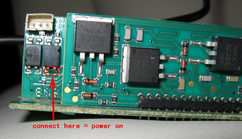

Im not sure about polarity. Can someone see connector that is positive?
I readed that broblem could be that polarity is wrong. I installed bulb same way that previously bulb was installed.
It should be like this, but is it really?
the lamp is AC, no + -. dont bother polarity broblem.
you can try do this like my picture

Hi ywh!
I managed to get it work. When i set bulb power to max 😀 and put projector to cool place (0c), i managed to keep it on.
Didnt try that (22c) because bulb/ballast could fail.
Seem to be that component has failed. I think so, what you think? Problem in ballast component?
I had no problem when i had previous bulb, might be that new bulb stresses more (broken) components?
Any suggestion what is broken? Lets buy cold spray and track it down.
Hi jarkkoh
what happen when you short that pole like my picture?
there is a Thermistor in you projector I think, have you clear the dust? may too hot.

Hi ywh!
what is (22c) = degrees temp outside projector.
what happen when you short that pole like my picture? = it works as trick should do, power on but same problem stays.
Its not temp sensor, 1:st thing i checked.
Notified that its not temperature related problem at all.
I did check projector with cold spray. Didnt find anything.
I added extra 10k resistor to power adjust and get 57k.
It stays now longer on, but see this picture. Cant make it work with that bulb. Help please 🙂
How much voltage that bulb require?
Bulb that you say you sended me was 200W BSM-AC-H.
