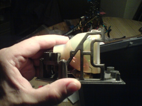

Hi again ywh
Now I bought the projector.
And The lamp is an UHP 132W and not 120W as I wrote earlier.
A freind of mine, told me that he is shure i need a UHP replacement bulp that is different than the one you have told me. So now im a bit confused.
I have Attached some pictures of the actual lamp in the Projector.
UMPRD150LU lamp
Do you have a UMPRD150LU lamp? How much? and also shipping going to manila, Philippines
