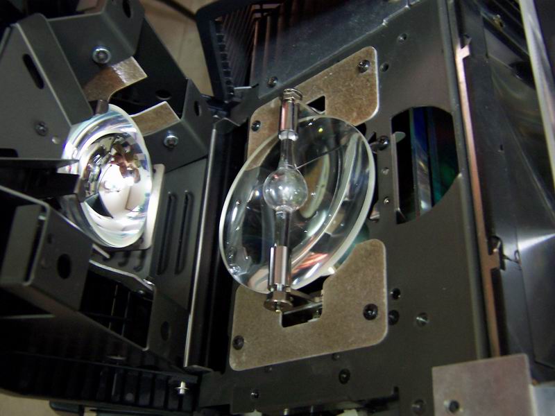

The bulb is difficult to take of.
There is a metal ring precisely the size of the narrow glass socket.
Cant pull metal ring out because the metal socket is bigger than the metal ring.
And hole is so small that i cant pull out the bulb :S
So, takes some time to get it out.

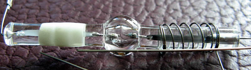

The buld is malformed and totally black. Looks like= --8--
I hope that i can measure arc lenght with bright backlight.
I put that picture next week.

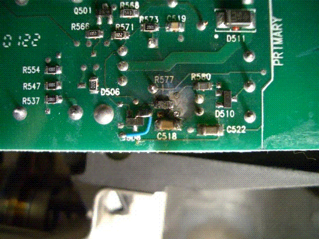

Hi ywh! Thanks for the lamp (got it a week ago) it worked great
the first day i testet it (bright and with good colours).But sadly the next day the projector broke down just after 30 minutes.After checking the powerboard the first thing i noticed was that the resistor R577 is burned (and open) and the condensator C518 is shorted.After some reading in this great forum I guess that the viper100a and one or two photocouplers SFH617A-2 is gone too and C13
(el.condensator 100mikroF. 25V).And the 3 pinned component on the left of C518 marked ?508 (i can´t read the first letter ).
I guess schematics for this powerboard is impossible to find.If i gonna try to repair this i need to know the values of the following:
R577 ??? ohms (can´t read the numbers because its burnt think it begins with a 5 and ends with a 0)
C518 ?? (got no markings)
?508 don´t know what this is transistor or diod ?? (it´s marked n5 JE)

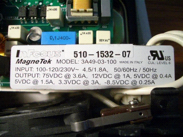

Projector: Infocus LP530
Ballast: MagneTek Model: 3A49-03-100 (Output:75VDC @ 3.6A)Original lamp is: 270w SHP now lamp is 270w JYS/DC from ywh
Can you ywh or anybody here help me with this, or where i can find a new powerboard?
Any help would be great! Thanks!

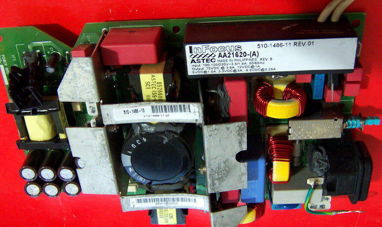

Hi!and thanks for your answer ywh.Looks very different from
mine (look at attached picture) but do you think it got the same parts on it that i´m are looking for? If so maybe i can move the parts on to my board.In that case how much is it, ballast and shipping?

Hi Wombatten!
the price of my ballast is $80, shipping is $25.DHL, 15$ in post system
but are you sure you can use same parts on it . you can ask them before you order my ballast
