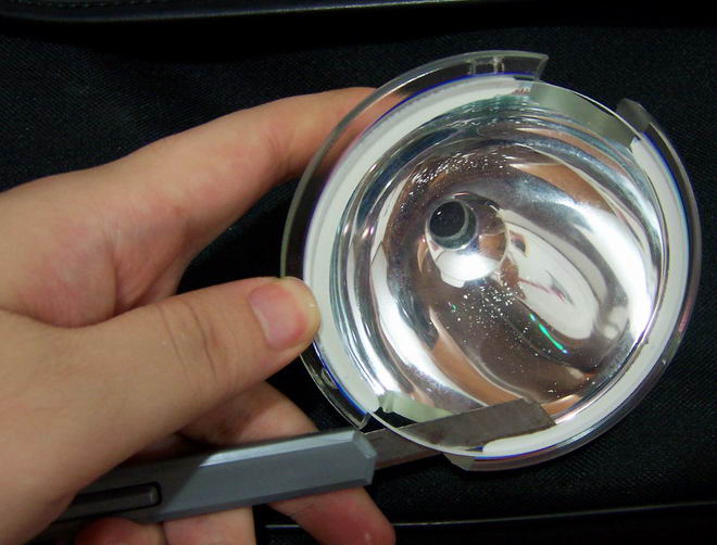

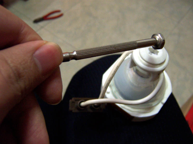

Hi all: I received my new lamp from YWH and have been attempting to remove the cement holding the lamp in. I have 3 questions.
1)I tried soaking the whole reflector assembly in water as suggested in other threads to no avail. My first problem is removing the clear glass lens/cover on the reflector assembly. It is held on with cement under the lens and I cannot find any tool small enough to scrape under the lens to remove the cement. I tried fileing down a needle to as fine a point as I could make with no success. How the heck do other people do this?
2nd) Once I get that off I will have to remove the lamp itself from the ceramic reflector assembly. Once again it is cemented in and the cement is as hard as a rock. Scraping at it with an X-acto knife does nothing. Any advice would be appreciated.
3rd) Has anyone used black furnace cement for holding their lamps in place? I am sure the temperature will be fine, but is the original cement designed to transfer heat to the reflector assembly as CPU thermal cement does? Or is this not necessary. I received a tiny bag of cement from YWH but it may not be enough.
Any help would be greatly appreciated.

Hi Stampee!
---you can cut or slash the glue with a fit narrow knife, or shave. I have no reflector of 340, but it is like.
££££you can scrap the cement cover, dig the cement around bulb.
---- cement is enough for this type lamp. only around a end bulb.

Removing the front lens
I have been using YWH's trick of heating the front lens on an electric stove. It's a pretty quick method.

- I got my new lamp. It is for commercial projection use. people use it to replace the
