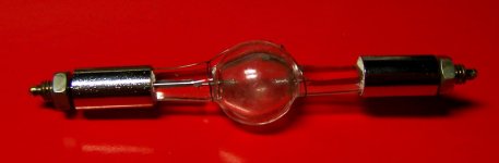

Pictures:
Benq (still in the reflector):
Broken lamp of the hitachi 850, from what I see I think it is DC. I see one longer, thicker electrode that has cracked and is loose in the bulb:
the whole voltage matter your said is operational voltage, there is othere matter, the start-up voltage.
so my bulb can not work on a 400w electronic ballast of HQI.
I have other type bulb, it can work on a 400w electromagnetic ballast of HQI, but not the 400w electronic ballast of HQI. look the pic.
the bulb still in the reflector is a DC super high-pressure mercury lamp
,it is NSH, but my 200w jyd work on ballast of NSH is not well. there are some risk.
Broken lamp is metal halide lamp, and you can test the operational voltage , DC or AC.

Do you have a 250w version of the lamp on your picture (this: http://www.diyaudio.com/forums/attachment.php?s=&postid=1099840&stamp=1168136494)?
And this lamp will work on a 250w hqi ballast? (normal one, not electronic)

yes!
70mm (diameter) spherical reflector work good with the 250w lamp!
but the single LCD system is not brighter, your DIY is a single LCD system
, I suggest you choose the 400w bulb.
you use this 250w lamp with your one non-electronic 250w ballast if the V is 220v .
you can get a 70w~100w non-electronic ballast, non-electronic fluorescent lamp ballast. parallel connection your non-electronic 250w, so they are a about 350w ballast, run my 400w bulb is great!
note, remove the capacitor, my bulb dont like the capacitor.
the price of bulb is $40, the light house system is $40 too. shipping is $15 for them, total is $95
light house like this pic, you can get its holder, but there are no bore in the top of light house, you have to set the holder on the soleplate of your projector.
