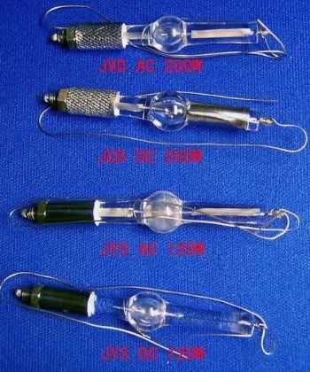

so where would i buy my replacement lamps? I assume i have a DC lamp. you can look at the photo above.
the model number is L120 to go in a Proxima 5800 desktop projector. also, how do i install the lamp in my reflector, i never done this before. it looks like it was in plaster. would i need something to replace whatever it was in? i'm assuming it's to transfer heat? bare with me i'm new with this.

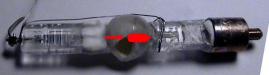

are the electrodes like this?

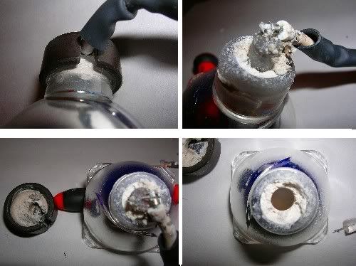

Some have mentioned that you soak the lamp bottom down in enough water to cover the white cement.
Let 'er soak for a few hours and take a small jewelry size screwdriver and use it as a pick to slowly work your way around the bulb from the backside.
I myself used hot salt water , not by anyone's reference but I just thought that being salt breaks down alkaline in cement and if there was any in that type .. Oh well , anyway it works . It's a slow tedious process without breaking the reflector, pick some away , re-soak for a while , pick some away etc..

Here's a pic of what I was talking about , I was able to wiggle the bulb out after it softened up ever so slightly might I add.., but was moist enough to allow the bulb to come out.
Much easier to get the rest of the cement out.
As you can see in the pic that bulb was originally off center , I've read that centering it is important to get even light output.
Notice the crack and where it is in comparison to where it was slightly off center?
I was considering digging about 3/4 of the cement out and using the little left as a guide , but not going to after checking out that crack from heat.
I'm still tweeking around in thought on how to center it , I've researched the cement available for these type applications and most are able to speed curing by about 200 degrees of heat.
That would help , I'd just use my heat gun., but if you have no heat gun , I suppose a blow dryer would work.
On the soldering thing , I'm just going to use crimp sleeves , solder might melt ..
