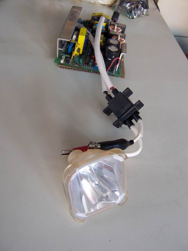

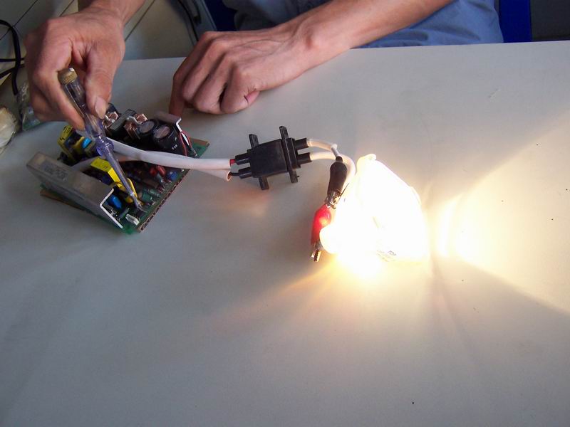

- I got my new lamp. It is for commercial projection use. people use it to replace the
