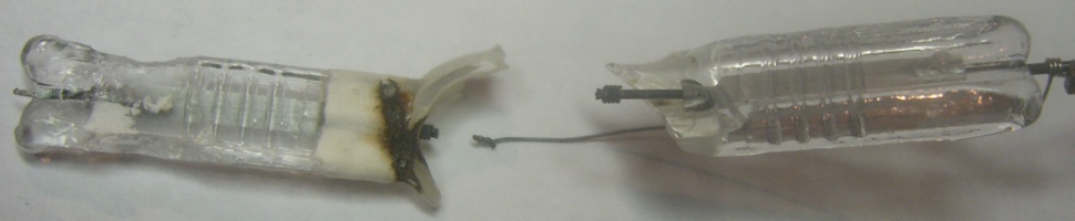

how about the electrode? one bigger one smaller?
Hi YWH,
as I stated, the burner exploded. I've attached a picture of the remains, I couldn't tell if on electrode was bigger. Maybe you can see more.
Thanks, Sigi

that is like the wire burned the glass , please clear the burner before it run, ethanol is best.

Hi YWH,
I guess you missunderstood. I originally asked you for a replacement burner for a Sharp XH-E690U projector (see post #2364) and you responded asking if the electrodes have different sizes. That's why I took the photo. I still don't know which one I would have to order.
Thanks, Sigi

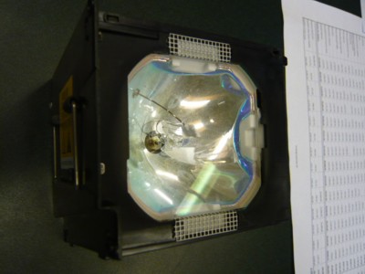

Hello ywh,
I have recently read with interest some of your postings in diyaudio.com regarding SHP project lamp with placement. From the postings it appears that you are able to provide bulbs to rebuild the lamp.
I am currently looking for a supplier of bulb in order to rebuild a lamp in my SharpVision XZ-10000 (AN-K10LP (BQC-XVZ100001)). My research indicates the bulb is a 270W SHP/ 2000 hour. I do not know is the manufacture and model number of the actual bulb and have not yet to disassemble the lamp to check for identification marks or labeling on the bulb.
I also noticed in your various threads that you sometimes reference the reflector, referring to two different shapes and/or styles. From a novice perspective my reflector appears to be in good condition with low damage or discoloration although I am uncertain if a reflector must be changed out along with a bulb. For your information the bulb did explode but it does not appear to have damaged the reflector. I am attaching for your reference a photograph of the reflector still in the lamp assembly.
Would you please advise if you are able to supply the reference bulb and if so the cost and delivery time.
WDC

Hi WDC!
My 270W BSM-DC is 2000 hour, the older reflector is not so best if you use luminometer to test it, but that is OK in your eye.
