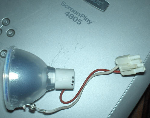

I got my new lamp. It is for commercial projection use. people use it to replace the
I would like to buy the bulb-reflector unit, or can I send the unit to someone to get the bulb replaced? I don't think I could do the replacement without a step by step guide.

150w BSM-DC bulb can replace your bulb.

cement
I worked in dentistry for many years - there are numerous plasters and stones we used for models that should be heat resistant enough for the bulb base job.
The plasters tend to be a bit weak and we used them mostly for preliminary models. The final models were made from a stone (basically a refined type of plaster) with exceptionally high strength. At least as stong as the cement I found in my bulb base and this should be ideal. Strength does depend on the amount of water used and how well it is mixed.
I'm faily sure these would have adequate heat resistance. If you're uncertain though we also used various investments as well (plaster like materials that mixed with water or other liquids and reinforced with high temp tolerant materials) to surround wax shapes for casting of metals.
(A crude type of investment that can tolerate moderately high temps can be made by simply mixing plaster with pummice sand but it tends to be a bit weak and crumbly).
Investments must tolerate very high temperature in the furnace up to 1600 c and contact with molten metals including stainless steel for metal dentures - so they'd have no problem with bulb temps. Some investments are quite weak and crumble easy - some are very strong.
I'm sure if you went to a dental laboratory they'd sell you the small amount we need for a nominal price, probably even give it to you if you asked nicely - they buy the stuff by the drum load.
