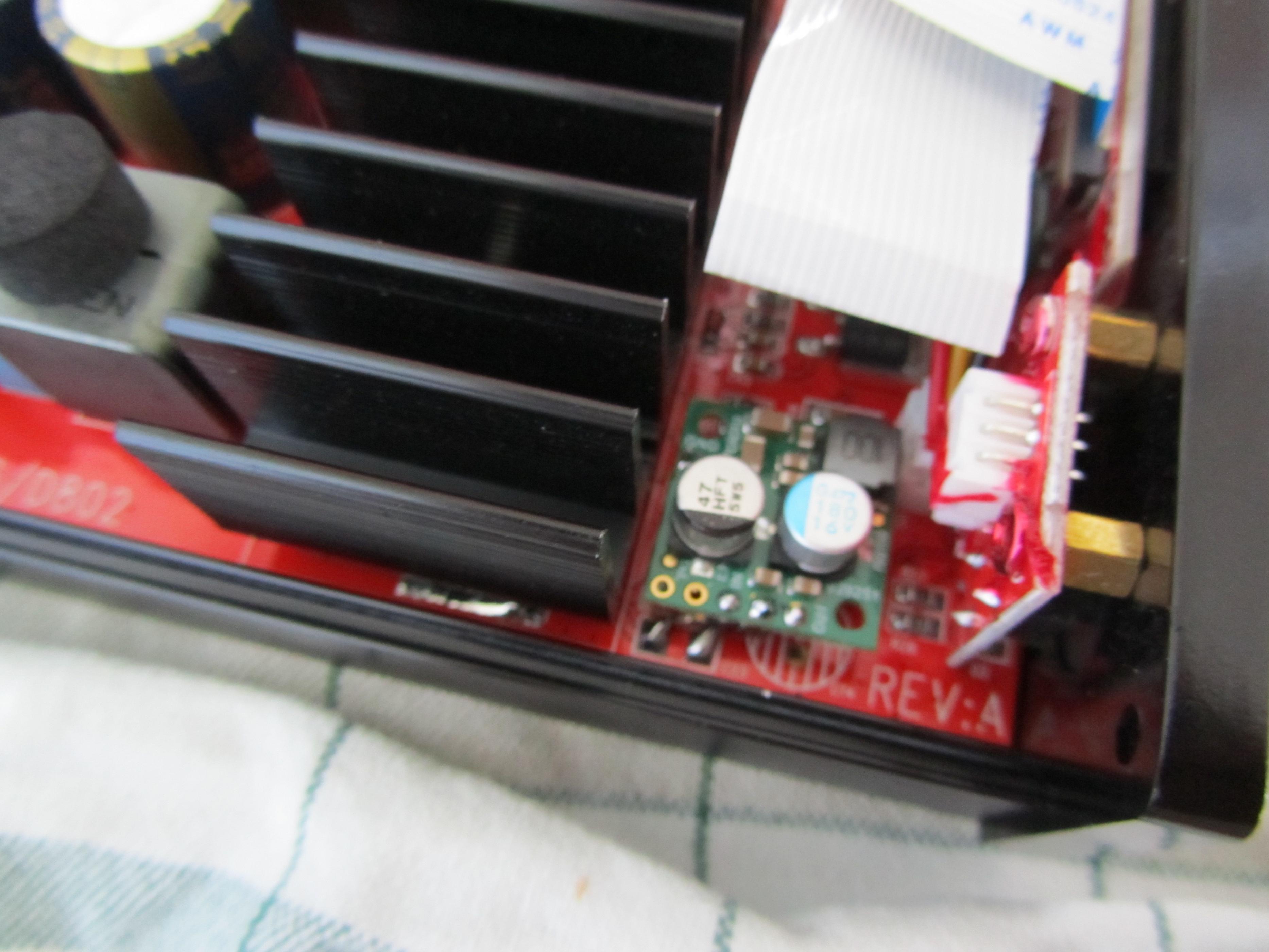

Anyway, I replaced the XL2596 for a Pololu 12V, 2.2A Step-Down Voltage Regulator D24V22F12. Way less ripple/noise but still not as quiet as a linear reg. No heat though which I like more as the switcher is working as long as the 32V adapter is plugged in...
I promised a picture. 40 mV peak-peak is better than it was before (100 mV peak-peak with the XL2596) but I wish it was better.

Meanwhile I improved some things in my D802. I shielded the Pololu regulator board only to discover the D802 itself slightly emits some EMI at the speaker outputs. This is only when speakers are connected. As I coincidently had another device emitting EMI I had hard time as even the optical communication stopped. The other device was switched off and the slight EMI the D802 emits no longer was a real problem. Now my attention goes to the other device which was supposedly a quality product but it is a real transmitter. Its tiny PSU is so noisy that when I keep it near the D802 the display of the D802 is flashing !!

With 14 mV RMS ripple at the 12V line I really should not complain and I see this as a finished modification. It sounds very good. FX Audio and North Flat Japan have released a new version for the japanese market. It is called D802J. When looking at the D802J i don't see much difference except that the PCB is white but it still is the 2014 revision so the new version still has the XL2596.

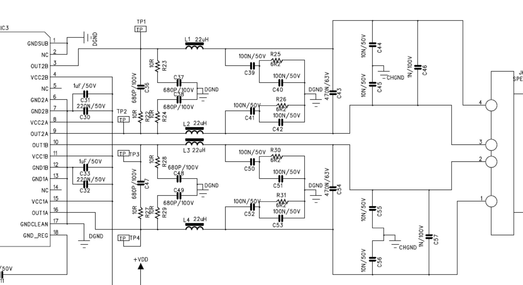

I wonder if the output filter can be improved. The D802 filter is much more simpler than the one in the datasheet.
D802 is missing 2 snubber to ground (before and after inductor) and several filter caps.
Another concern is all the smd caps around the sta326, since the D802 can get quite warm on the heat sink, as temperature goes up, the smd capacitance goes down depending on the smd cap quality.
