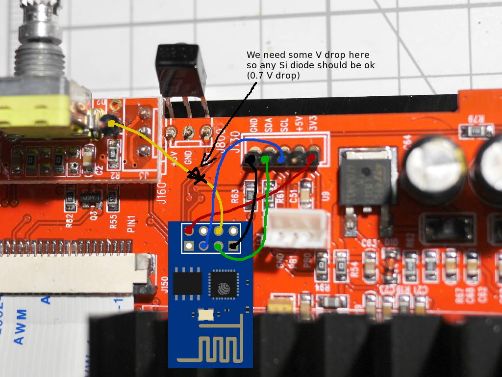

I probably find a solution for that annoying auto mute of the D802. In the datasheet of the STA326:
http://www.st.com/content/ccc/resou...df/jcr:content/translations/en.CD00062804.pdf
At page 31 is the description of the bit ZDE from configuration register D. ZDE is "Zero detect mute enable" which means after 2048 samples of zero, it auto mutes the corresponding channel.
My solution in short, I simply attached a micro controller (in my case an ESP8266) to the the I2C pads near the display and set the ZDE bit to 0. This works and the auto mute is off and now there are no more clicks between audio tracks.
Unfortunately this bit is enabled again after reset, also the MCU of the D802 resets this bit every time switching on the amp. But as far as I figured out, the MCU does not touch the register D after that.
So my idea is to connect a small MCU (maybe an ATtiny) to I2C, which wakes up at switch on and about 10s later set the ZDE bit to 0.
Also there is another auto mute bit: IDE in register F (page 34). This bit means "invalid input detect auto-mute enable" and mutes the output if there is no valid input data. This bit also is enabled by default, but thats ok I think.

So here is a little how to for the D802 auto mute (click) fix. I'm using it on the D802C, but it should also work with the D802.
Needed:
- ESP8266-01 Module
- A Programmer or USB2Serial adapter (3.3V!), see my post before
- 5 wires
- A diode (1N4001, 1N4150, ...), we need 0.7V drop
We need this diode, because the ESP8266 is 3.3V and not 5V tolerant, but maybe it works without this diode.
Programming the ESP8266:
To put the program onto the ESP8266 you have to install the Arduino IDE. Inside the Arduino IDE you have to install the ESP8266 platform. A good tutorial can be found here:
ESP8266 - Easiest way to program so far (Using Arduino IDE)
https://github.com/esp8266/Arduino
In the Arduino IDE, load my code and press the check mark to compile. If there are no errors, connect the ESP and programmer/serial interface and upload the code by pressing the arrow button.
Wiring the ESP8266 to the D802:
Near the OLED display there are 5 solder pads (GND, SDA, SCL, 5V, 3.3V), here we have the I2C bus. Also we need one pad near the rotary encoder (on a DMM you should get about 4.3V here). On my photo I soldered some pin headers here.
Wiring ESP -> D802:
GND -> GND
VCC -> 3.3V
GPIO2 -> SDA
GPIO0 -> SDL
CH_PD -> Pad near rotary encoder (need a diode here!)
Put the ESP8266 near the D802 MCU should be a good place.
Optionally:
Break out the red LED from the ESP8266 using a small screwdriver. This LED is to indicate power on, but otherwise useless and only draws some mA.
How it works:
If the CH_PD of the ESP8266 goes to high, the ESP8266 will start running (blue LED of the D802 is on). The pad near the rotary encoder gives about 4.3V when the blue LEDs are on. (The LEDs are switched by a transistor, so we have already about 0.7V drop here, 4.3V = 5.0V - 0.7V). So we use simply a diode to get another 0.7V drop here and the CH_PD will get about 3.6V, which should be ok for the ESP8266. On the 4.3V pad there is also a 1k resistor, so this pad is perfect to indicate the D802 is switched on.
On start up, the program waits 5s, then reads the conf D register (0x03) from the STA326 (0x1a), clears the ZDE bit (auto mute) and write it back to the STA326. After that the program reads conf D again and checks if the ZDE is still disabled. The program gives some output to the RX/TX pins, so you can connect it to a serial monitor (115200bps) to see if everything is ok. At least you can see the RX/TX output by some flashes of the blue LED on the ESP8266, so you can see if the program is working.
After that, the ESP8266 goes to sleep an will only wake up by reset or CH_PD goes to high. The WIFI will be completely disabled.
With that trick we can set some other options of the STA326, but maybe that is not reliable.
