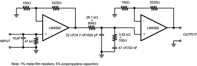

Could someone help me with a small modification of my RIAA, so I can evaluate this rumple solution?
I guess I will need a common resistor between channels and two capacitors between stages?
My RIAA is the LM4562 two stage with passive EQ in the middle.....

I have been wondering about this modification of my RIAA to test the effectiveness of this rumble cancellation.
On the each output I have a 1uF output capacitor (not shown on schematic) and if I interconnect the output side of these via a resistor (1-10k) in series with a switch, I will be able to deactivate the feature.
Will this Work or is there something I have overlooked? 🙂

Well, now its in test 🙂
I have made a selector, 1: Mono summing from 70Hz, 2:Mono summing from 160Hz and 3: Off.
There seems to be no difference between the 3 positions of the selector soundwise, but on records with much LF-rumble there is a clearly reduction of woofer cone movement. Best in 160Hz setting.
Now I will try to have a mono summing also from 320HZ 🙂
