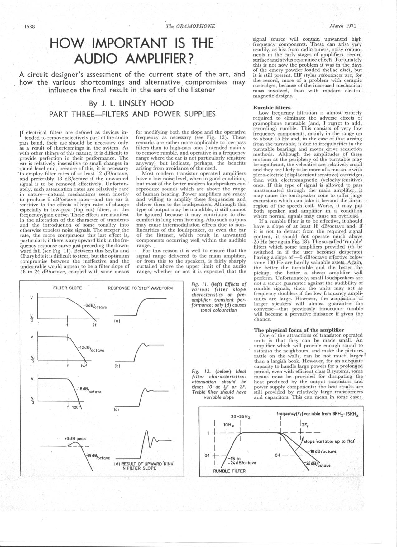

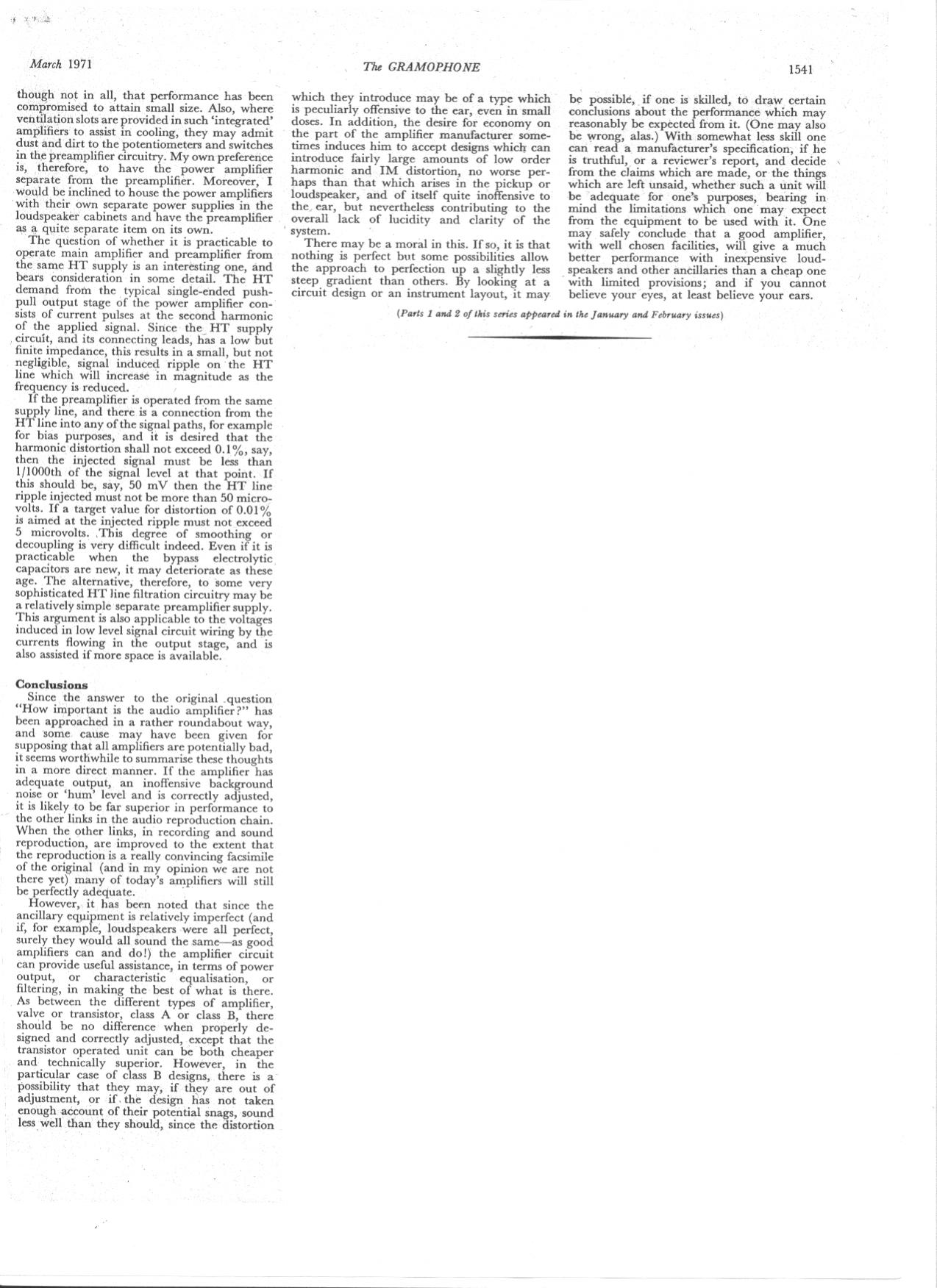

I've have found a JLH article, with a brief mention of rumble filters, attached (hopefully)
Thanks for providing that- I'd not see it before.
Unfortunately it gives very little info, and ignores the anti-phase signals due to vertical motion, which is what this thread is largely about.
