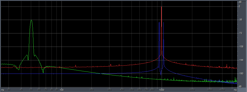

The modulation technique is very straight forward. For the source track, an identical length track is generated of test signal. The corresponding samples of source track and test signal track are multiplied resulting in processed track. When samples are all treated as normalized values the range is -1 to 1, thus all multiplications result in values -1 to 1.
Here is spectrum overlays of 50Hz at -36dBFS, 1kHz at 0dBFS, and result of modulation of the two frequencies by sample multiplication:
The modulation is 100%, none of the 50Hz and 1kHz signals remain. The spectral peaks are about -42dB and the waveform has peaks of -36dBFS, which is direct result of multiplication process.
Since side band formation is universal to phonograph systems, the process of sample multiplication appears to be an approximate model for the underlying principle allowing production of audible artifacts do to the presence of low frequency signals and of low frequency noise.

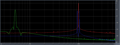

The 50Hz was used at post #746 as a form of LF example.
In this example the modulation tried is AM
As for the question on the type of modulation used on the three linked files of post #714, me too was interested to know.
Investigating the files, I can say that files 1 and 2 are the result of AM modulation.
I have doubts for the type of modulation on file 3 (modulated noise)
