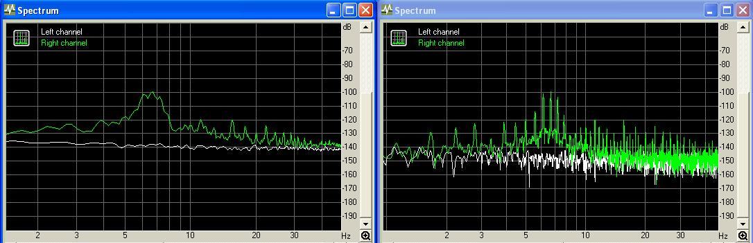

Yes Pano, I agree.
I attach two FFTs (different frequency resolution,) from the same recording. Green trace is the unamplified, nonequalized output of an Audio Technica AT110E reading a test groove. (0dB=1.286Vrms)
My past observations make me say that at ~10Hz the signal coming out from the cartridge is an equivalent to a modulation of 1.5 to 3 cm/s.
This is the result of signal amplification by ~12db due to arm/cartridge resonance.
The actual vinyl content at subsonic frequencies is an equivalent of a 0.2-0.4 cm/s miniscule modulation velocity.
The VLF doesn't amplitude modulate programme material.

Good way to look at it, George.My past observations make me say that at ~10Hz the signal coming out from the cartridge is an equivalent to a modulation of 1.5 to 3 cm/s.
