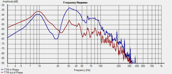

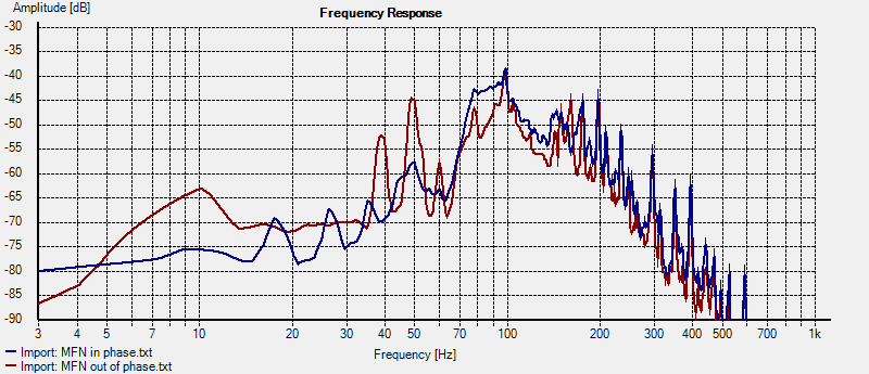

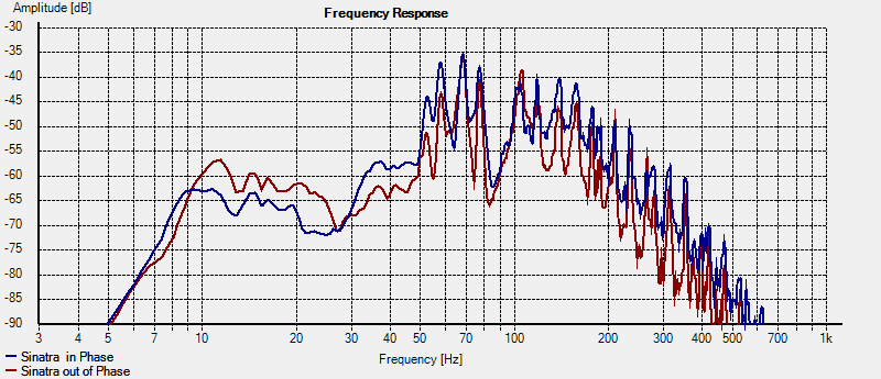

No worries Bill, here is some new stuff.
Below we see the <200 Hz spectrum of three different vinyl recordings from 3 different systems.
There is Dark Side of the Moon, Brothers in Arms and a stereo Sinatra.
Blue shows the in-phase signal, Red shows the out of phase (left channel only)
The LF noise is different on all 3. The ratio of in and out of phase is similar on 2 recordings, not on the other.
This is of interest to know just how much out of phase noise there is down low compared to the in phase (mono) noise. Gives an idea of what would be removed of in a De-Vinylizer.

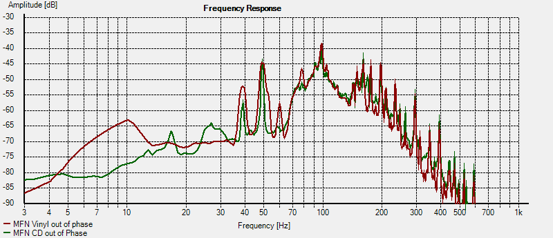

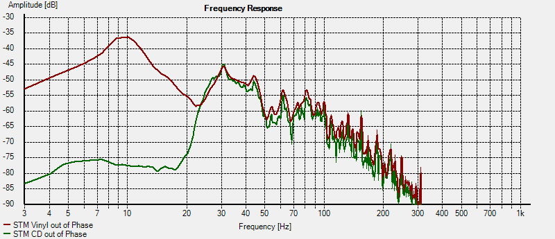

I've done the work for you.
That is the 1st track "Speak to Me". Below you'll find Out of Phase noise from Vinyl vs CD
There is much more VLF noise off vinyl, but in phase and out of phase on what I have looked at. In fact, it looks like some, or maybe many CD masters have a HP filter circa 20Hz.
You're welcome.
Yes, but it looks like some of that is noise. As for the rest, what is legit signal and what is nose? It would take some digging to find out.
To me, it's beginning to look like all you need is a 3rd order HP filter at 20Hz to de-vinylize your records. 4th order is too steep. Do that and the low end of Vinyl and CD look a lot alike.

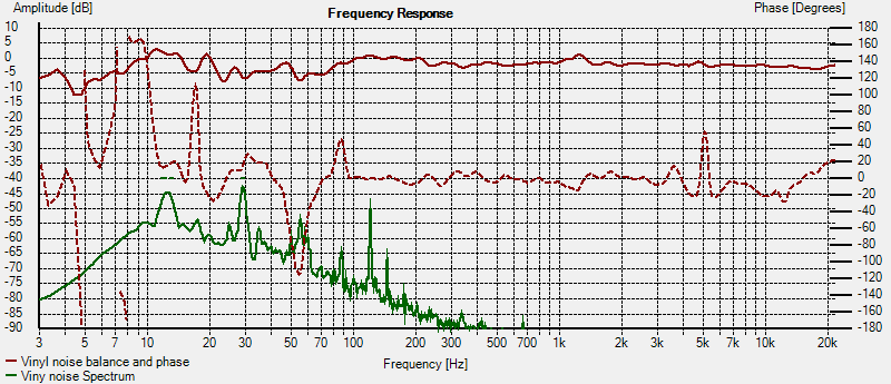

Here is another way of looking at it. The graph below shows balance, phase and spectrum of a silent groove from a 1960s era test LP.
Solid red is balance, where you can see some significant errors, dashed red is phase difference between the channels. 1/6th octave smoothing for both.
Green is the noise spectrum of the system; silent groove, Stanton cart, Grado wooden tone arm, Rek-o-Kut Rondine Jr, cable hum, etc. Value not absolute. No smoothing.
It's what you might call Vinyl Noise.
