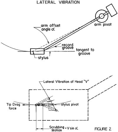

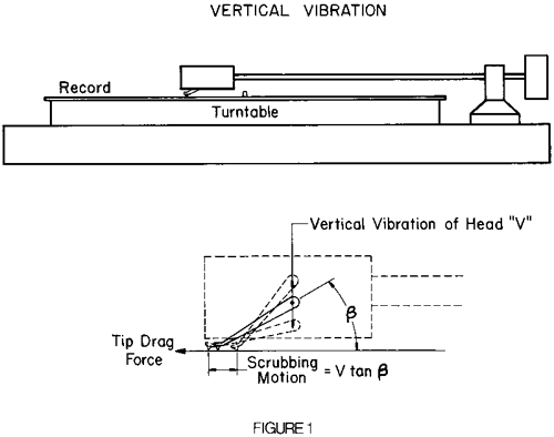

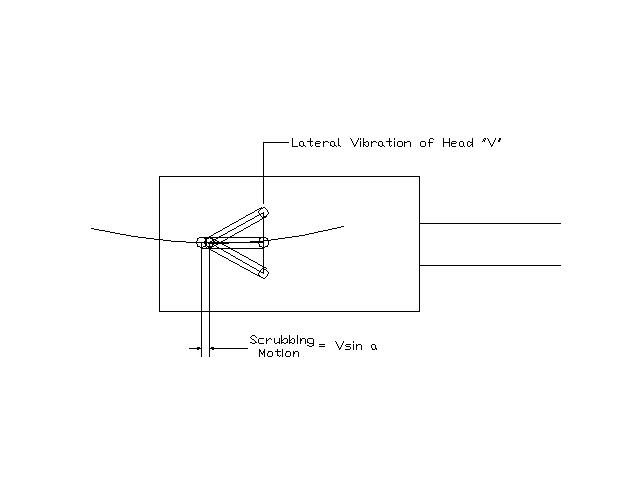

Stylus ‘scrubbing’ translates into FM differently in the vertical and lateral planes. In the vertical plane, it is mainly dependent on the vertical tracking angle. In the horizontal plane, it is very much dependent on the arm’s offset angle. Less offset angle = less scrubbing.

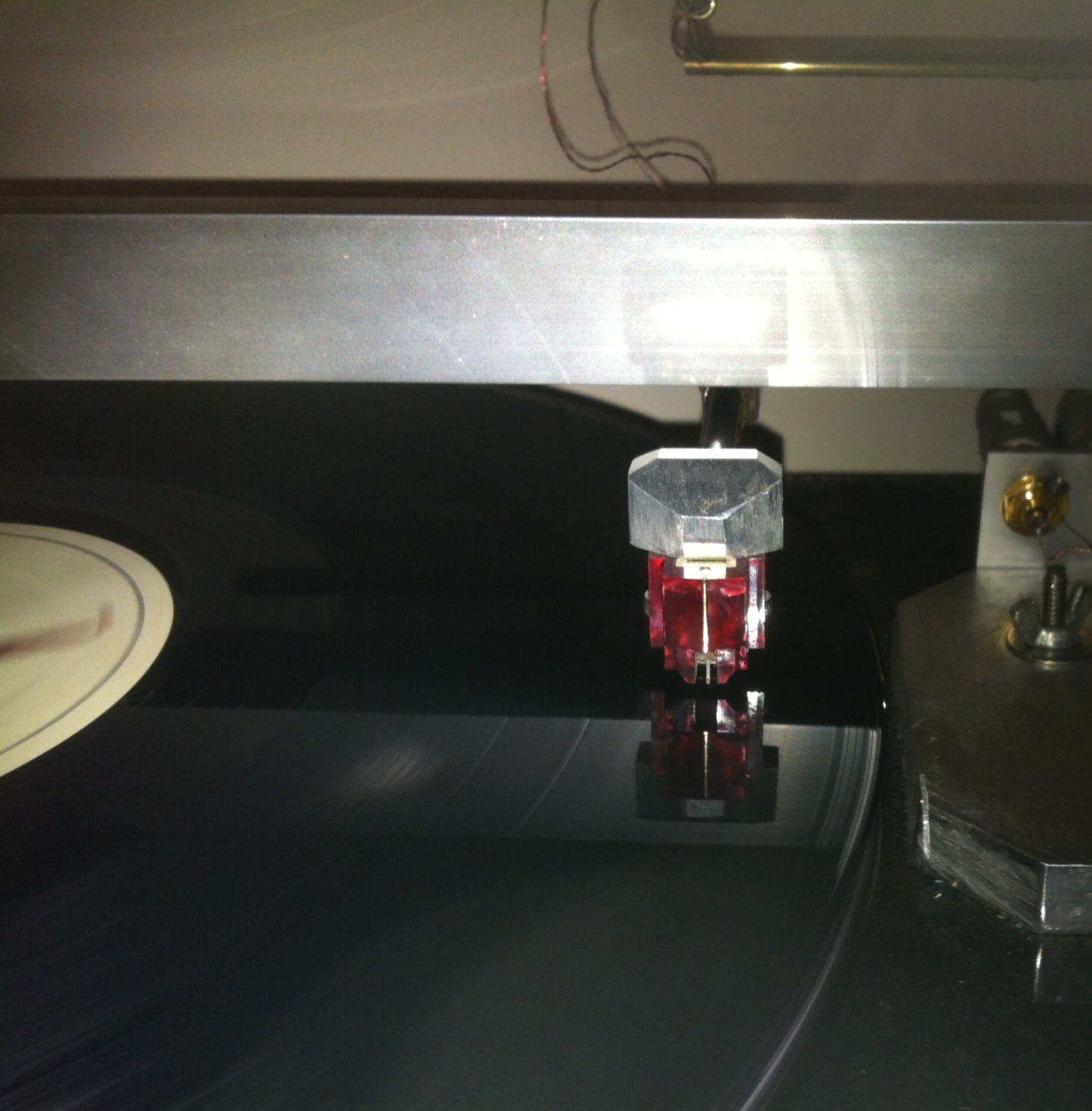

Or scrubbing/fm distortion can be almost entirely mitigated by no offset angle linear tracing. The difference is not only measurable but night and day audible. And not those dreadful servoed arms, of course. The first way to minimize a lot of these distortions is flat vinyl, and tracing it in the same manner and tangent of which it was cut. Before that happens there is no tool that can fix and error at the source without IMHO wreaking another problem into the equation.
