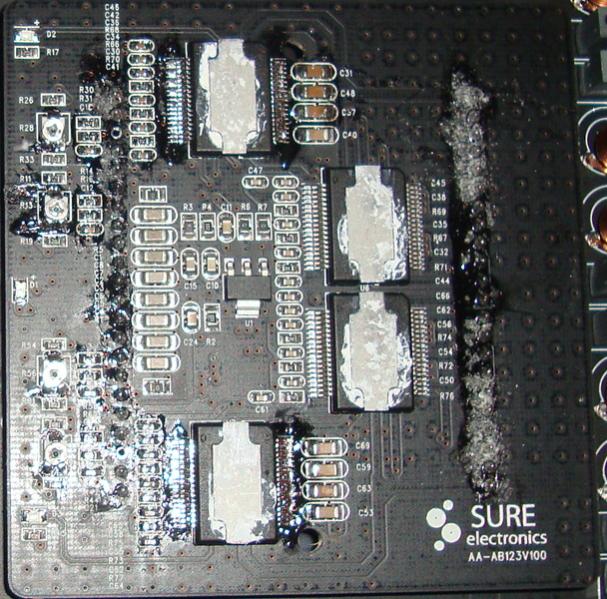

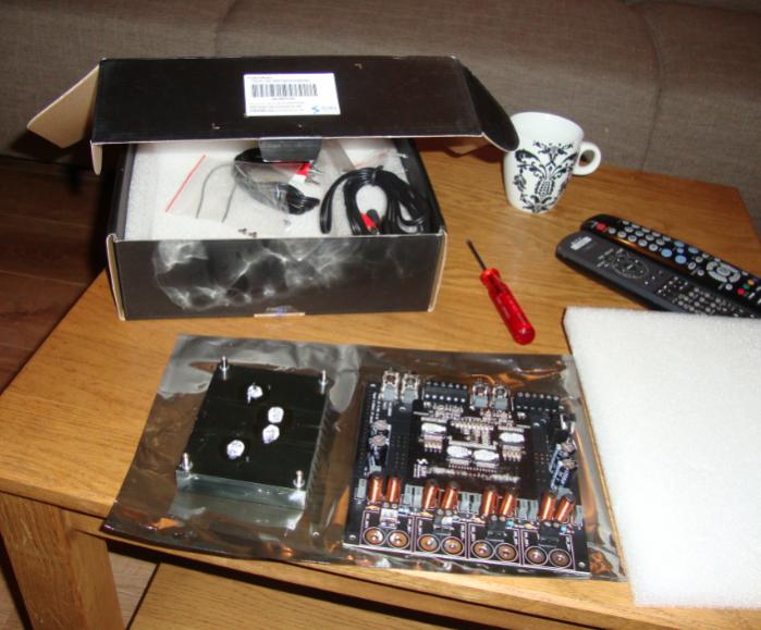

I have received my sure amp. Here a first look, nice packet in blackbox.
attachment.php

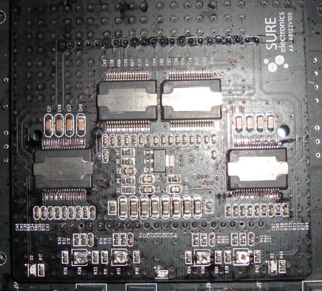

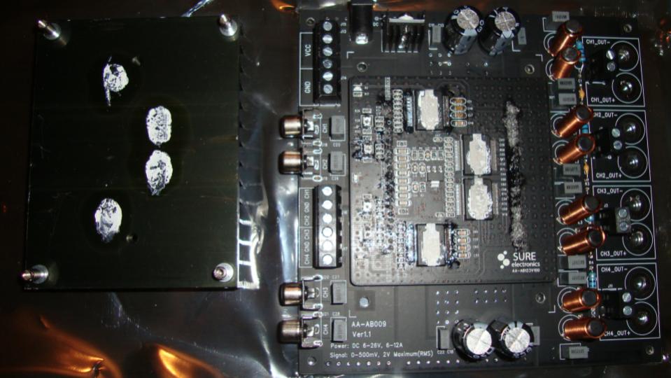

I was warned to check the cooling so I unmounted the heatsink. It looks like a repaired board to me. Can be just as good by the way.
First of all I have to clean the flux. Check the connection under the microscope and place silpath to ensure cooling.
attachment.php
