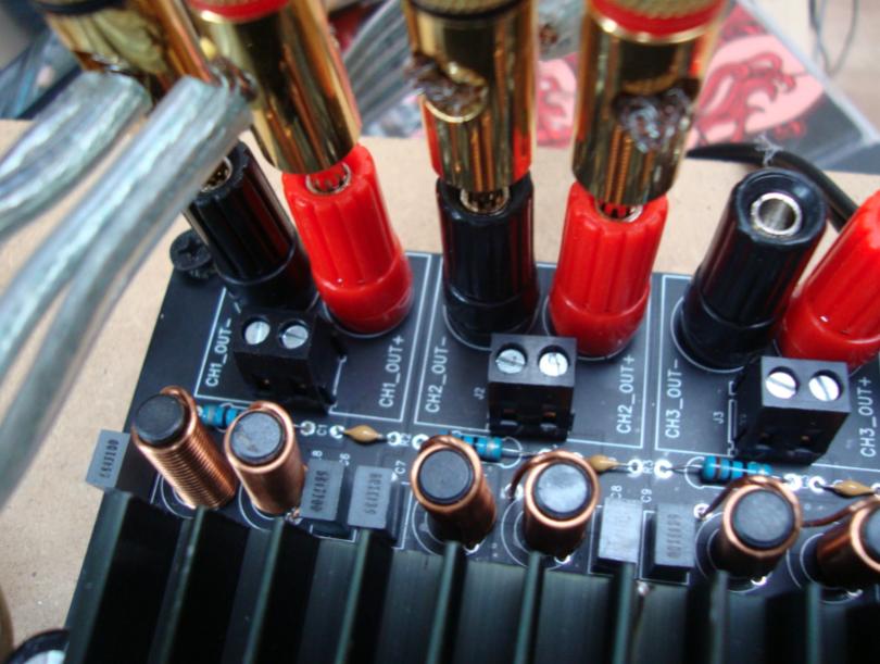

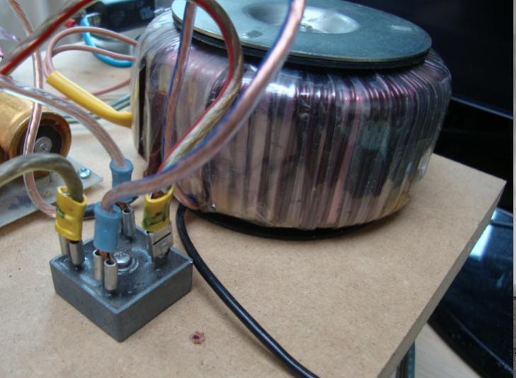

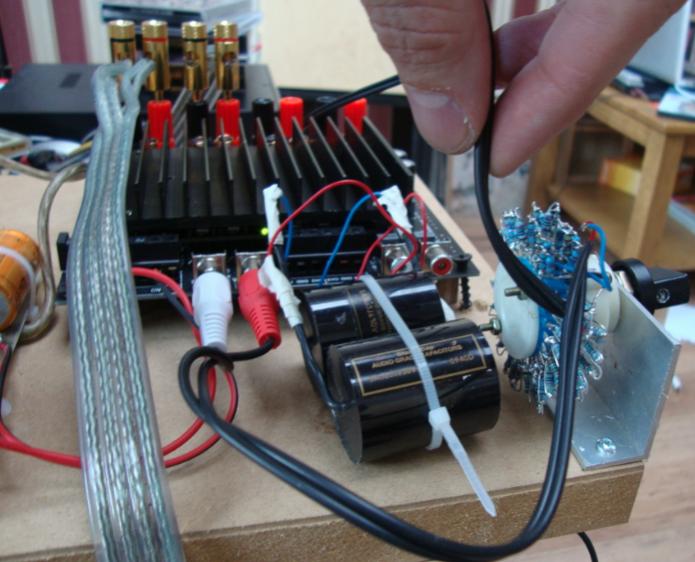

After some improvements concerning cooling on the Sure design because the original way of mounting is very sensitive to failure. All chips have to be mounted flat at the same hight and the heatsink has to be placed flat to ensure cooling.
It is a faulty construction. I use Bergquist Sil-Pad Products ~ Thermal Materials, Thermal Solutions ~ The Bergquist CompanySilpad to transfer heat to the heatsink. It is soft and 1mm thick to fill any uneven surface.

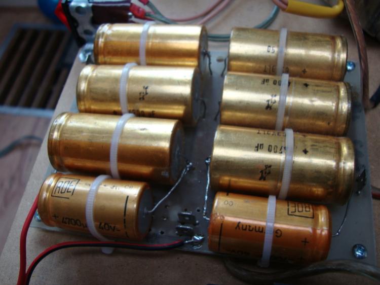

Donor for the project is my first build end stage from the mid 80's. It survived many crashes and experiments. Man was I nerves when buying that toroidal transformer I had to save long to get to money together and was afraid I maybe choose the wrong type back then .
Test board 24step volume control 10Klog. 30000uF capasitors and Sure wiring and amp.
About the sound there is a difference between the UCD180 and the TK2050 the TK2050 sounds a bit more open then the UCD. And the TK2050 seems to accentuate the high detail.
I had read andrea's artikel2008 - Class D Amplifier comparasion test about class-d amp and the TK2050 sounded a bit metal like and I can't help also to describe it that way guitar strings get a bit metal string sound voices are bright. I personally like bright sound. So there for I prever the sure sound both amps perform very well but do have a differend sound what HF-range concerns.
When we look at the price four ucd modules cost 300euro and the Sure amp witch I for now prefer sound wise only 41 euro. And the sure also has a heatsink that we have to buy for the UCD. So same class performance both amps perform good and the sure for 1/7 of the price of UCD. Hypex has to do something about the price IMO.

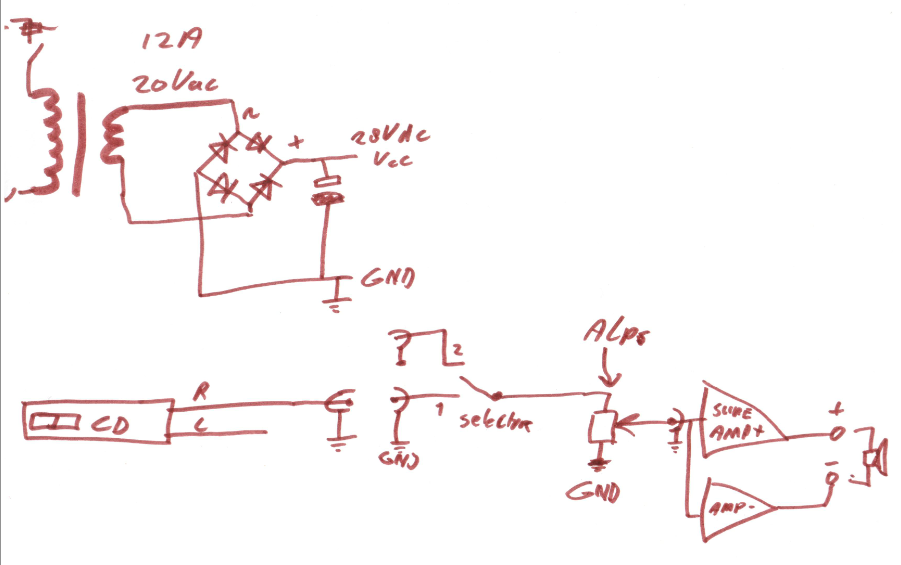

This looks like it would be good for my daughter, any chance of a quick schematic for a knuckle head electronics beginner

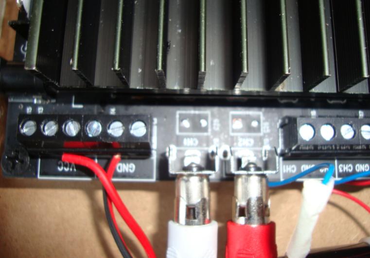

Hi david,
This board contains four 100W amplifiers you can parallel inputs make stereo left 100+100 and right 100+100.
Or use it as a surround amplifier. 4X100W then you need a quad potentiometer not stereo. This one is with motor
you need a 6 step input selector that would be the cable I have in my fingers. The wiper of that one is connected to the 10kOhm logarithmic potentiometer ( I would buy a alps).
Then the wiper of the potentiometer is connected to the input cinch of the sure board.
The sure board has a VCC = +28V and a GND = 0V gnd. There for you need a transformer with 20V ac output 12A. And use 3x 10000uF 40V capacitors or 6X 4700uf 40V. And a rectifier bridge 25A.
Grey Srew terminals are the loudspeaker outputs. Sure kit also contains banana terminals black and red witch I use on the photo.

Thank you, I'll draw something up

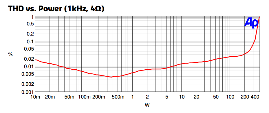

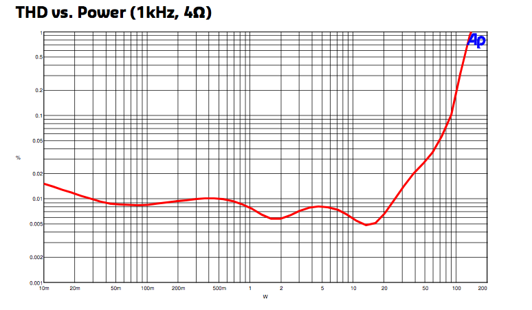

I agree that the Hypex modules are overpriced, but I'm not impressed at all by the specs of the Tripath. The TK2050 can't be compared with even the UcD180ST because it's a much lower output device for hi-fi low distortion applications. The output power of the Tripath isn't even close to the UcD180ST unless you're willing to listen to distortion levels over 1% and up. That's not acceptable for me.
I'm not saying that the Tripath isn't a good deal, it absolutely is. But I beg to differ that you can do a fair price comparison beteen Hypex and Tripath when the output power of the amps is so far apart. The power rating of the Tripath is at an unacceptably high THD to make any price comparisons. If you don't believe me then believe the chip specs:
TK2050 Datasheet pdf - Stereo 50W Amplifier Chipset - Tripath
Again, I'm not knocking the Tripath. I may buy one for a second system, but the TK2050 isn't going to be my main amp because I need more power than it can provide at an acceptable level of distortion.
You have to read the specs closely 1% isn't true.
The tripad is even performing better. 0,005% THD at 72W. So I see it this way a perfect performing amp up to 75W.
See here the ucd180 0,055% thd at 72W 13dB more THD as the tripad.
And I think most of the time we are listening to a output power below 1W! With a 90dB/1w speakers we hear 90dB on 1 mtr that is pretty loud.
And 180W is only 4dB more than 72W. And 1 dB you can hardly tell the difference at 4 dB you hear the difference it is peanuts. We shout talk about SPL power isn't on level with our perception of loudness.

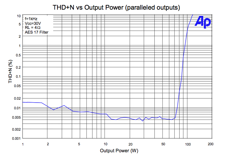

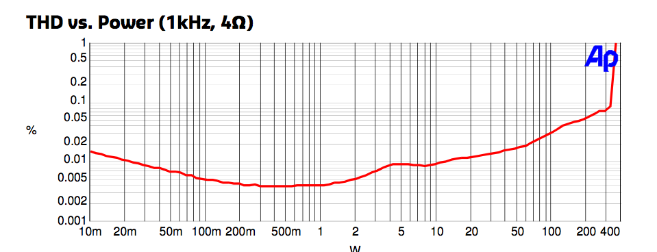

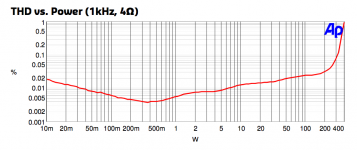

At 100 watts (the power claimed for the Tripath), the THD is 0.2% for the Hypex, but 2% for the Tripath, TEN times higher in the Tripath. The Hypex only has 1% THD at full power of 180 watts but the Tripath is seriously clipping with +10% (off the scale) THD if it can even output that much power.
I do agree that most listening is done at only a few watts, but with my inefficient speakers and large room I need the extra power (and more).
If your PEAK power levels stay under 70 watts the Tripath is probably the best value you can get in an amp. But after 70 watts the rise in distortion is very rapid in the Tripath.
What's interesting is that the Hypex starts its disortion rise at a lower power level than the Tripath but the rise isn't as sharp. The Hypex distortion curve looks more like a tube amp, the Tripath looks like it clips abruptly at 100 watts. Keep the peaks under 70-100 watts and the Tripath is most certainly more bang for the buck with specs that rival the Hypex (and exceed the Hypex if you cherry pick your wattage).
You've talked me into trying a Tripath!
One question however. The THD curve you posted says "parallel outputs". Does the board use parallel outputs on each of the 4 channels? The specs on the board from the largest ebay sellers indicate much higher distortion levels than the curve you posted.
There is one other very big difference in the two amps. The frequency response is flatter on the Hypex. 20-20kHz +/-3dB is the spec I'm seeing for this board on ebay. That's 6dB of variation across the spectrum - double the power at midband than the extremes of the audio band. I can find no information on the datasheet regarding frequency response.
The sure board has 4 tk2050 chips and two tc2000 pre-stage. Every TK2050 chip contains a 2X50W amp or a mono 100W.

The hypex ucd400 is better at high levels.
ST
HG
