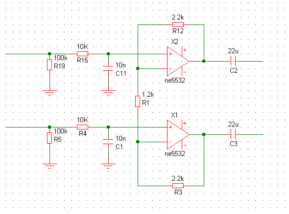

I use a 100k pot for the UCD and removed the 100K resistor, and for safety placed a 10M over the input of the op-amp to prevent a open input when the pot makes bad contact
Removed the 100k resisitor? I assume this is a SMD resistor on the bottom of the board.
Where in the signal path is the resistor (in series with the input or shunting the input to ground) and why did you remove it?
I want this to work as well as possible and am interested in any mods that will help. Please be as technical as possible. I'm an EE and I understand tech speak. I assume the 10M "over the input" is connected from the pot wiper to ground? I usually put a 1M from pot wipers to ground on any pot on the input to an amp for the exact reason you describe. When using a pot as the FB resistor in an op-amp circuit I ALWAYS connect the wiper to one side of the pot to limit the gain in case of bad contact.
Input circuit UCD180.Removed the 100k resisitor? I assume this is a SMD resistor on the bottom of the board.
Input circuit UCD180.[/QUOTE
Removing the 100k resistor provides no real advantage. There is a small deviation from the pots unloaded rotation vs attenuation curve. Not really a problem, but rather a small improvement to the pseudo-log character. However, if the opamp has bipolar inputs, a 10M resistor will not help against temporary contact loss of the wiper. As far as I know, the FET-version is not available anymore, so you do have bipolars.
Is there a decimal point in front of the cap value? Seems to me it should be 100 pF.
The datasheet for the NE5532 indicates an input impedance of 30K - 300K. That's quite a range!
Assuming the input impedance of the op-amp inputs is 30K, the actual input impedance would be (30K+10K)ll100K= 29K
Assuming it's 300K it would be (300K+10K)ll100K= 76K
So depending on the op-amp that you happen to get the input impedance will range between 29K and 76K, not 100K
With the 100K resistor removed the numbers become 30K+10K=40K and 300K+10K=310K
It appears to me that removing the 100K resistor can help if the op-amp has a high input impedance. If you get "stuck" with a low impedance op-amp the input impedance becomes 40K without the 100K shunt, but if you get a "good" op-amp it's 310K without the 100K shunt.
To summarize that's 76K with the resistor vs. 310K without assuming a 300K input op-amp. It's 29K vs. 40K assuming a 30K input impedance on the op-amp.
Any dissention? I did this rather quickly - might have made mistakes.

The impedance of the opamp is in M-Ohms when connected this way. So You can assume the pot isn"t influenced by the load of the non-inverting input.The datasheet for the NE5532 indicates an input impedance of 30K - 300K. That's quite a range!

But I use a 10M load to prevent a open input at bad contact. Parallel to pot-meter wiper or how do you call it.
And R1 is 330 Ohm to increase amplification about 14X same as 23dB.
thus R19 is now 10M. R5 is a jumper so we have a asymmetric input.
The ne5532 is now LME49720 in my amp.http://www.national.com/ds/LM/LME49720.pdf
In case of non contact to pot-meter and only 10M on input then the bais current typical 10nA through 10M will cause a voltage of 0,1V.
0.1V X 14=1,4VDC a ofset of 1,4Vdc in my case.
With the amplification of the original version 6X it is a ofset of 0,6Vdc with the LME49720.
With the bias current of the NE5532 this will fail to work because it is 200nA typical.
The value 10nF is wrong it was probably the value my schematic program automatically gives the cap. It will be around 100pf like javin posted so the HF-surpression on the input has a cutoff at 150kHz.
Out of curiousity, how much difference do you measure between the two parts? Data I've seen suggests there's not much for well behaved loads such as the UcD180 input.The NE5532 is now LME49720 in my amp.
Not if the op-amp has bipolar inputs and not FET inputs (in general).
Check the specs. The input current shoud be in picoamps, not nanoamps. The input impedance and input current are listed in the specifications for all op-amps. The difference in the input impedance and the bias currents are several orders of magnitude apart between bipolar and FET input op-amps (again in general).
I build a lot of non-inverting preamps using FET input op-amps and when you're directly connected to the positive input the input impedance is on the order of tens of megohms. With bipolar input op-amps like this one it's more like 30K-300K per the specifications.

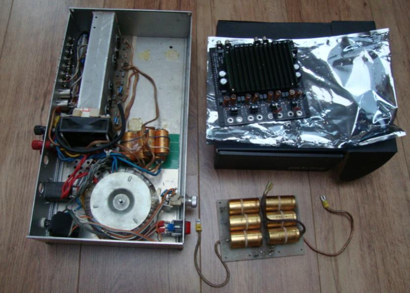

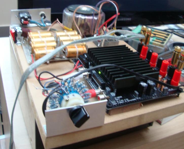

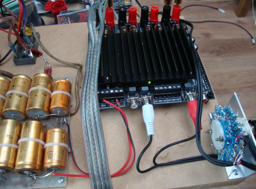

I hope StigEric it doesn't bother I am writing about the tripad amp in this topic.
After some improvements concerning cooling on the Sure design because the original way of mounting is very sensitive to failure. All chips have to be mounted flat at the same hight and the heatsink has to be placed flat to ensure cooling.
It is a faulty construction. I use Bergquist Sil-Pad Products ~ Thermal Materials, Thermal Solutions ~ The Bergquist CompanySilpad to transfer heat to the heatsink. It is soft and 1mm thick to fill any uneven surface.
Donor for the project is my first build end stage from the mid 80's. It survived many crashes and experiments. Man was I nerves when buying that toroidal transformer I had to save long to get to money together and was afraid I maybe choose the wrong type back then .
Test board 24step volume control 10Klog. 30000uF capasitors and Sure wiring and amp.
About the sound there is a difference between the UCD180 and the TK2050 the TK2050 sounds a bit more open then the UCD. And the TK2050 seems to accentuate the high detail.
I had read andrea's artikel2008 - Class D Amplifier comparasion test about class-d amp and the TK2050 sounded a bit metal like and I can't help also to describe it that way guitar strings get a bit metal string sound voices are bright. I personally like bright sound. So there for I prever the sure sound both amps perform very well but do have a differend sound what HF-range concerns.
When we look at the price four ucd modules cost 300euro and the Sure amp witch I for now prefer sound wise only 41 euro. And the sure also has a heatsink that we have to buy for the UCD. So same class performance both amps perform good and the sure for 1/7 of the price of UCD. Hypex has to do something about the price IMO.
