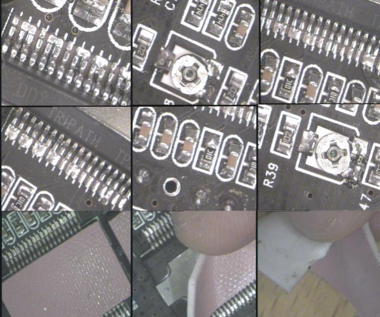

Here closeups of the soldering quality and the silpad I used.
Just so I understand correctly before I buy one of these, if the silpad weren't put between the chips and the heatsink, what is the failure mode of the board? Does it shut down on high temperature or does it burn up?
Failure
I haven't read about as many failures lately so they must have fine tuned the placement of the heat sink. When they fail, they burn the output chips. The 4X100 thread has been quiet. Just eyeball to make sure the daughter board looks like it is flat against the heatsink. Not warped.
Silpad weren't there I put them there and also Sure shout do that IMO.
The chips have a thermal protection but there are here on the forum who had failure.
That is because every thing has to placed perfect the power chips al shout have the same height and the heat-sink has to fit flat on four chips.
Not a very safe construction this way.
It looks like the solder is going across pins, should it be like that?
What did you clean the flux off with?

YesIt looks like the solder is going across pins, should it be like that?
ThinnerWhat did you clean the flux off with?
Thinner
You can use spirit / ethyl alcohol instead of thinner too - works like a charm and is better for your health - using an old tooth brush is a good idea too.
Spirit does not dry up as fast as thinner or special cleaning fluid so I use kitchen paper to help with these.

Use a tissue to absorb the fluid and flux because only brushing wont help.Thanks guy's
No water
I don't like to clean flux with alcohol. It has too much water in it and isn't hot enough to clean well anyays. If you leave any moisture under a chip in a via it will eventually corrode open.
