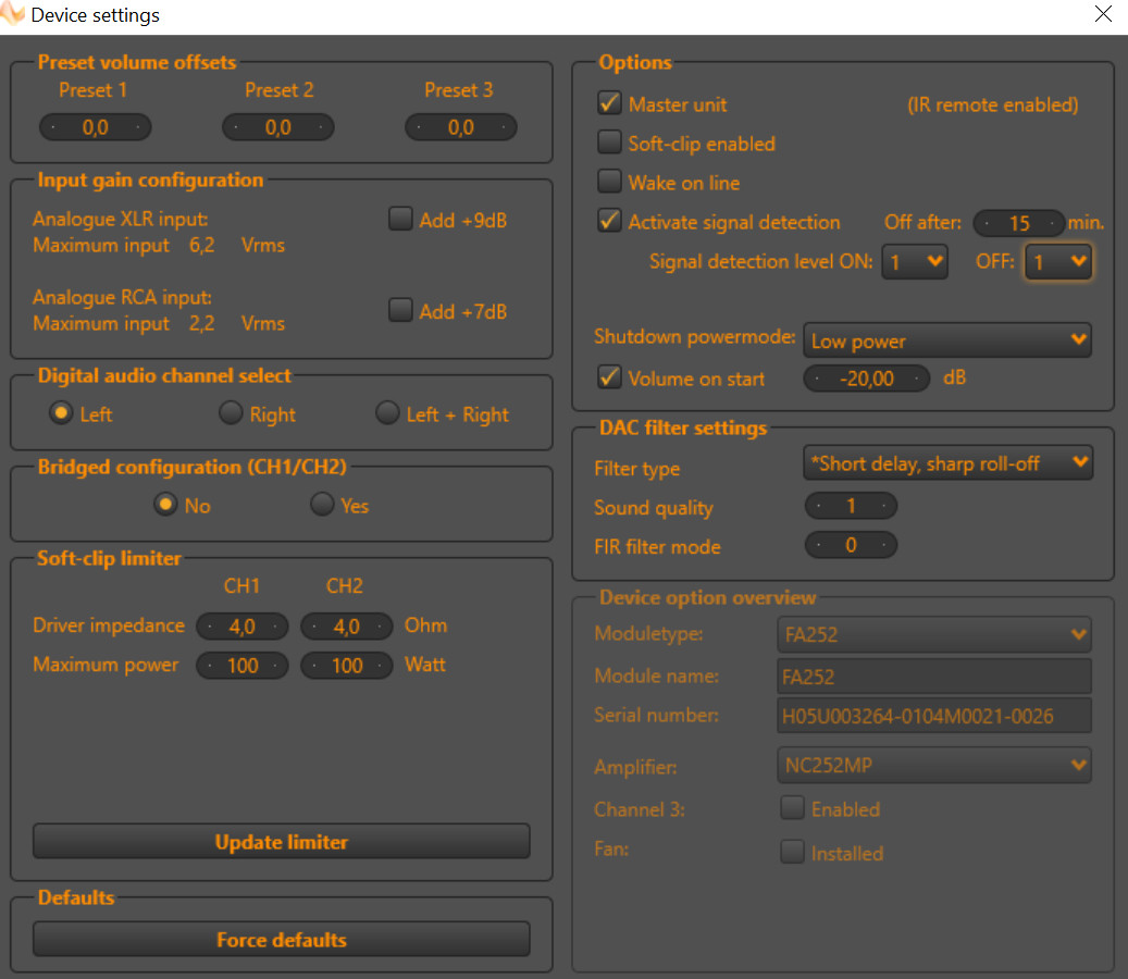

another one is that despite what I select as option in HFD, Amps are going to mute state after a while.
I would appreciate any help on that one !

Auto off in the device settings panel?

Here is a screen shot on one of my amps (FA252)
I don't see any option to turn Auto Off, I can select Off after xx min. but even if I select 30 minutes for example, the plates mutes after a few minutes without signal
Uncheck the signal activation box
Ok thanks, I'll try that one but it does not explain why the mute is engaged after a couple of minutes (without signal) whatever the value I choose for the time to go off
