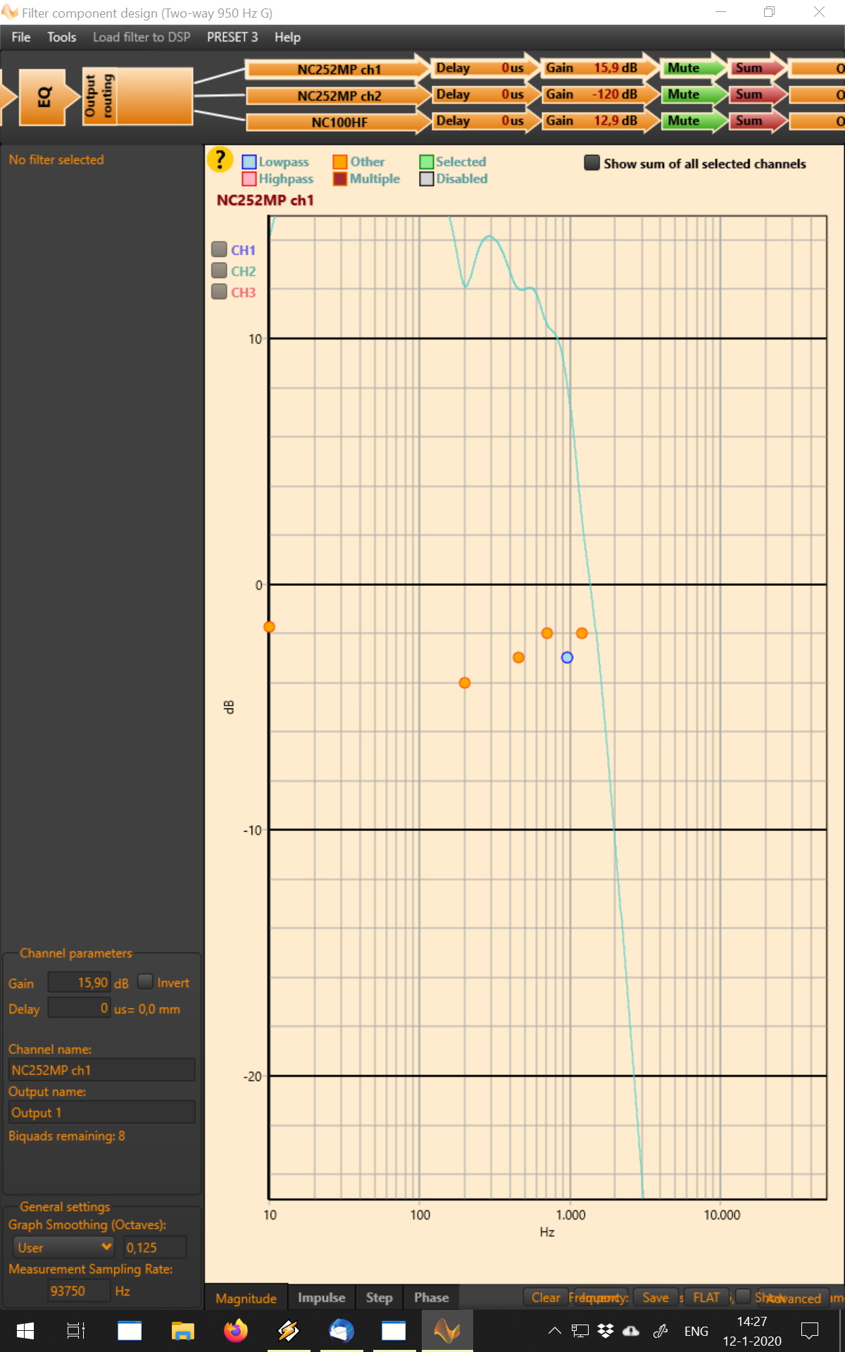

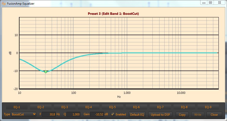

I just put this filter in my Fusion and nothing strange happens.
Would it be possible to add a fourth preset to Fusion? The remote control already has the button...
Would it be possible that someone from Hypex.nl please contact Kimmo from VituixCAD so that the crossover simulation can finally provide reliable results for the FusionAmp DSP.
