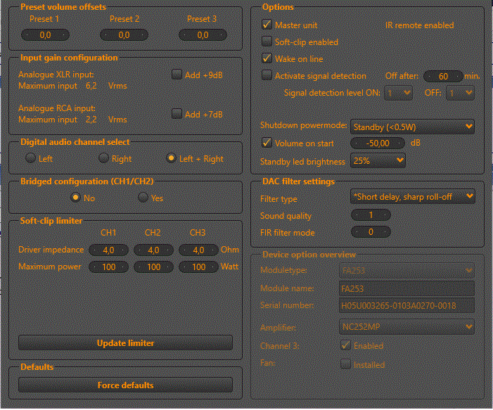

Hi, I bought fa252, force default sets maximum power 100 watt instead of 252watt. What is wrong?

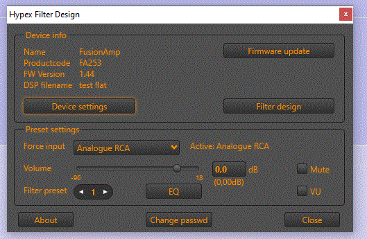

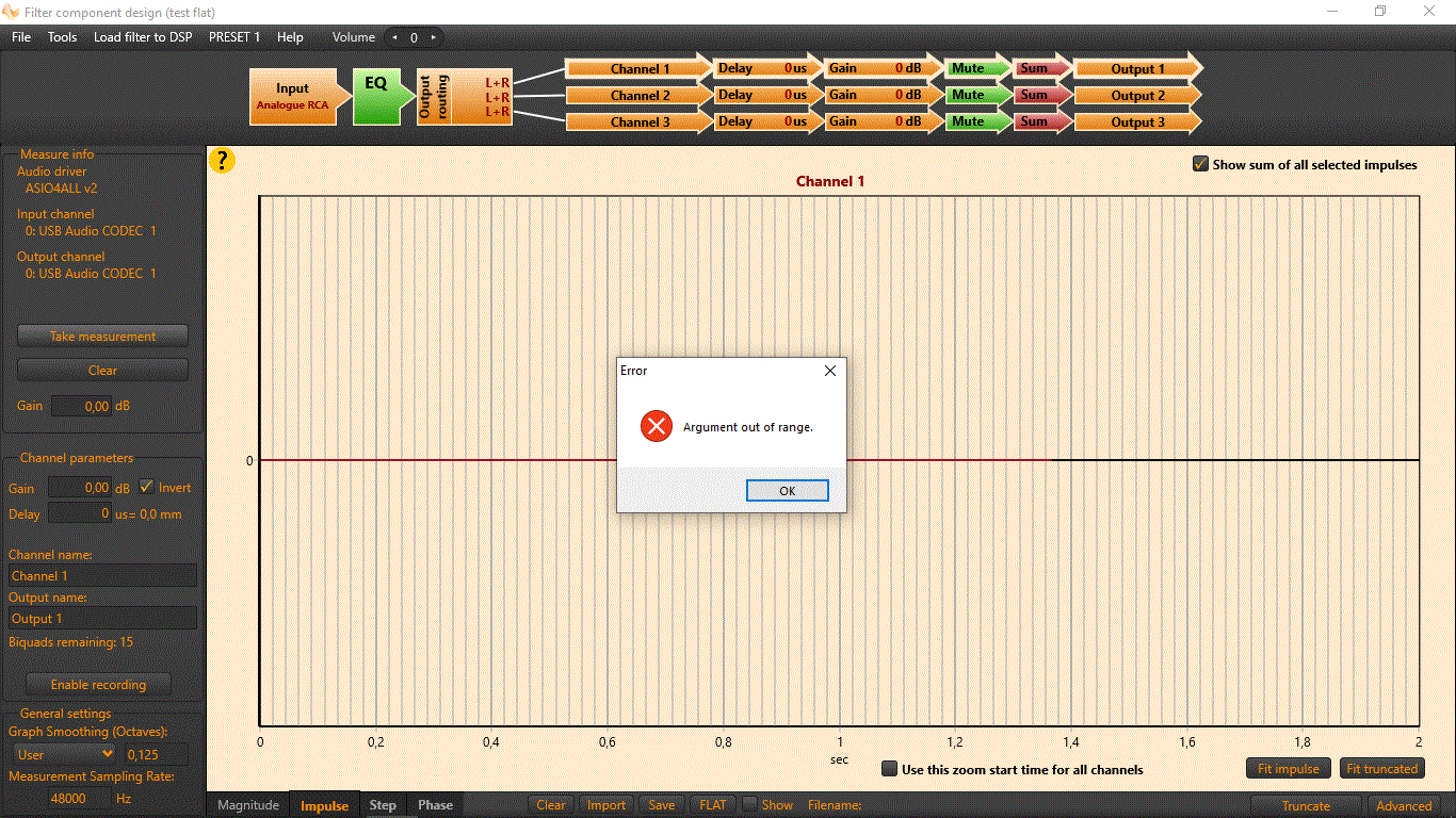

Problem with HFD
so now i have found that the combination of HFD, asio4all and Behringer UMC22 and my laptop do not work together.
So I switched to the Behringer UMC202HD with the associated asio driver.
What happened? No matter which output I selected, I only got an output signal on channel 1.
So I switched to my second FA253, made measurements on channel 1 and saved 7 biquads.
Then measurements made on channel 2, 8 biquads saved.
After setting the 1st biquad in channel 3, Hfd switched from RCA input to XLR.
I turned it back
Then I tried to continue measuring on channel 3, from then on I only got measurements with the stored biquads from channel 2.
Even when I open a new project (channel 1, channel 2, channel 3) I only get results with the saved biquads from channel 2.
I can no longer use HFD like this
I know I could reset all the settings, reinstall HFD, but I've had so much trouble with HFD and all the time I've invested. . .
and if then all the trouble repeats itself
I'm getting really pissed off
Any idea ?

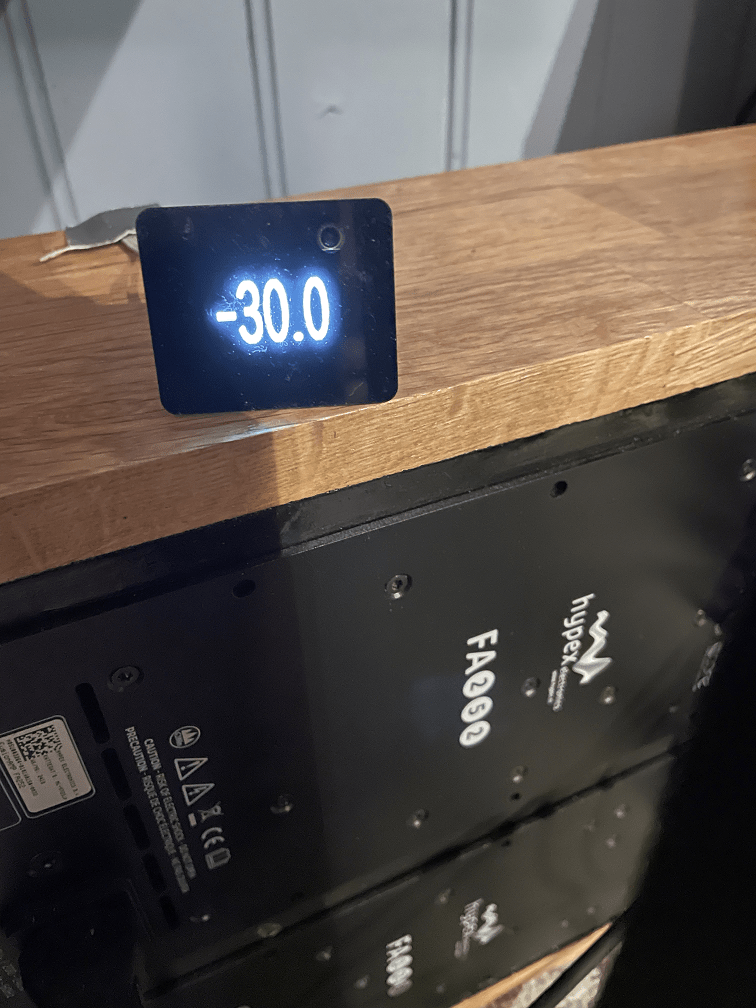

It took 4 years, but finally got a display on my FA amps ;-)I really need a volume display.
Would certainly appreciate some more details on that 👍 🙂It took 4 years, but finally got a display on my FA amps ;-)
For details go to the Hypex store. They have finally released a display for the FA amps. It works great.Would certainly appreciate some more details on that 👍 🙂
