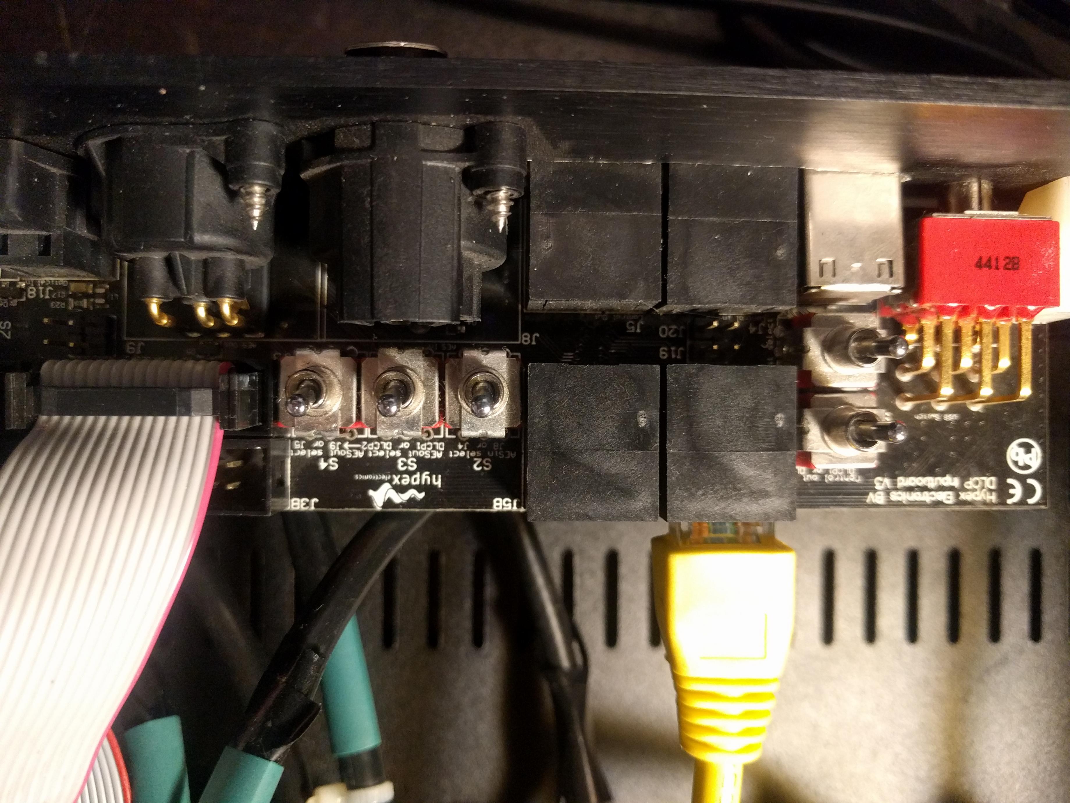

Thanks. I was trying to figure out how to reduce the dlcp instability I mentioned in post 1715. If I use an Analogue IN, dlcp is stable. I don't see the volume-does-not-change behaviour. The moment I use USB or spdif, I can see the issue within 5 mins to 2 hours. Ground loops are the first suspects.

switch positions
I am trying to see what's going wrong with the dlcp system.
I believe these switches are correctly set, based on instructions in the DLCP manual.
Was wondering if an additional pair of eyes could look at it.

My DLCP SMPS reads 15.7 V at positive aux terminal. Hypex suggests replacing with another DLCP SMS and see how things go.
I've been scratching my head on this.
