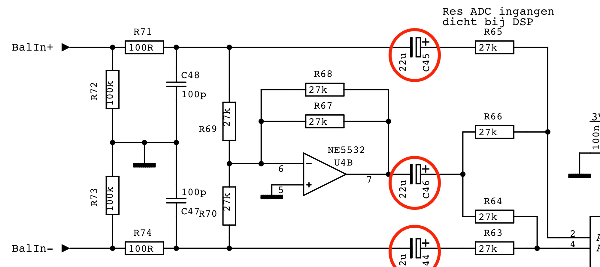

For the people who are still using it. The AES/EBU does not seem to be terminated. I added a 120 ohms resistor. Anyone had that experience as well?

I contacted Hypes regarding this issue. They told me that the AES input as well as the spdif input of the DLCP are properly terminated. There is no additional input circuit needed.For the people who are still using it. The AES/EBU does not seem to be terminated. I added a 120 ohms resistor. Anyone had that experience as well?
Best regards
Alex
