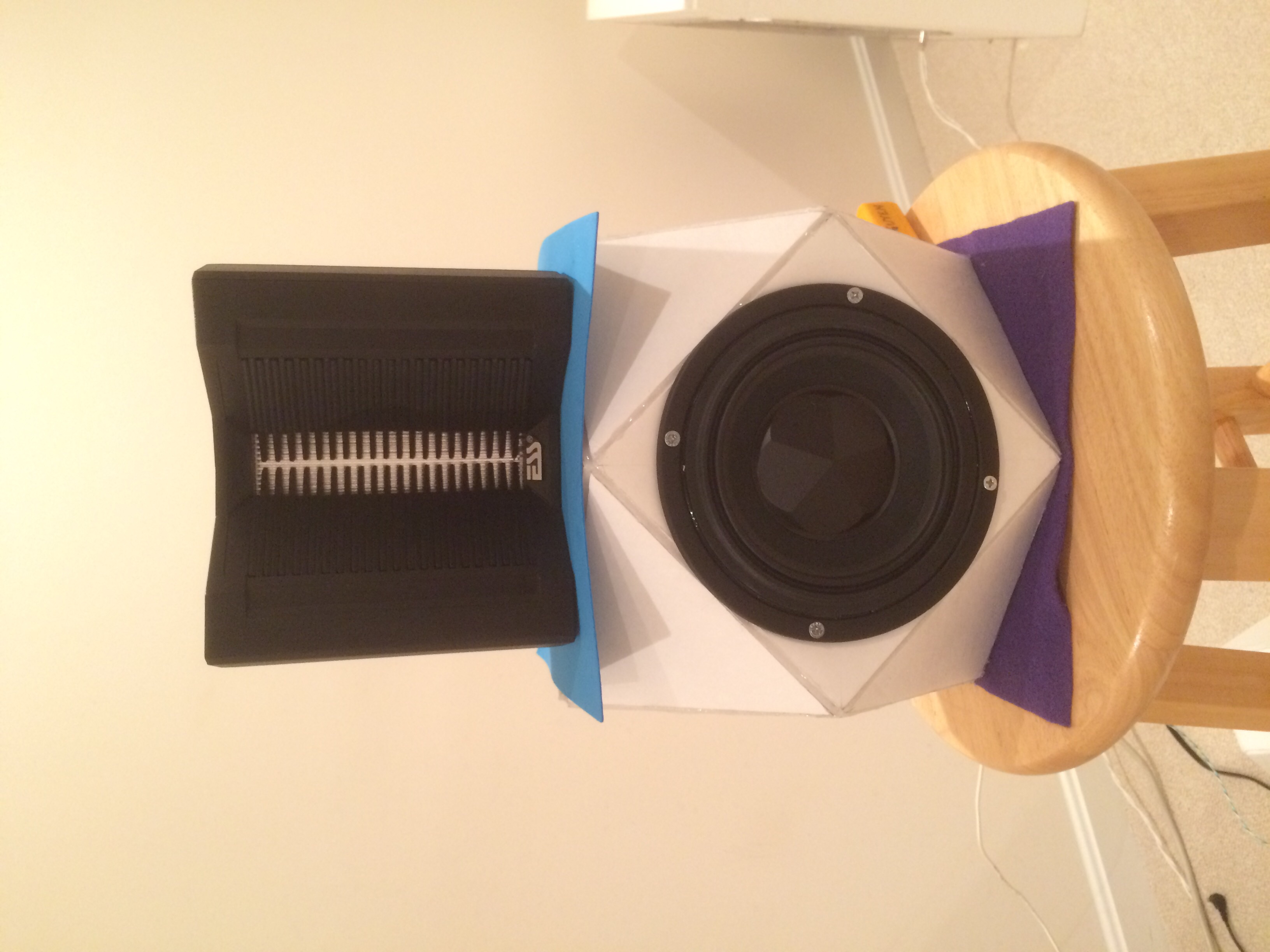

For those of you lucky enough to have heard an Oskar Heil AMT tweeter in person - you know what I am talking about. I was lucky enough to get an ESS AMT tweeter yesterday. So I quickly set it up for a measurement. I turned the amp gain way down, about -12dB from where I normally test drivers at to make sure I did not over drive it on first sound. Well, it was still very loud! I was surprised because the manufacturer specs say 92dB at 1 watt - a decent number but not mind blowing. I hooked up a DMM and set 1200Hz sine wave at 1.2v - about as loud as my ears could stand. The driver clocked in at 93dB at 1m and 1.2v. That translates to 100.5dB at 2.83v!! Yes it is a "4ohm" driver - I measures DCR at 4.5ohms and this thing is supposed flat like a resistor across impedance sweep (because it is a resistor - no reactive coil). So my ears were not deceiving me. It took about -13.5dB of gain cut to match the effective 85dB woofer so there is gobs of headroom left. Ok, getting over the pleasant surprise of the sensitivity one will be surprised that the driver is heavy - about 14lbs - lots of magnet going on there. Could that be part of sensitivity? The other cool thing is that the pleated membrane is clear and sits at the middle of a symmetric V horn that goes front and back. It truly is a dipole radiator from the beginning. In the photo you can see light coming through the membrane slot in the middle. The little combs you see are alternating iron plates that direct the magnetic field through the membrane. The pleated membrane has flat aluminum wires bonded to it that make the pleats squeeze air out when excited. The diaphragm or membrane area is 5x larger than the frontal cross section area. Thus, there is a 5x leverage of membrane motion to air displacement. The membrane is very light so doesn't have any inertia hardly. It doesn't move much so HD is very low. So those are the basics of the AMT drive technology for those not familiar.
The sweep produced an amazingly flat spectrum from about 750Hz to +20kHz with no breakup. I can see why people say this thing is easy to cross over. I picked 700Hz at -24dB/oct and set it on top of my 5in Tang Band Hypercube bass unit also crossed at 700Hz.
Here is a photo of the AMT on top of the bass Hypercube:
The XO spectrum is in the next post (my apologies for the phone photo of the screen - my wireless was down and I couldn't send the graphic like I normally do - and browser on iPhone can't post more than 1 image per posst).
It integrates very well and appears to be a great candidate for a 2-way HF unit. So how does it sound? Special speakers take your breath away when you hear them for the first time and this is one of those moments. The sound was clean and clear, very open, extremely fast and able to articulate transients and percussions extremely well. The single adjective that best describes it is "naturalness" - its is like the instrument or singer is right there. As the music playing, I picked up the AMT (each time still surprised how heavy a 14lb tweeter is), and I hold it in my hands and it is like Diana Krall or Anne Bisson was put in a shrinking machine and placed right into the aperture of the AMT and singing her lungs off! Instruments like high hats sound like I have never heard them before. It is the articulation transient ability. I will show more data later but the impulse response is as I expected - no ringing at all. Just 1 peak and 1 overshoot of equal magnitude. A non FIR perfect impulse response.
This is one of those speakers where you hear new things and don't want to stop listening. Truly a special driver.
