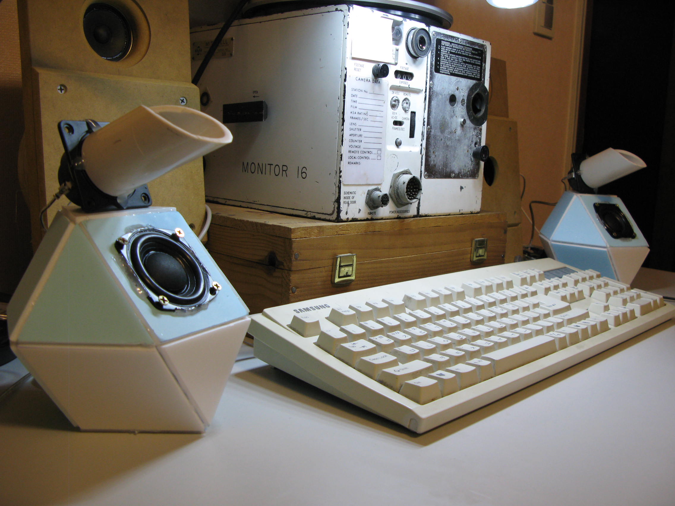

Here is another Hypercube-Karlson tube based 2 way by bolexbm:
http://www.diyaudio.com/forums/full-range/223313-foam-core-board-speaker-enclosures-254.html#post4150000
Looks nice!

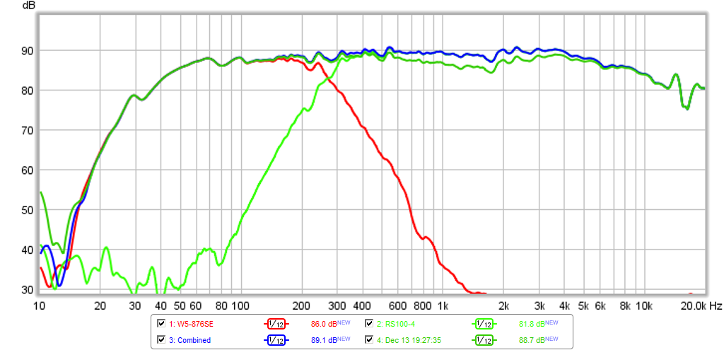

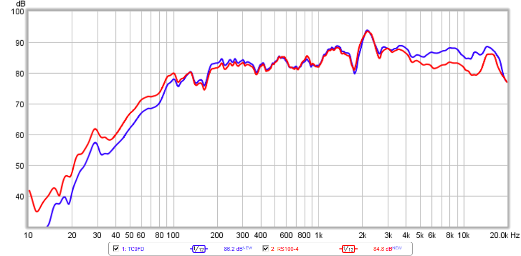

Here is an initial attempt at getting the Dayton RS100-4's in the HyperFAST. I am still using them with a -24dB/oct HPF at 300Hz but the woofer is now running at 260Hz rather than 240Hz with the TC9FD. I applied the same peak cuts to get rid of the Hypercube induced resonances but also added a high shelf boost as the RS100 seems to have a bit less sensitivity in the higher octaves than the TC9FD. Here is the comparison of the TC9FD and RS100-4 in the same Hypercube with same drive voltage and mic at identical positions:
As you can see, the two drivers have very similar behavior in a Hypercube.

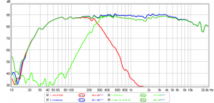

Here is the XO response plot measured 8in away at a height in between the two drivers, thus the HF will be reduced since it off axis vertically, green and blue is difference with a mild boost at 1.4kHz to flatten out the depression - sounds about the same so I prefer to leave it out:

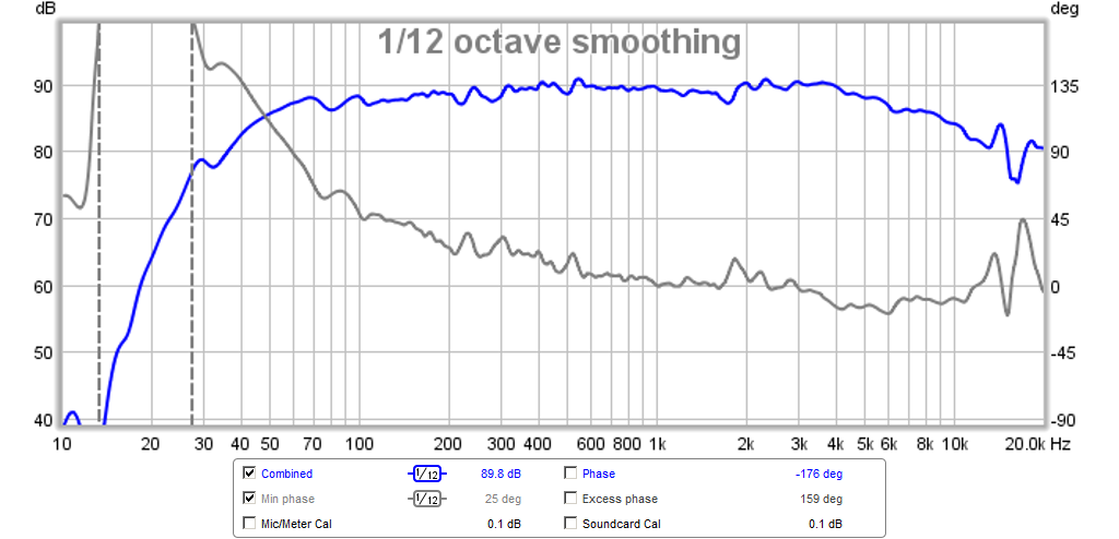

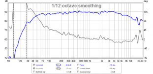

Here is the minimum phase - 45 deg major increments (pretty good):

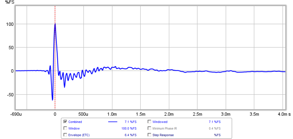

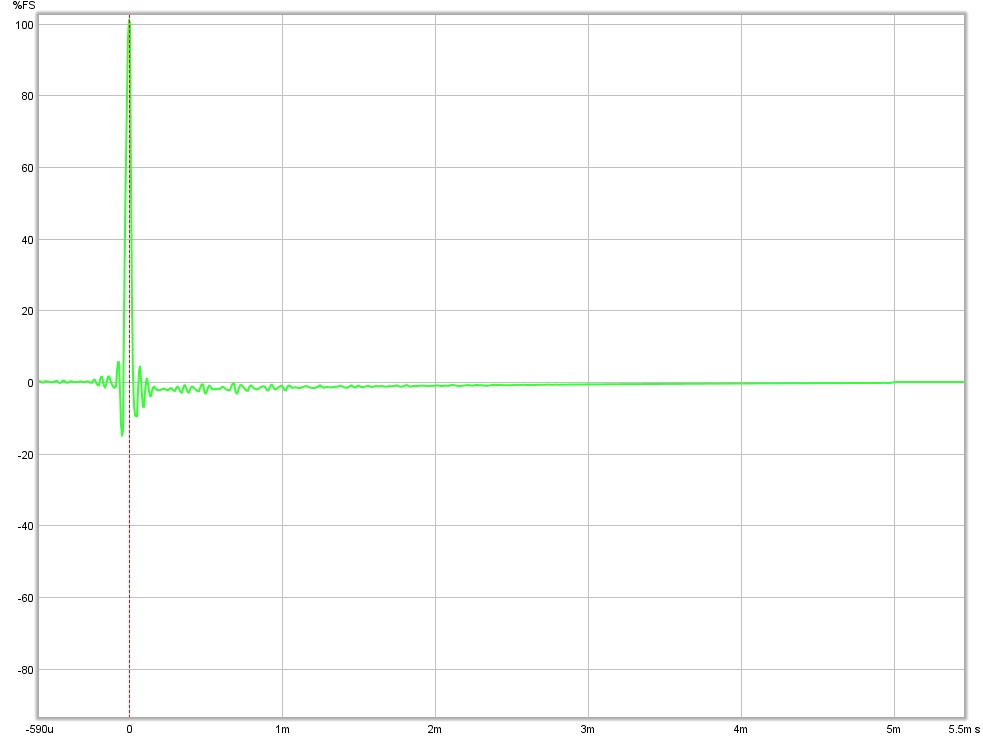

And here is the impulse response - note the ringing with a freq of about 15kHz. Whatever I did to the EQ is giving it a bit of a pre-ringing;
This is the result of the peak that the RS100 has at 15kHz, fortunately, that is right at the edge of my hearing so it is not bothersome. It makes the driver sound metallic - and there is a slight sibillance to metallic percussions. Not surprising as the driver is an aluminum cone. I have not tried to EQ this peak out yet, but if my experience is right, you cannot EQ out a major breakup mode of the driver. So the difference with this and the TC9FD is that it has more "air" whether or not that air is real, if you like that sort of thing, this driver delivers a shimmering high end. On the other hand, the vocals through the midrange are quite nice. I can't tell a difference between this and the TC9FD for vocals. I am listening to some tracks from Sting's "The Summoner's Tales" and it sounds very nice, similar to TC9FD but with more sibillance and airiness. I think most people would be happy with it.

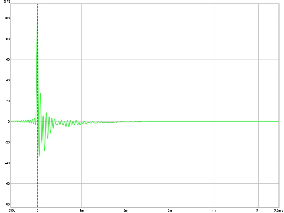

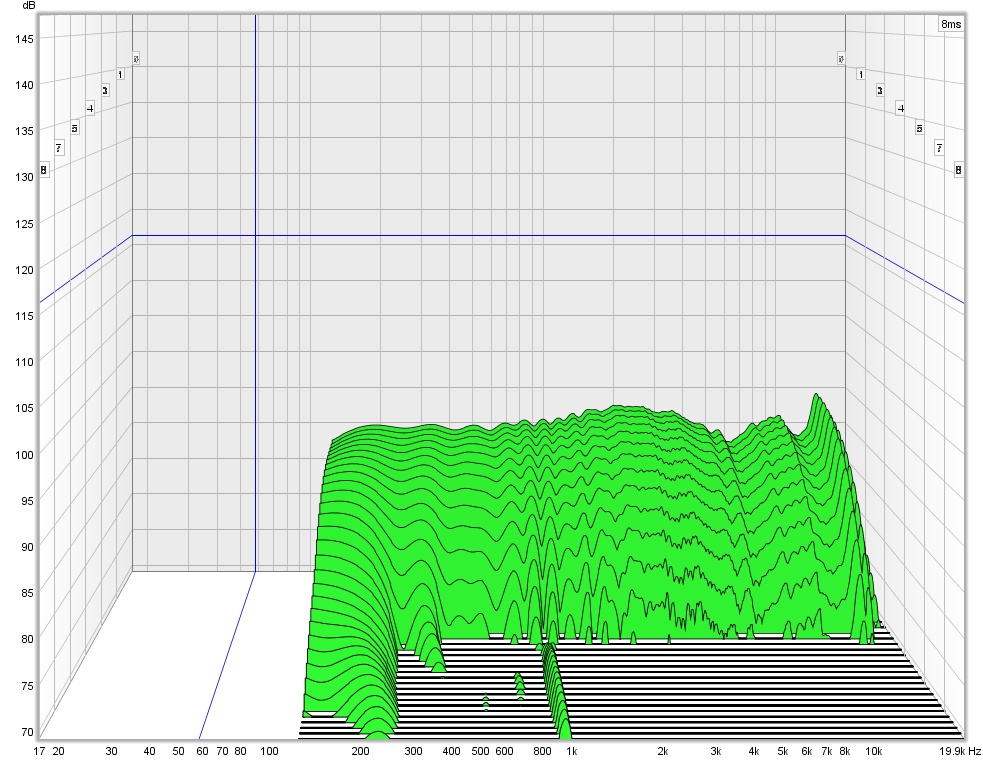

Here's the impulse response to go along with the waterfall above. Measurement made with a piece of open-cell foam inside the hypercube and with the mic ~3" from the phase plug.
I count exactly 15 peaks in 1 ms division so you have the same 15kHz sibillance - this is inherent in the driver and a signature of the aluminum "tinking" sound. I think I prefer the TC9FD paper cone sound more for lack of this signature. Thanks for sharing.
The 15KHz prominence looks amenable to a trap filter.
