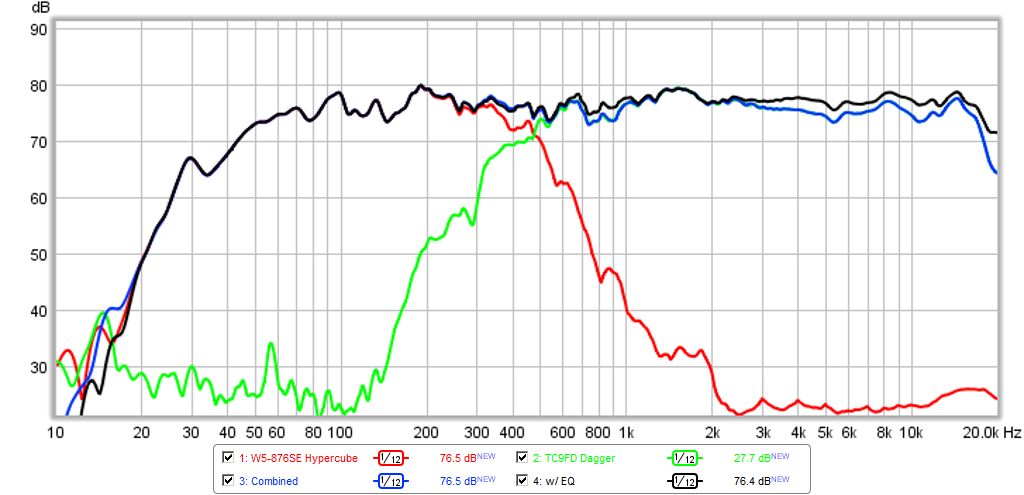

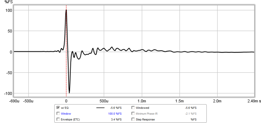

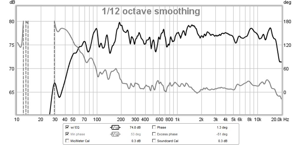

xrk971, 🙂 could be so wrong but listening the Dire Strait track sounds like bass is too delayed at microphone position coming in after top end and this way having it's own signature domain that stands out from rest.
Good ears. The bass horn has a 9.5ms delay (time of flight) and miniDSP only has 7.5ms delay capability so you are probably noticing that 2ms delay. Most people don't catch it. I can also place sub 2ms farther back when being used 100Hz and below. In this case though it's going all the way up to 200Hz or so thus is more noticeable. The 2x8 minDSP has more delay capability.
