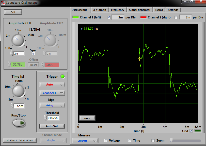

gmad, take your time the request. In meantime laugh my lucky hit minimum phase setup EQ'ed A10.2 sealed Q~0,6 in a sweep hit 5 random square like waves here attach the best one a 355Hz, to be said the 5 hits all spread out there is no coherency.
Setup was freeware PC based Soundcard Oscilloscope here link Soundcard Scope set to listen UMM-6 USB microphone when in player played wav-file generated and shared by members this domain. Link member Legis two square wave sweep files found here http://www.diyaudio.com/forums/subwoofers/258706-study-dipole-cardioid-bass-horn-37.html#post4058732, and link member bwaslo square wave sweep files http://www.diyaudio.com/forums/full...ll-range-tractrix-synergy-21.html#post4058232.

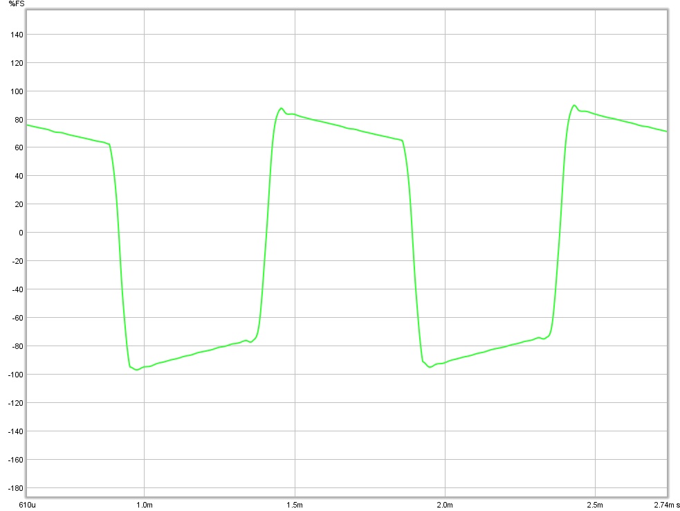

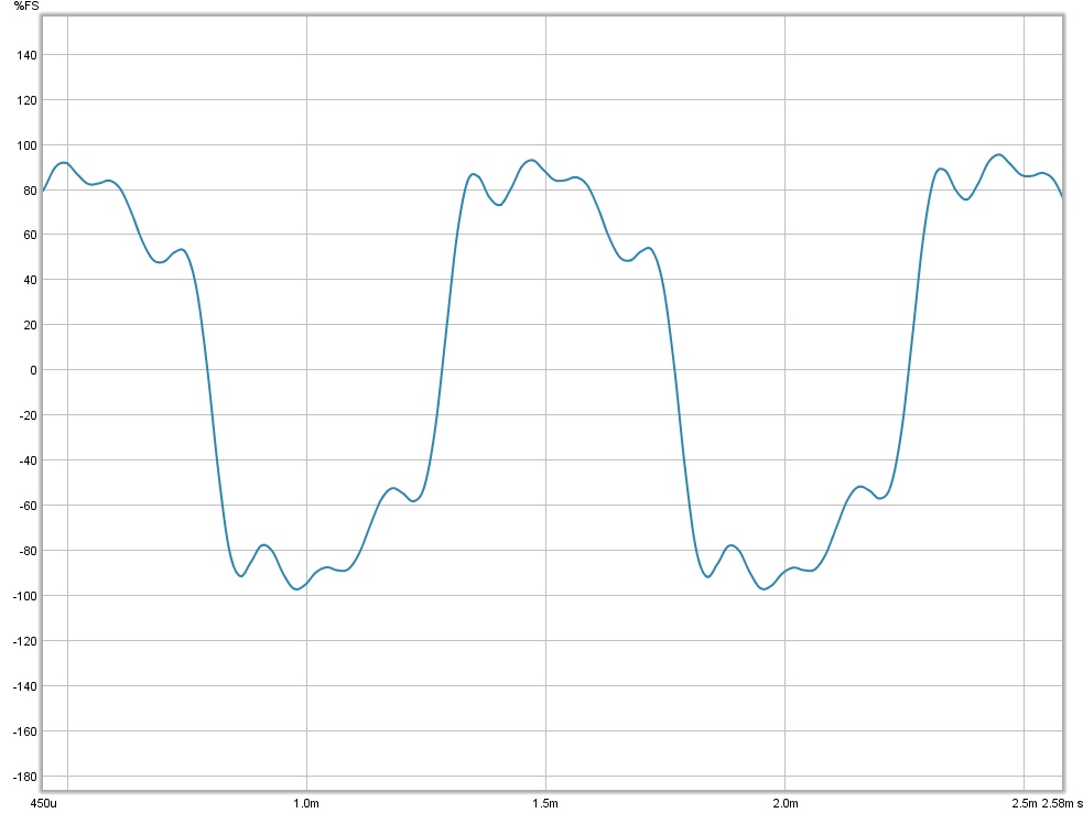

Wow those are the cleanest square waves I have ever seen. I guessed they would be good based on impulse shape. Is it good like this at 400Hz, 200Hz? How do you capture square waves in REW? It is so impressive that I would have to ask you to describe the details of your EQ method and software. I think anyone who sees this would be impressed.
The lower frequencies look good too - as the freq goes lower, the "horizontal" part gets more diagonal looking.

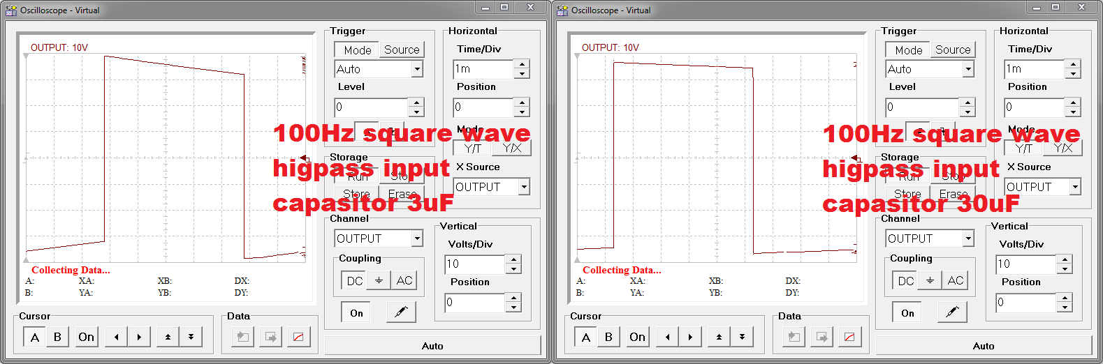

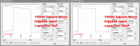

If it's looks like this seems the box and system set high pass filter funchtion doing that. Did a simulation with a high pass filter at input of a power amp normal DC coupled and normal reproduce perfect square waves at 100Hz. Placed a 3uf and 30uF capasitor at input and now 100Hz "horizontal" part change as seen in attached picture, the higher the filter is set the more diagonal looking, up high in frequency these caps don't influence "horizontal" part.
Thanks BYRTT, that's what I was thinking. This highpass function can also be seen in the impulse response in what almost appears to be dc offset after the spike.
