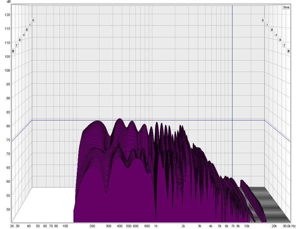

I agree with you. I don't think enclosure resonance is necessarily a good thing. Since the enclosure *must* resonate, I believe that low amplitude wide-band resonance would be a good thing. I have not been able to directly show thus far that the enclosure resonance is actually improving the sound (or adding a sense of ambiance), but I have shown that the sound is cleaner than with a sealed box. Everyone knows about the tradeoffs that must be made when choosing between sealed or ported/TL etc....Compared to a sealed box, I find that the hypercube enclosure has more bass output and less harmonic distortion and ringing. As far as I know, the other popular designs improve output and reduce harmonic distortion by introducing time-domain distortion (group delay and/or ringing). This is not a tradeoff I have been happy making. I know the dodecahedron makes for stiffer panels than a simple box which is why I made my sealed box double the thickness of the hypercube. The hypercube still sounds/measures much better.

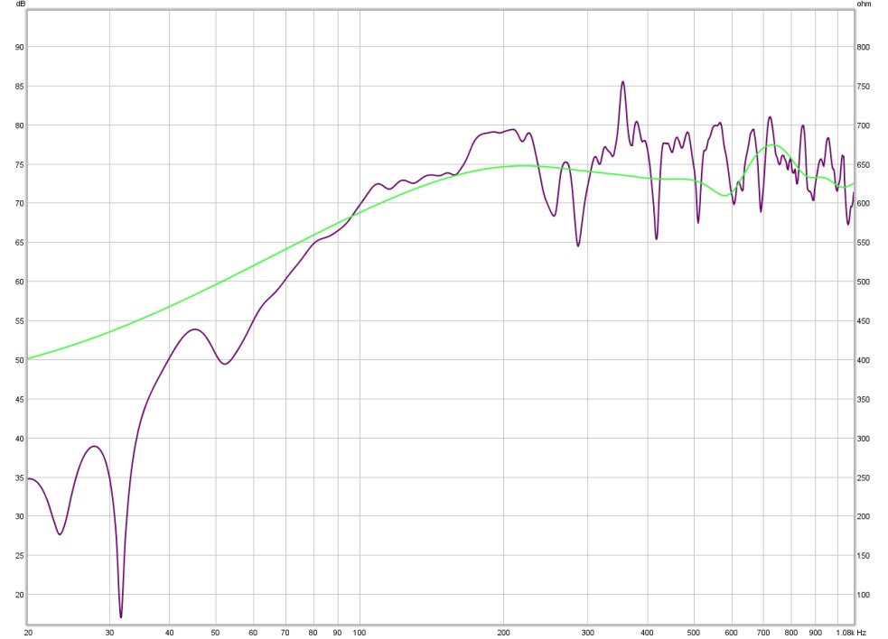

I ran a measurement from the rear of the sealed enclosure to compare to the (stuffed) hypercube. The SPL from the rear of each enclosure appears to be the same for the majority of the spectrum however the response of the hypercube is much smoother (sealed measurement needs to be smoothed to 1/6 octave to resemble the hypercube without smoothing) and there is more output in the bass.
My original claim of increased "efficiency" was based on a measurement I made showing increased SPL of the low frequencies and the also the sound I was hearing from the rear of the enclosure which was much better than with the sealed box. This claim appears to not be valid (above ~120hz), at least with my enclosure. I apologize if this was misleading to anyone; that was certainly not my aim. I do still think this is a great enclosure however.

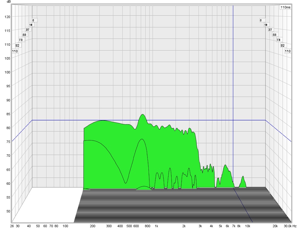

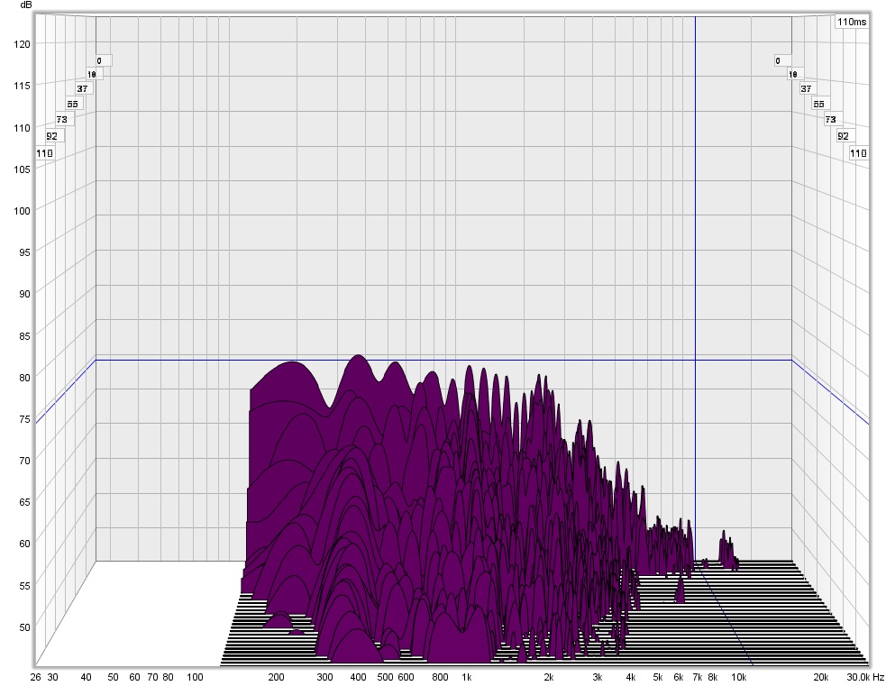

I viewed and captured the measurements as waterfall plots and I think the results are pretty interesting. The rear response of each enclosure is shown over an 8ms and 110ms period. It seems that with the hypercube, in addition to the previously mentioned differences, there is a lot less ringing.
Perhaps the decreased enclosure ringing is what gives the impression of a more omnidirectional sound and makes the speaker sound better when heard from the rear.
VERY interesting, gmad. I think that you and xrk971 have demonstrated fairly well that there is less ringing in the rhombic dodecahedron enclosure. The waterfall plots are clear to me in that regard. Others would be happier with double-blind tests, but you would think that automated testing makes it harder to jigger the data. In my experience people do tend to like the sound of this design, which unfortunately leaves them open to criticisms of experimenter bias if they do testing of any kind.

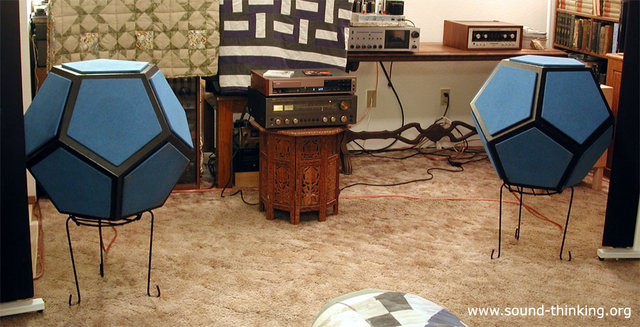

Here's a couple if pics of a 3-way system we built once. In the second image you can see that the midrange cone on the right has its own separate rhombic dodecahedron sub-enclosure, inside the larger one and only visible when the woofer is off the baffle plate. You can also see how thin the wood (gum plywood in this case) is. We made this set hoping to get it tested by Hirsch-Houk Labs, but it didn't happen. You can also see we learned of the necessity of shock-absorbing boxes. This set was hand-delivered by us, driving from Florida up to NYC to hand it over to the offices of Stereo Review magazine. What we got back when they shipped it back is the second photo. Clear air turbulence of the shock of landing in FL may have caused the woofer's momentum to crack through the baffle plate. Another lesson learned; either we should have used thicker wood or taken more time in devising better padding in the shipping container, or both.
BTW you've probably noticed that in the first [pic the midrange is on the left and it is on the right in the second pic. The two speakers were constructed symmetrically rather than identically. This gave rise to debates over whether the midranges or the tweeter horns should be diverging or converging when facing the pair of speakers.
This is a triangular-truncated rhombic dodecahedron, rather than square truncated. Here's another pair of pics showing the over-engineered squashed cube grille. Tom constructed the grilles himself, and they had no trouble surviving the shocks of shipping.

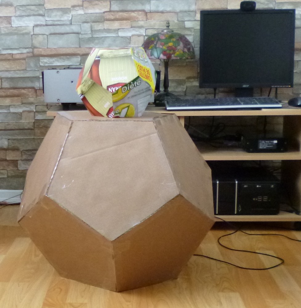

here my cardboard 90 liters dodecahedron . 21 inches high .
5.8 liters for the small one on top .
I would listen to well my Supravox 215 signature in this dodecahedron.
( wood model of course...)

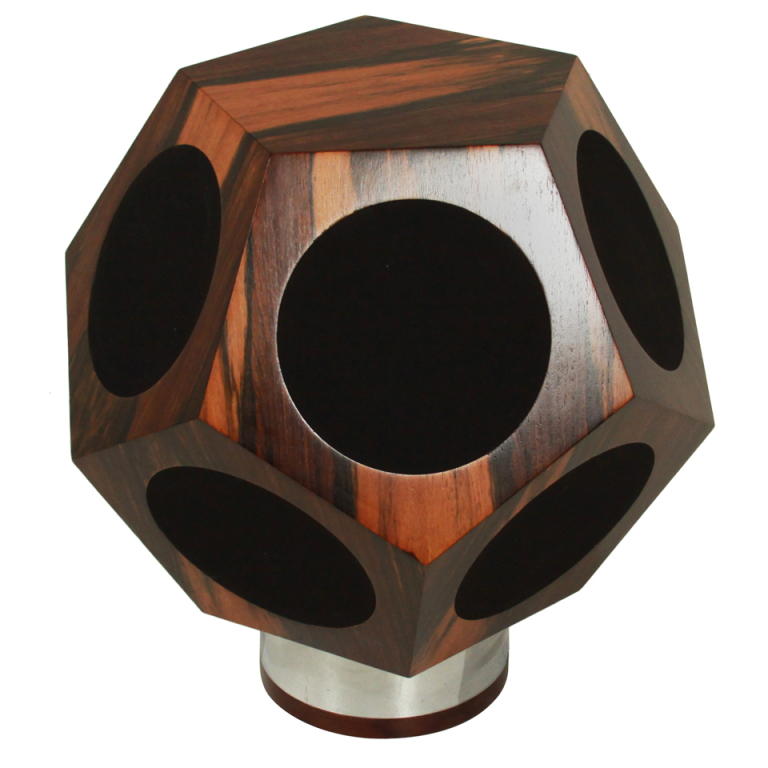

Design Acoustics D-12 Dodecahedron Omnidirectional Speaker
Extremely rare Design Acoustics D-12, a dodecahedron omnidirectional speaker. This was one of Design Acoustics first products and it essentially made the name for the company. It was reviewed by Julian Hirsch in Stereo Review in the 70's and received some of the highest marks given by Hirsch to any speaker ever. The D-12 remained for some time as the magazine's highest rated speaker, with a perfect 100% score overall. Years later, it was still mentioned favorably. This is one of the closest speakers to ever achieve true "omnidirection," radiating sound evenly in all directions.10 drivers cover the surface.
https://www.1stdibs.com/furniture/m...cahedron-omnidirectional-speaker/id-f_799284/
