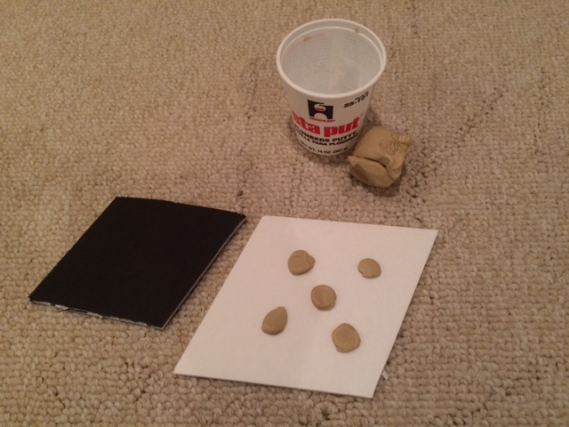

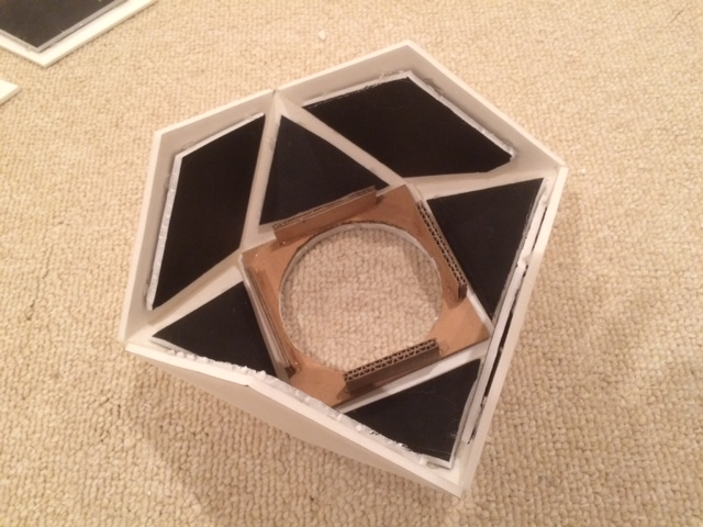

Hypercube (mass-damped) with PRV 5MR450NDY
My next experiment was to see how smooth I can make the Hypercube for my favorite driver, the PRV 5MR450NDY (more info on this driver here http://www.diyaudio.com/forums/full-range/259293-prv-5mr450-ndy-fast-applications.html) to use as a monitor. I made the panels with a 6.00 in edge for the square and 5.20 in edge for the rhomboids. For each plate, I used a smaller plate from the 5.62in x 4.00in Hypercube and I put several dabs of plembers' putty in between the foam core panels, the edges then got several tack points of hot melt glue to secure the plates together. The putty adds mass and the second plate sandwich construction helps to stiffen and dampen the natural resonances. Tapping the panels, you can hear a dull sound rather than the lively resonance. A Hypercube with 6.00 in square edge has a volume of 6.5 liters, accounting for material thickness, probably closer to 6.35 liters.

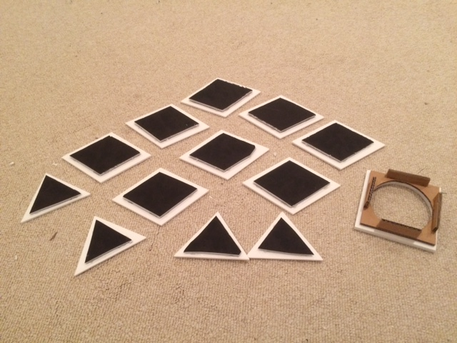

Here is the panel getting dabs of putty:
Here are all the mass-loaded panels together, note added triple ply cardboard and bracing for driver mounting, I used a double layer of foam core for the baffle plus the cardboard - this is a heavy driver capable of high SPL (250 watts RMS):

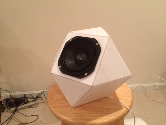

Finished mass-damped Hypercube with 5MR450NDY driver mounted:

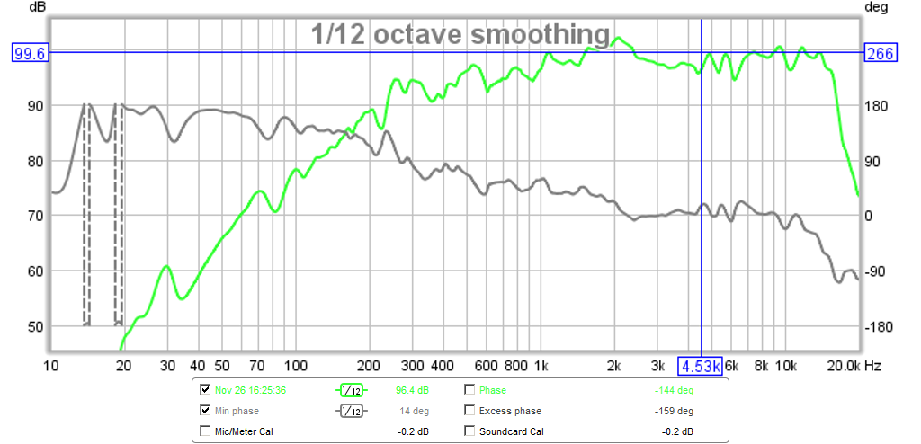

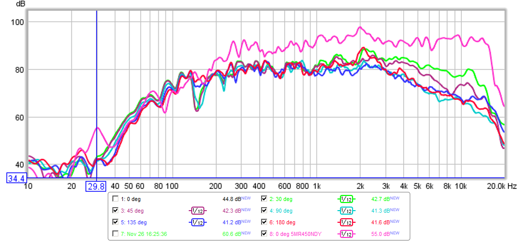

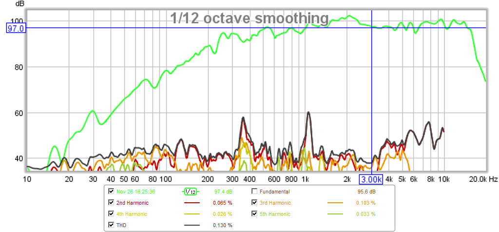

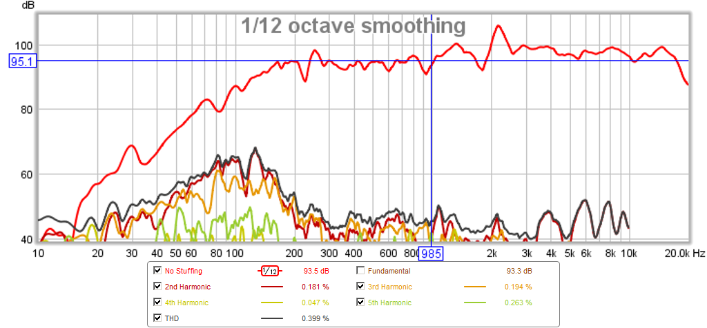

Here is measured response at 0.5m showing very low HD, however, a couple of sharp peaks of 2nd harmonic distortion at -40dB are present at 350Hz and 1.1kHz, overall though, a very clean sounding speaker with most HD around -55dB above 200Hz:
For comparison of the HD of the TC9GD, notice how much more there is below 300Hz (most of it is the driver, but some is the enclosure vibration):

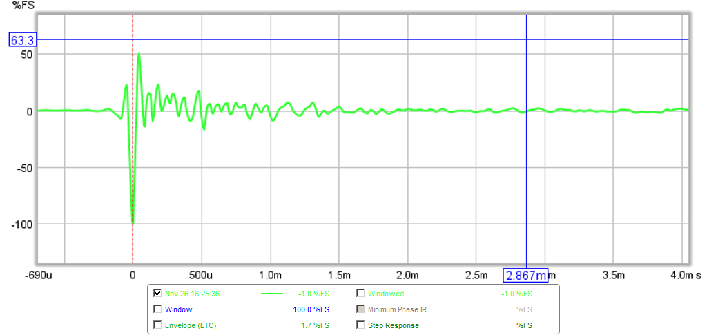

Here is the Impulse response - slight ringing from cone breakup (this was apparent on other speakers with this driver):
Here is the response compared to the Vifa TC9FD in the smaller Hypercube, both driven at 2.83v and measured at 1m distance:

Another easy and quick speaker to make - 2 hrs and 3/4 sheet of foam. 5 glue sticks though and half a tub of putty.

Outstanding job once again. Like me, you have noticed a significant reduction of HD in the lower frequency range. I can't wait until you try a driver with more bass capability or perhaps a "hypercube sub".

There is nothing to suggest that this design has anything
to do with or any avantage in any respects related to the
distortion profile of the drivers, other than of course its
peak will be the 2nd, 3rd etc of lower frequencies.
There simply isn't low level wideband output, its complete
and utter nonsense, a figment of attempted understanding.
No understanding = no way forward. Seems to me that
is very similar to claiming something is the pinnacle.
rgds, sreten/

Most of the reduced HD is the driver itself - as it has a high fs of 175Hz and a stiff suspension so there is not much movement down below 200Hz. This enclosure is much like a sealed cabinet - no bass really so must be used with a sub as in a FAST to get the full range down low. On your RS100's I am surprised you are able to get that much bass from them - probably quite a bit of HD below 150Hz though.
Oops, I should have realized I was looking at the response of two different drivers. Since I noticed less HD with my RS100 in the lower octaves with the hypercube enclosure I thought for a minute that that's what I was seeing in your post.
