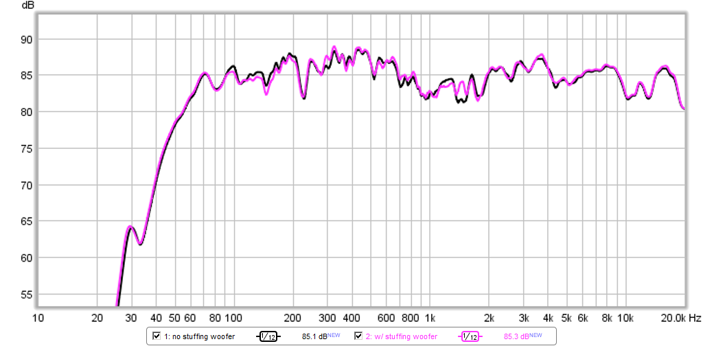

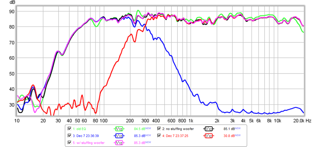

Effect of Stuffing on Bass Hypercube
I first tweaked the EQ a bit to reduce the bump at the XO point and I gave it a little more of a BSC cut, and boosted the highs above 16kHz. I also added polyfill stuffing into the bass Hypercube. Here is what the response of the LF, HF, and combined now look like compared with the previous response (green):
Here is the comparison of with (magenta) and without stuffing (black) at 5dB scale (basically no difference):
The fact that stuffing made very little difference is interesting - the empty enclosure does a good job.
Yes I agree xrk971 - the fact that stuffing the enclosure does not seem to be that necessary for this shape is something I have found interesting for a long time, particularly since I have been told so many times that enclosure shape makes no difference, only enclosure volume.
I have not investigated all possible shapes, but I maintain that this enclosure shape does make a difference. It is not a panacea, and perhaps the difference it makes is not one that all would appreciate. But it does make a difference. And the fact that the difference is made by geometry, not by stuffing, implies that there is definitely a difference in the woofer <--> air <--> enclosure interaction physics.
