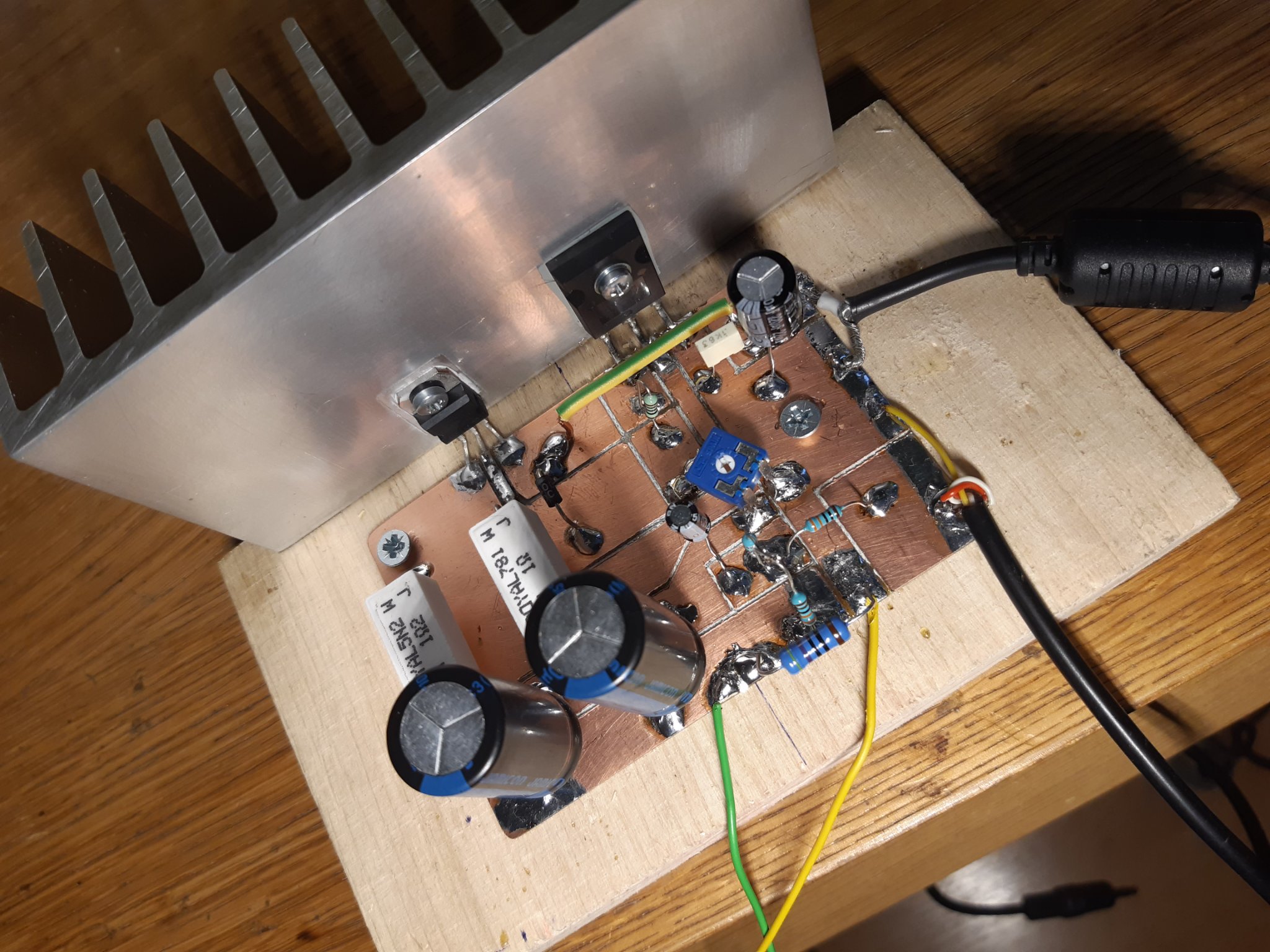

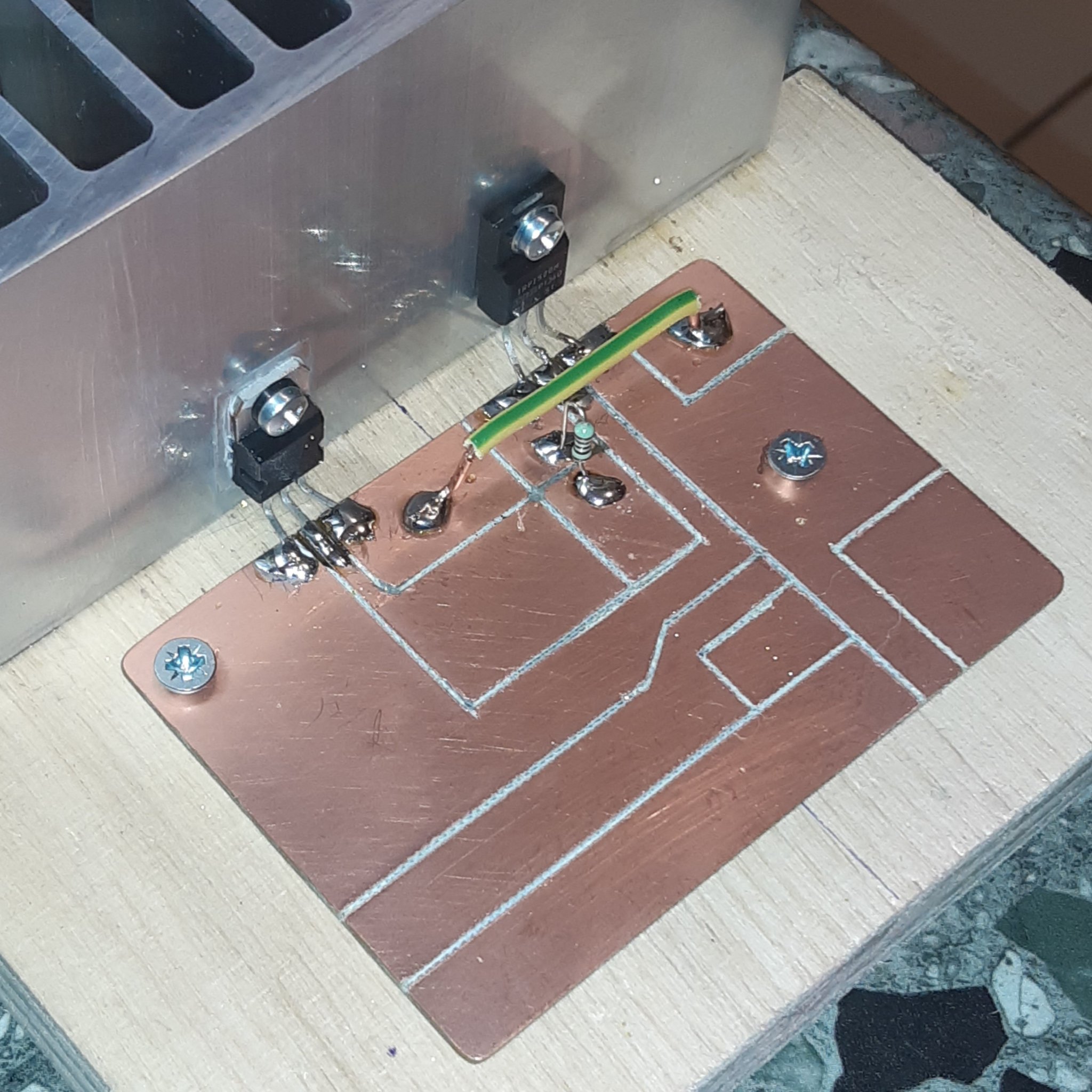

Diego, many thanks for your very detailed answer. I use a full range 30W, 13cm, paper dual cone Monacor speaker in a homebrew, 25x35cm wooden OB. I have ARTA but it would take a couple of days to make a proper setup for all measurements. What I've done so far, on my handheld oscilloscope I can clearly see a clean sine wave amp ouput, with input provided by an online generator using my mobile phone, at 5 Hz, 100 Hz, 1000 Hz, 10KHz, 18Khz. Max input RMS is about 0.4V and output RMS is around 3.7V (measured on the amp output's 5W, 8.2ohm resistor)--clean looking sine wave.

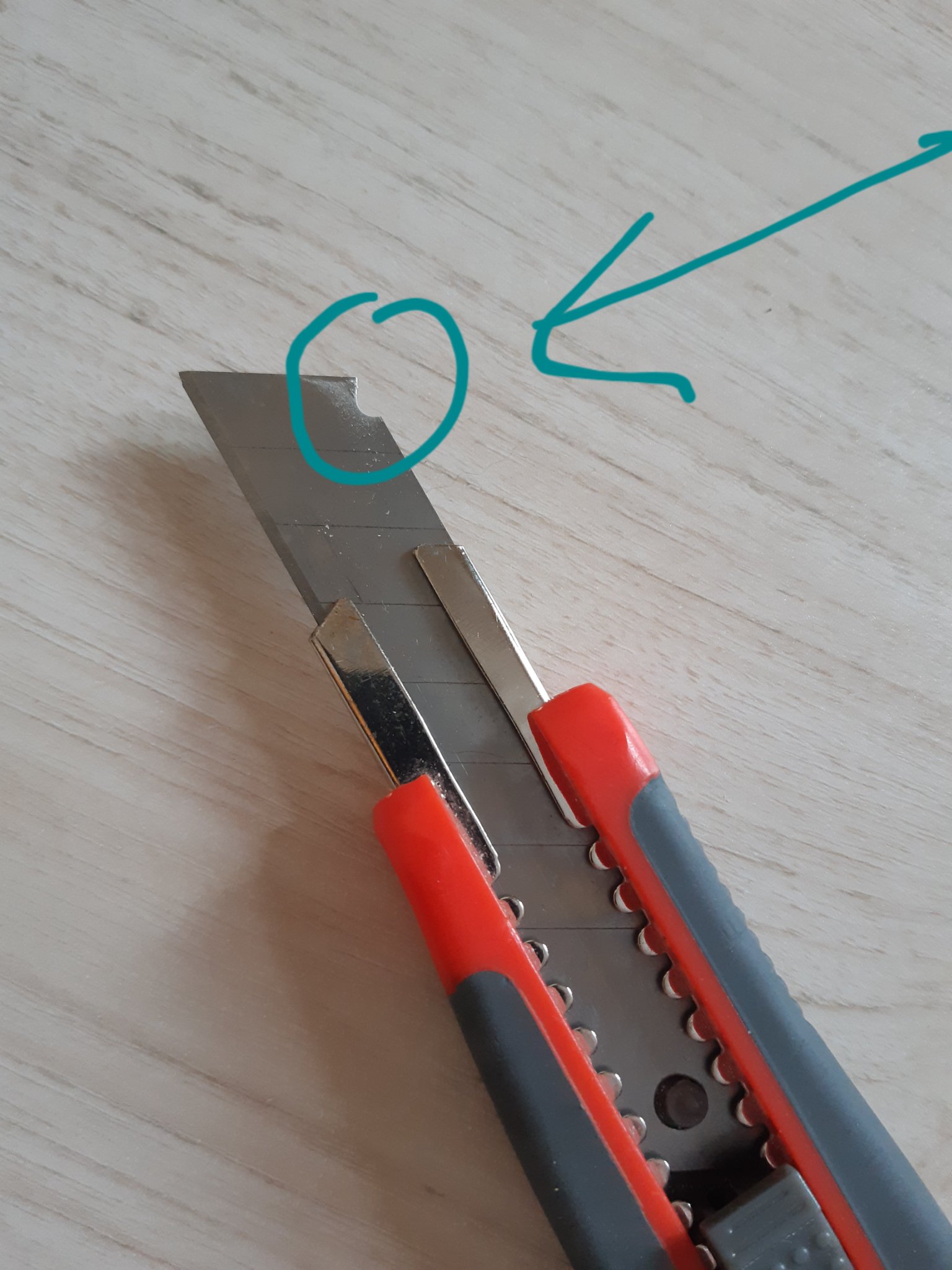

Ref PCBs, I always use this quick enough technique for them, scratching copper clad with this cutting tool.
Bests,
Radu

I used IRFP044 instead of Diego's IRFP150, and because I've used a low output portable CD player as a source, I increased feedback resistor R5 to 6.6K from 2.2K. I mention I use a laptop smps which outputs 20.4V, and 5Watt resistors R2=1ohm and R1=1.2ohm. If it's possible, Diego, please help me: how my feedback resistor change (giving larger voltage gain) impact THD ?
Many thanks !
Hi Radu
Nice build
Both your transistors look like the size of TO-220. The IRFP044 is usually manufactured as TO-247 which is much bigger than TO-220. Could you please verify your transistors. I’m just waking up with my first coffee so hope I’m not saying vlakies.
Eric

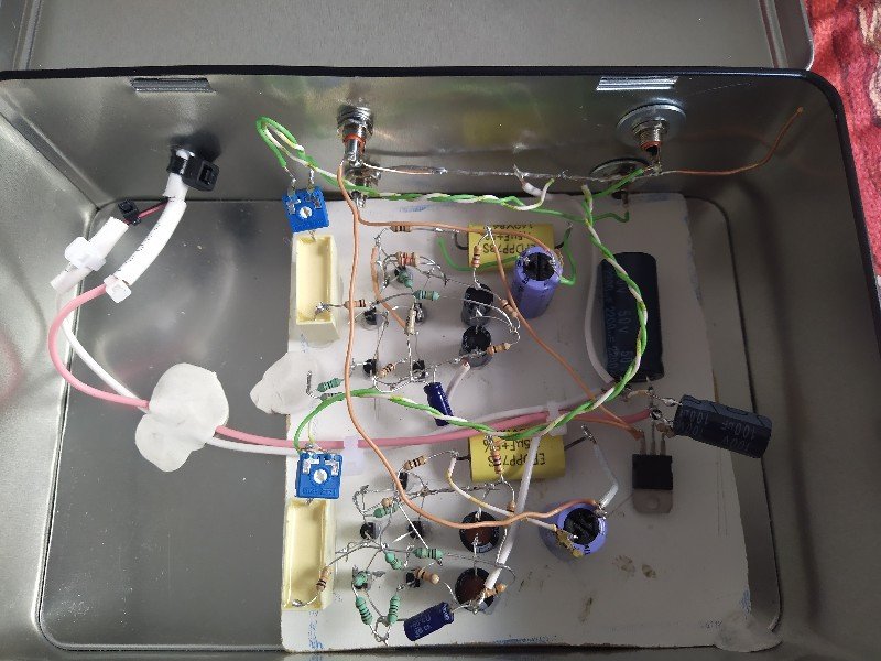

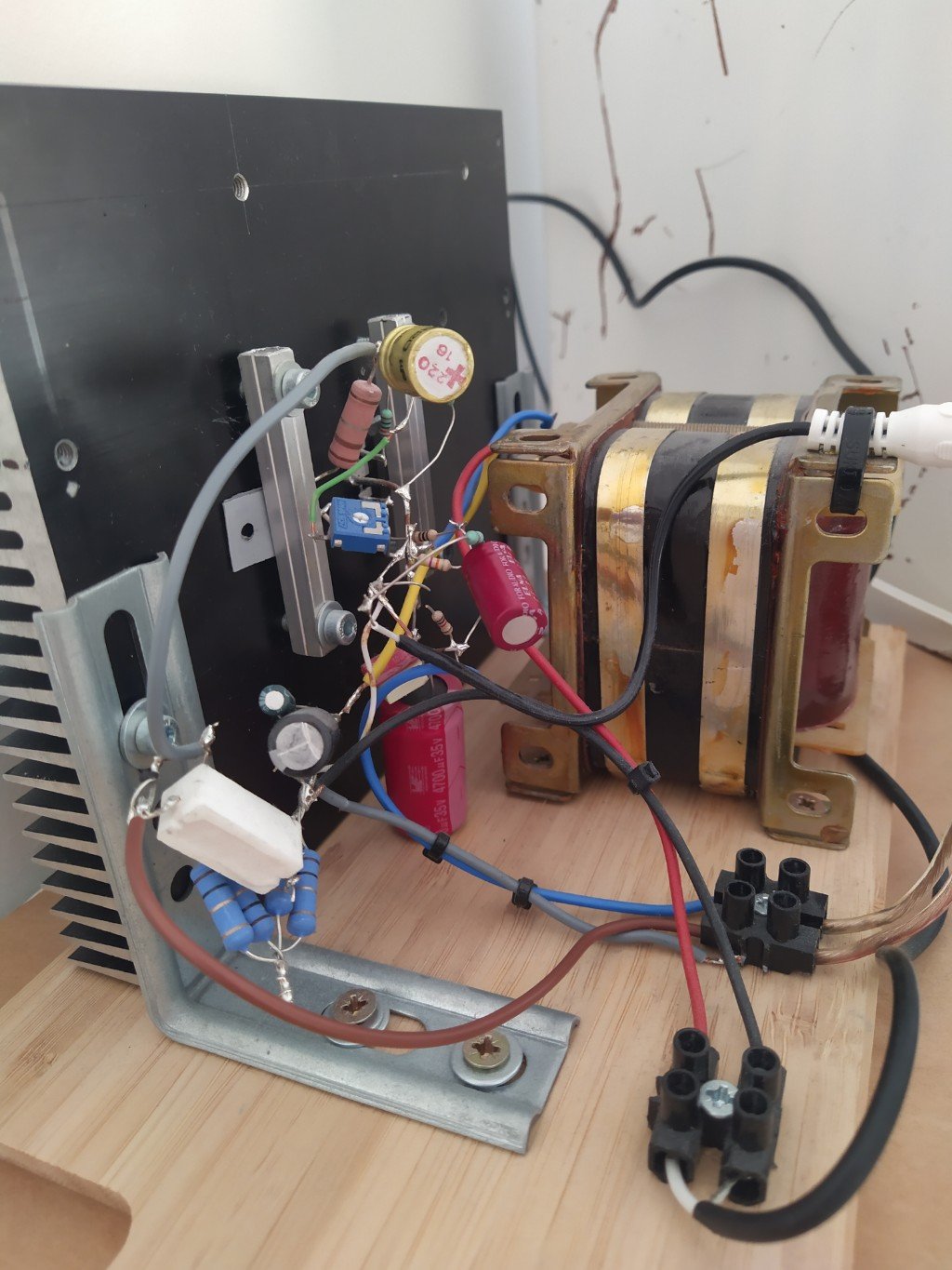

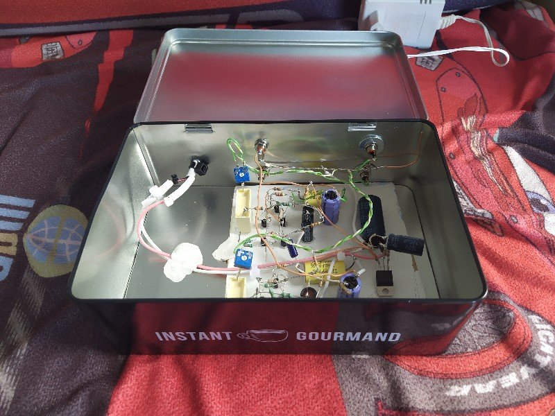

Piece of cake 😀
Really, itcould be done p2p, no fuss. Don't want to go off topic, but for example, I had built Frontend 2022 preamp without a PCB, look:
