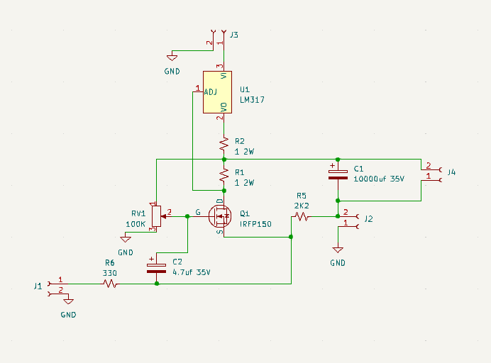

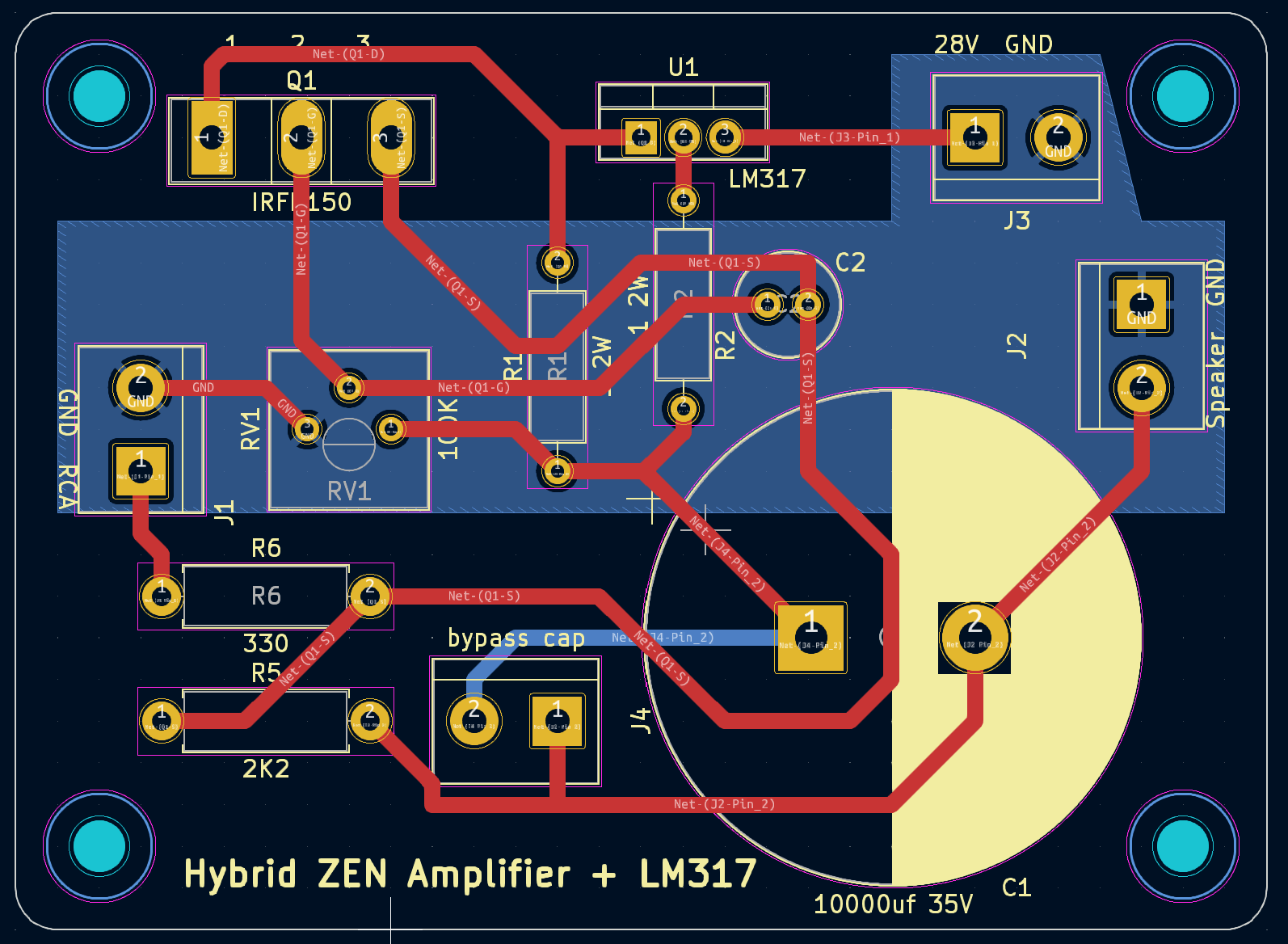

The LM317 could offer some advantage over the more well-known modulated current source option implemented with a mosfet and a small bipolar transistor. I believe that the most obvious advantage could be in a better thermal control of the static polarization parameters, which could even allow a direct coupling of the output, if other conditions are ensured simultaneously.

I never looked into what output decoupling cap to use.
But for 8 ohm load, a 10000uF will give you -3dB at 2Hz, so minimum really.
Mouser still has some Nichicon LS, though already End of Life, like all audio components.
LKS1J103MESC
And then maybe a 100uF film cap in parallel for 200Hz upwards ?
Cheapest I can find is at DK :
B32778Z4107K000
Them together will set you back ~25€ per channel.
Probably more than all other components combined, if you do your own matching.
Not counting power supply, of course.

All these high transconductance MOSFETs, including the IRFP044 mentioned before, have high Ciss.
That means to drive them in common source to a decent bandwidth requires low value resistors in the feedback network.
See Diego's post #45.
Unless of course you cascode, like in the Zen Variation 9.
Then you can go back to more common power-amp Zin of ~10k.
Penalty ? Needs higher voltage.
No free lunch.

- Hybrid ZEN Amplifier + LM317 = Efficient and simple
