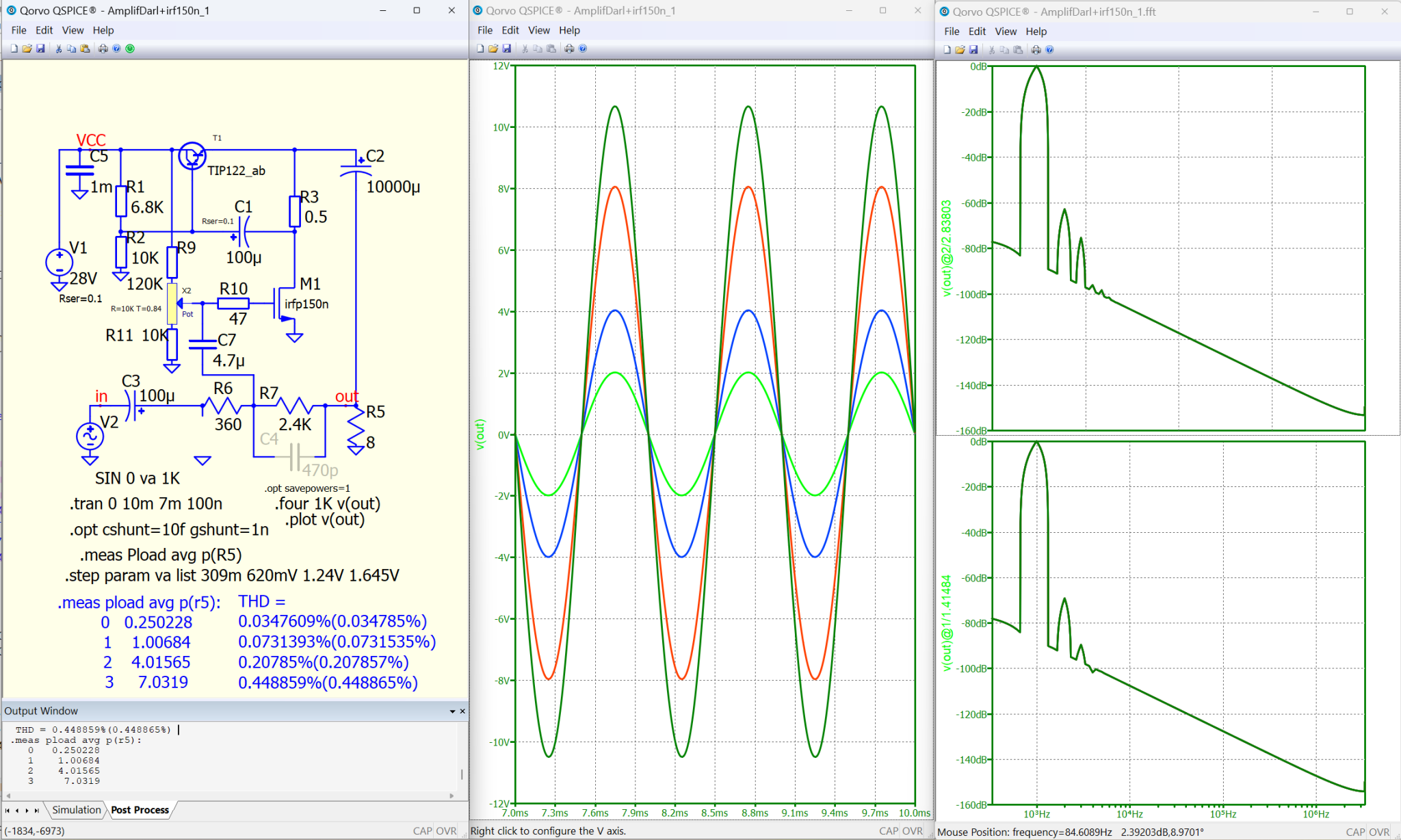

Hybrid ZEN Amplifier + LM317 = Efficient and simple
Your new R2/R1 ratio is now 0.12
Maybe you meant to write that R2 is 1 ohm and R1 is 2.2 ohm ?

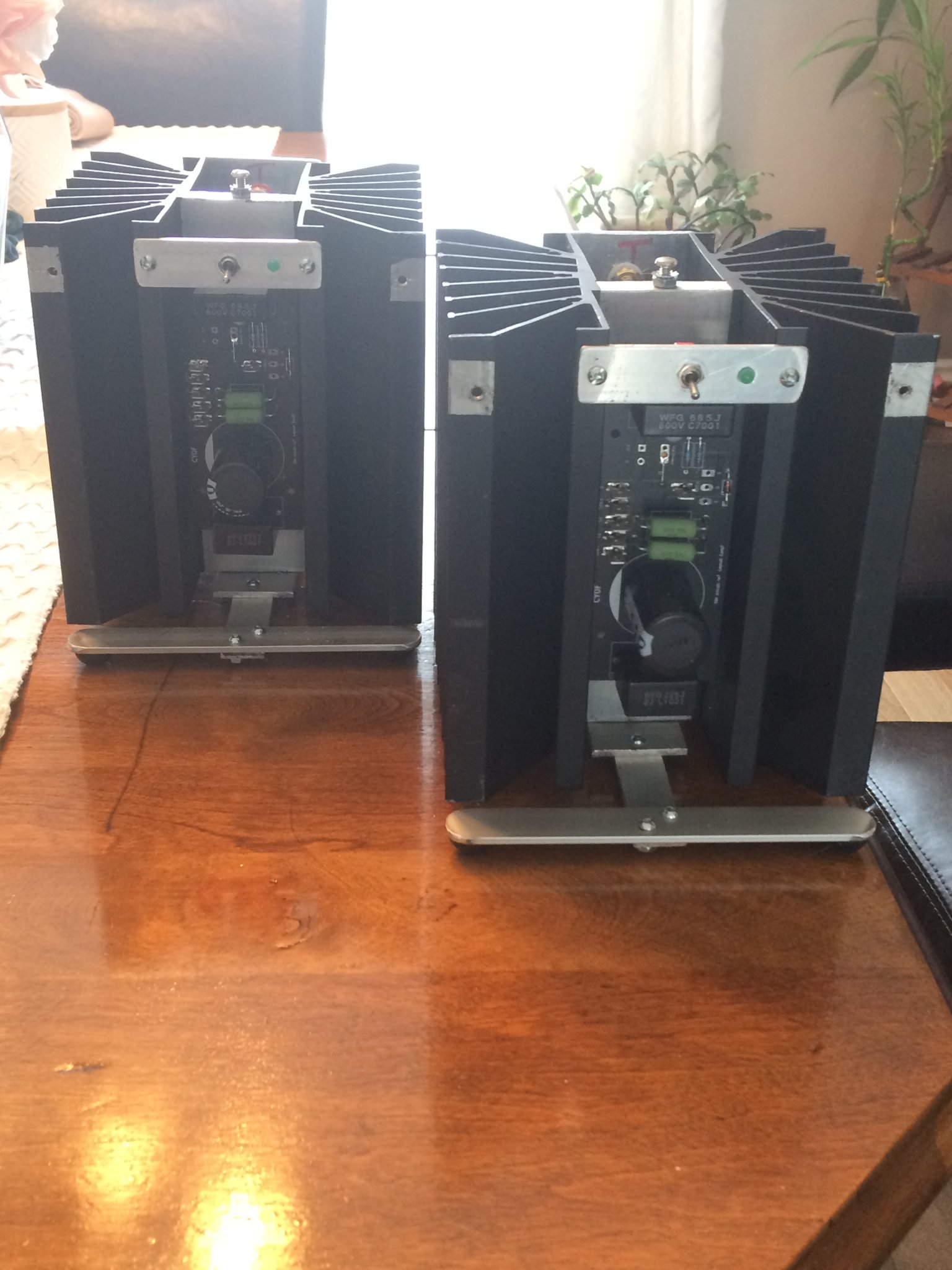

Probably but the deciding factor will only be based on the heatsink shape I’ll decide to use. Julian’s PCB are very nice but won’t fit with my vertical heatsink (I won’t be able to fix the MOSFET to the heatsink), example of my heatsink, see below when I had build my mono VFET

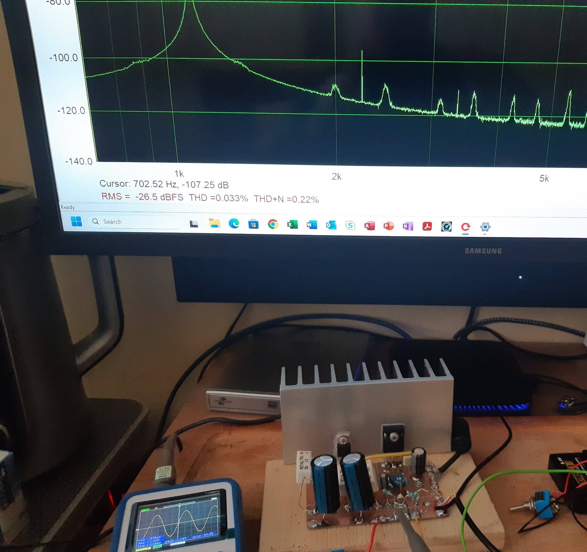

No mistake, I used 8.2 ohm R1, but because of the meagre bias current (about 150 mA), distortion sky rocketed. It became clear now - to me- that these TO247 mosfets are current hungry and they operate best at higher bias currents: with a 0.55 ohm R2 and an 1.2 ohm R1, measured current was about 0.7A, too much heat for me...but looking at your heatsinks, -- totally different story.
Bests
My final setup:

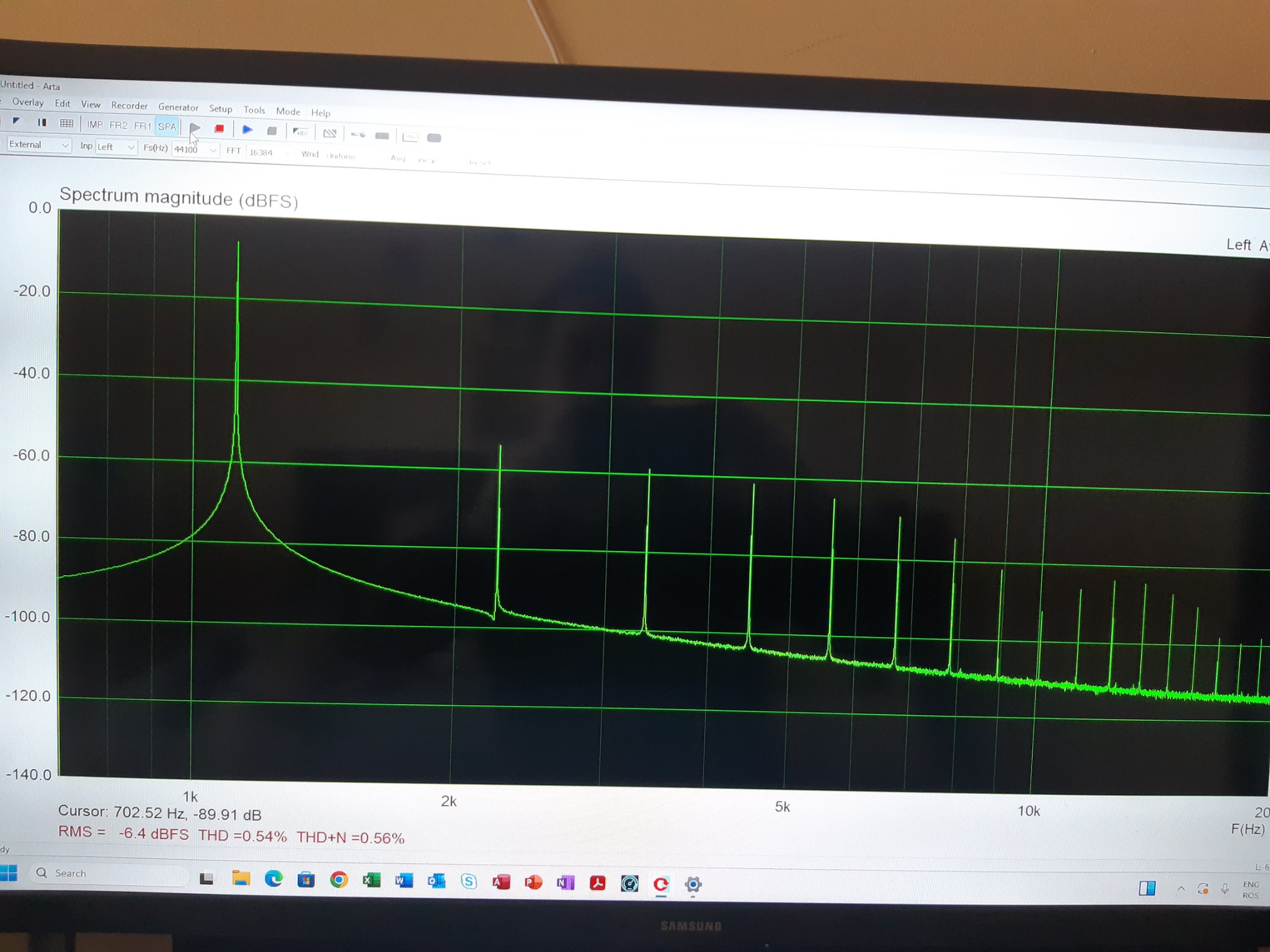

Laptop power supply 20.4V, R2=0.55ohm R1=1ohm. I also got back to Diego's original feedback resistor values: 330 ohm, respectively 2.2K. (This gain keeps THD at very low levels, with H2 distortion and the even ones ruling across the spectrum.
I'm overall very happy with this amplifier's sound, its measured performance and its tube-like harmonics shape.
According to the graphs below, THD at max power --1.8 W RMS -- is 0.54%; THD at 1W is 0.23%, THD at 0.5W is 0.14% and THD at 150 mW is 0.033%. I think these are really good figures for such a simple amplifier.
Thank you Diego and thank you guys for advice !

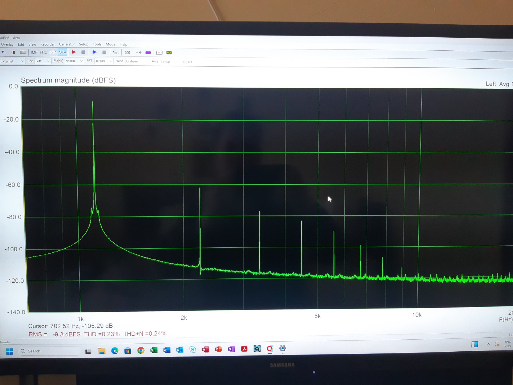

I managed to trim distortion even further by keeping the amps's nice H2 dominant shape.
THD=0.18% at 1W/1,100Hz.
THD is 0.11% at 0.5W and 0.3% at the max power of 1.8W RMS.
To accomplish this, I only increased 'a bit' the bias voltage ( measured between the positive side of C1 and ground) to 12.4V from 10.3V... this is not half my voltage supply of 20.4V anymore... should I worry about this ? How does this work ?Thanks,
Bests,
R

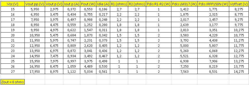

Only as a guide for those who wish to adapt it to their possibilities:
Best regards
Check the last column for VCC voltages between 20 and 21 volts. The offset voltage should be close to 11 volts, for a VCC of 20.4 volts.
Anyway, the best option is to adjust with an oscilloscope to obtain asymmetric clipping, as already suggested adequately.
The offset voltage with respect to 0 volts is not the classic 1/2 VCC in this curious circuit.
Best regards
Weird finding:
Clipping occurs only at an offset voltage of 9.3V at the bottom of the sine and at 13.5 V at its top, so over almost the entire range of the pot, the sine wave doesn't change its shape nor its amplitude. Please note this measurement was done at max power (Vrms=3.8V, Vpp=10.7V).
