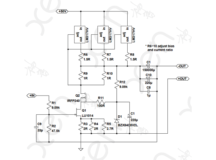

Hybrid ZEN Amplifier + LM317 = Efficient and simple

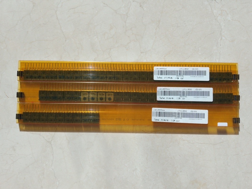

This neat little amp looks like it would also work well with the IRFP048, a close descendant of the IRF044 as used in the original Zen amps.
The original. 😎
As already mentioned in post #4, you can consider using 4x LM317HV in parallel to enable higher rail voltage.
Patrick

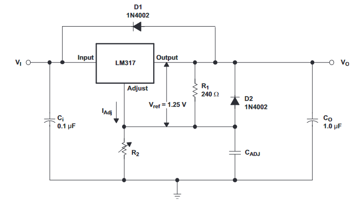

Although I present it as an open concept, what could be added to arrive at a fixed design would be a decoupling capacitor at the input of the regulator (very close to it) and a 1N4007 type diode between the input and output pins of the regulator itself (cathode on the output pin of the regulator and anode on the input pin of the regulator), both elements that have not been incorporated for reasons of clarity of the initial diagram. That would be, at most, since it is a terribly simple scheme and I don't think it supports much more than what it already is, unless it is necessary to mount a version with much more power (several LMs and several Mosfets).
Best regards
The purpose of a diode present from the output to the input of the LM317 is to provide a discharge path that protects the regulator from reverse current in the event of a rapid collapse of input voltage relative to output voltage.
In the application proposed here, the input and output voltages around the regulator are likely to discharge with similar rate, or more likely to have the output voltage discharge faster through the speaker terminals or local load resistor. The diode may not be necessary, but if one is used, it should be of the 1N400x series as noted above.
I think the cathode at the input and the anode at the output is more correct.
I apologize for my mistake. Although I was thinking precisely about that diode (D1) and that this is how it should be connected (as the manufacturer suggests), I did the opposite 🤣🤣🤣.
Sorry once again.
Anyway, you will understand what I meant. There isn't much science behind that.
Best regards
Just to clarify, I was meaning TO3P devices for the amplifier PCBs, pretty sure the pin outs of LM317 and LT1084 are the same.
See post #2. LM1084, LD1084 are all copies of the original LT1084, but cost less.
Not sure whether they also "sound" the same.
But all are limited to 30V, hence the alternative solution to use 3~4x LM317HV in parallel instead.
Matches perfectly with the 60V of the IRFP044.
As in all First Watt amps, 48V single rail at 1.3A bias will let you swing +/-20V into 8 ohm.
And each TO220 only dissipates 8~10W.
Or 24~30°C rise junction to case.
Patrick

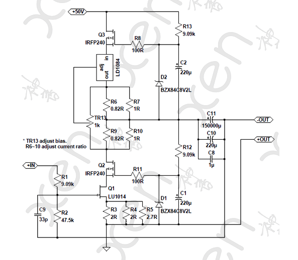

The top cascode serves 2 purposes.
It not only allows much higher voltage swing.
But equally important, it takes the bulk of the dissipation away from the TO220 device.
In Diego's circuit, the bias current is determined by the LM317 and associated resistors.
In the LU1014 circuit, the power JFET determines the bias.
(See article on Zen Variation 9)
https://www.passdiy.com/gallery/amplifiers/zen-variations-9
Hence TR13 is added to allow easy adjustment of the bias current of the LD1084.
Patrick

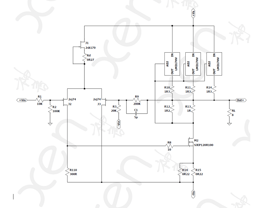

Replacing the LM317T with the LM338T would be an interesting route to explore, maintaining the circuit simplicity with which the thread originated, with which the reliability offered by the small number of components can also be maintained.
I do not detract from the alternatives kindly presented by EUVL, which probably perform better than the option that starts this thread. In that case, it would be interesting to differentiate these variants in a specific thread, so that forum members are not confused when building a variant.
Best regards
Quite the contrary, Patrick, the latest scheme you have kindly uploaded is more than promising. It is likely to offer a more extended frequency response when using this technique (cascoding).
It would be great if you built it and let us know how it goes.
Diego
