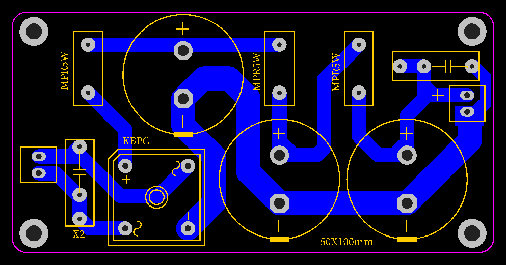

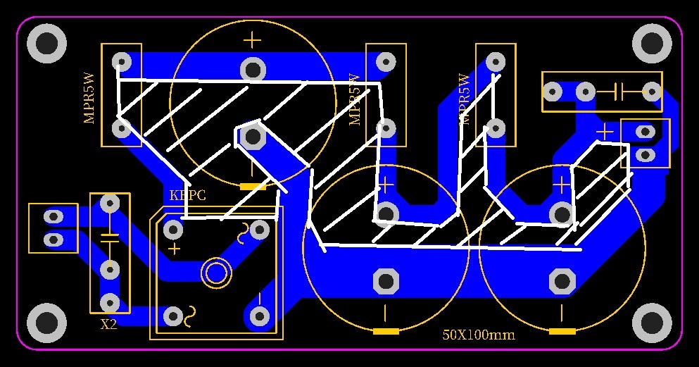

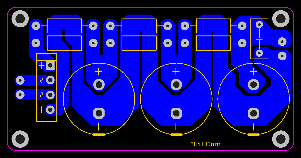

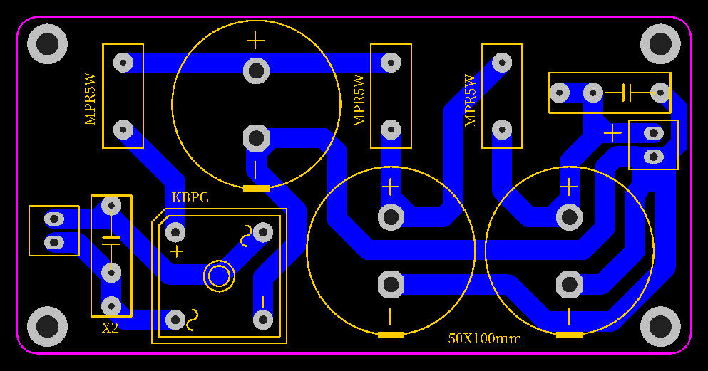

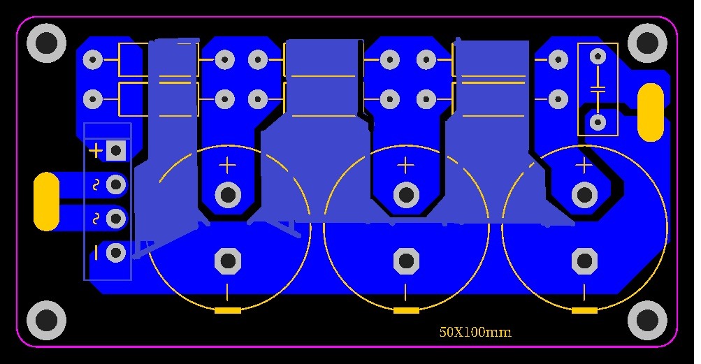

Electrical current flow in loops. Large loops act as antennae and may receive and broadcast noise. So keeping loop area small reduces the noise that may be emitted and picked up.
Here is the area within the loop of the DC flow within the power supply pcb:

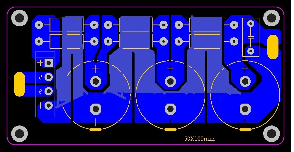

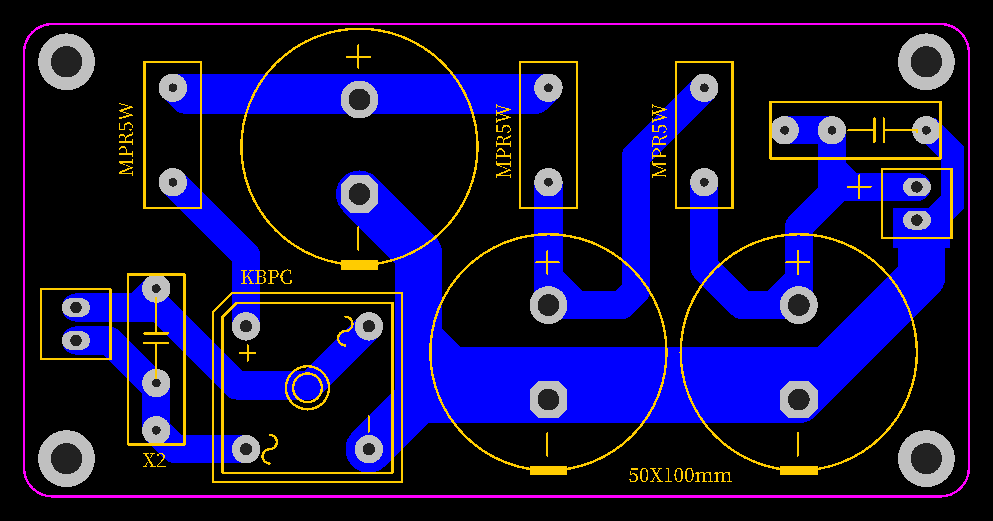

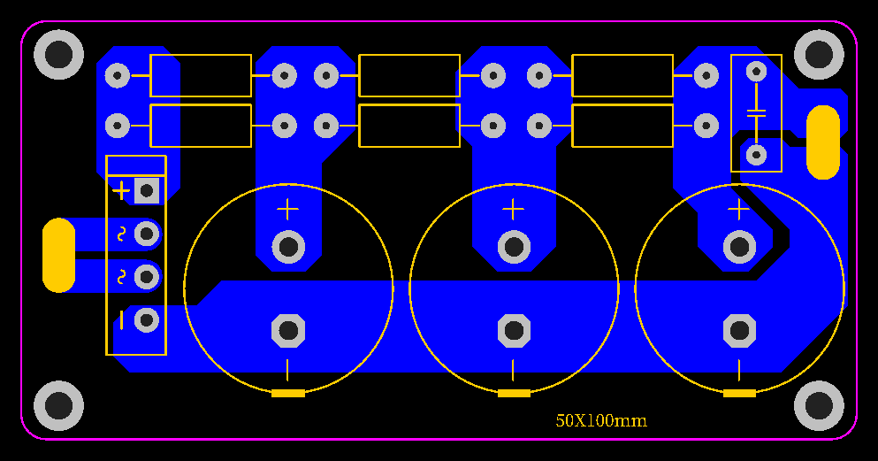

Here are two suggestions to reduce the loop area further. The second may be better. A third suggestion is to put a ground plane on the bottom side of the board. That may be the best.
By the way, an amplifier has several current loops and they all can be vulnerable to noise. There is the DC supply loop, the input signal loop, the speaker signal loop, etc.

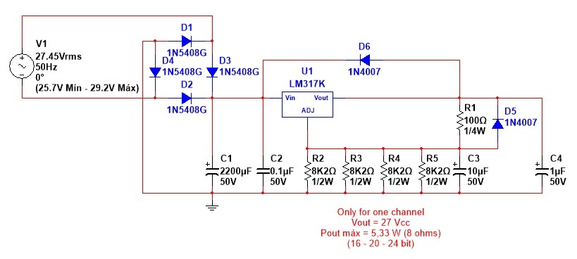

This modest power supply design could be used with acceptable results in the 27Vdc powered option, where R1 and R2 in the amplifier schematic are set at 1 ohm each.
Remember to provide a heatsink suitable for dissipating up to 15W for the voltage regulator of this same power supply.
The output voltage of the secondary winding of the power transformer should be between 25.7 Vac and 29.2 Vac. The suggested power should be between 80 to 120 VA per channel.
Best regards
Best regards
