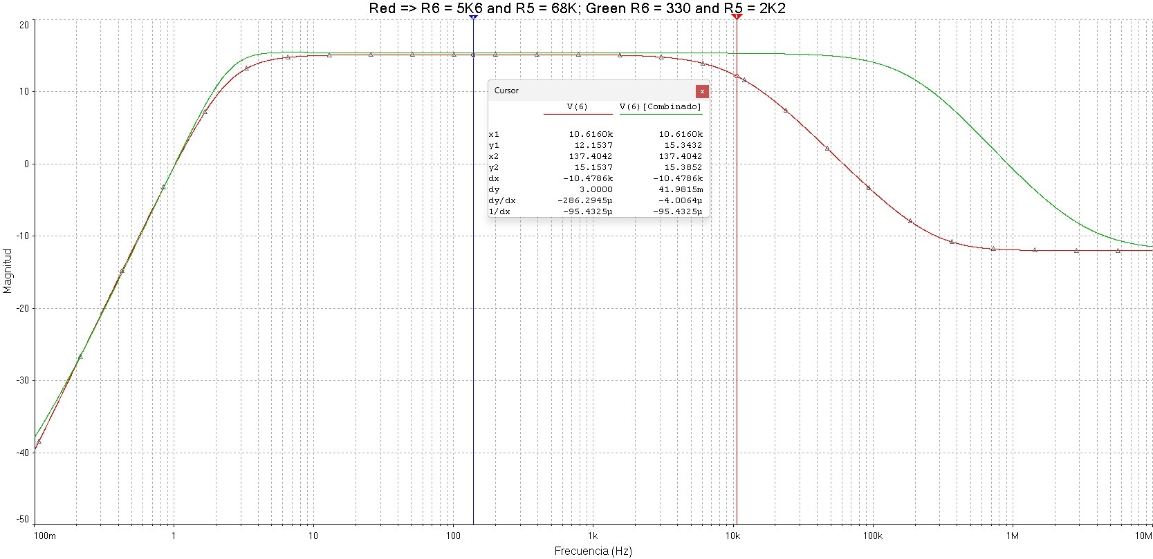

Let's go with 5K for R6. What value would you suggest for R5 and could you explain how you calculated that value?Lovely design!
My only suggestion is to increase the feedback resistor values. Currently the input impedance is 330 ohms. A little low. You can easily raise it to 4-5k, scale the 2.2k accordingly and then most SS preamps will drive it fine.
ray
To choose R5 and R6, I considered that the amplifier had to be useful as a desktop one, due to its limited power. As today it is very common to have a laptop, notebook or desktop PC, I considered it appropriate to operate it from any of them, through the headphone output. This is why the relatively low input impedance should not be a problem, as many outputs are capable of handling 32 ohms with ease (whereas this amplifier has an input impedance of around 350 ohms).
In any case, for those who wish to modify it, they should consider that the frequency response (mainly the high frequency) could be significantly altered. The distortion profile will probably be altered, so it should be checked if it is still useful in how it is altered.
I show you how the frequency response would be altered by taking other values for R5 and R6, maintaining similar gain within the passband.

What if R6 is 3Kohm, what would be the upper -3db frequency ?
Thanks Diego
I believe I’ll go with let’s say 3Kohm for R6 and a slightly lower overall gain, maybe 12 dB just to increase slightly the bandwidth. Can I disturb you on more time to see the -3dB with the above? TIA
With R6 = 3K3 and R5 = 18K => Gain = 12.38 dB aprox.; fcs = 24323 Hz at - 3 dB
With R6 = 3K3 and R5 = 15K => Gain = 11.36 dB aprox.; fcs = 26739 Hz at - 3 dB
Best regards

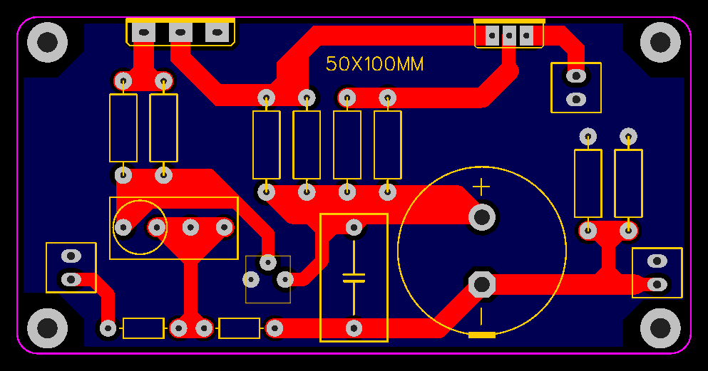

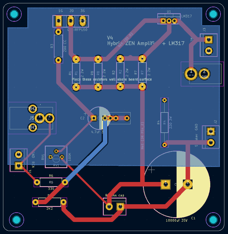

Here is the latest version. I will wait a couple of days for suggested corrections or improvements and then post the Gerbers. I will have my laptop so I can make changes.

You are better at this than I am. Still, I am doing better than my original efforts.
Ray
Ray
No need to worry!!! There will always be a worse one, whatever it is. I am a total disaster at designing PCBs. I don't even qualify.
