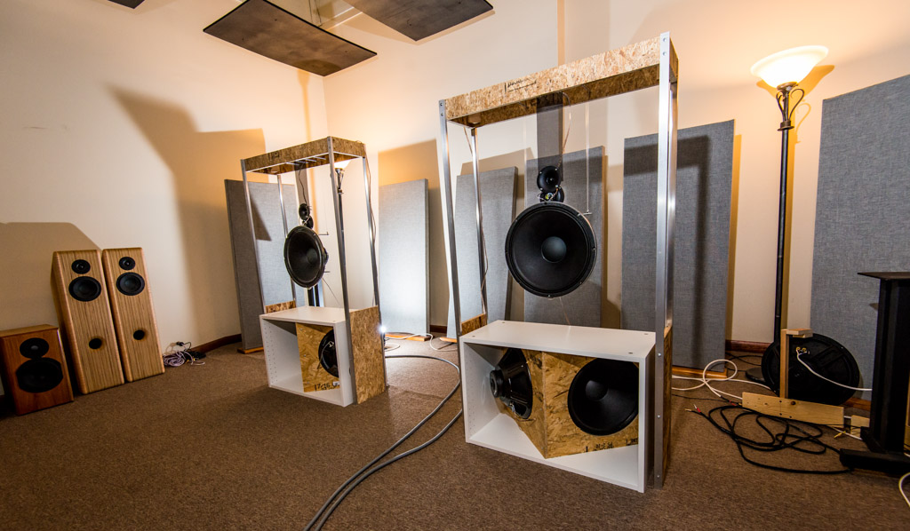

I am one of the proponents of nude drivers. Let me lay out my argument(s) for this, and my approach to designing the speaker.
First, I want to have the same radiation to the front and rear. This has its roots in the idea (from Linkwitz) that the tonal character of the "room sound" (all the reflected energy from all non-direct axes) should be as similar to the direct sound as possible. To me, it is not enough to just beam some HF out the rear (like with an added tweeter) but that the front and rear should be as similar as possible. You could listen to the rear output facing out and the speaker should sound the same. To me this requires a dipole tweeter - a planar tweeter or perhaps this two-dome dipole I came up with. These are able to operate down to about 2kHz where they need to be crossed over to the next lower band.
If we can get down to 2kHz with the tweeter, then we need to get up to 2kHz with the midrange. Again I want to have front and rear radiation as similar as possible. At first I bought a bunch of 4"-5" class drivers but I found they had a sharp dipole peak around 1k-2kHz and the rear radiation was often doing undesirable thing above that, possibly due to small basket and proportionally too large a magnet structure. Eventually I worked my way up to testing 6", 7" and even 8" drivers looking for something workable up to 2kHz. 8" and most 7" drivers are starting to beam too much by 2kHz, making them not suitable. But I noticed that the larger the driver, the broader the dipole peak and often the rear radiation was not getting as ugly above that. In the end, I found that if I used a 6" class driver nude, I could get the response I wanted/needed. The nude mounting was needed to put the dipole peak as high in frequency as possible. While this was not quite up to 2kHz, the off axis responses remained relatively controlled and similar to the on-axis response up to 2kHz or even 3kHz.
Moving down in frequency, it's a matter of how much SPL you want to get out of the midrange that determines where it needs to be crossed over to the woofer. The lower the crossover point, the higher the dipole losses. But a 6" class driver can operate nude down to around 500Hz with relatively low (e.g. -6dB WRT the closed box SPL) dipole losses. Given that, a driver that can work up to 500Hz is needed for the woofer.
Because of high dipole losses, unless there is a large front-to-back pathlength the woofer is not going to be able to work down to e.g. 30Hz AND up to 500Hz. In my opinion one of the sources of the "magic" of the musicality and wide and open soundstage of a good dipole system is that the rear radiation can reflect off of the front wall and come back to the listener freely. But a large planar baffle gets in the way of that - it has an appreciable acoustic shadow. If you use a small enough baffle to minimize acoustic shadowing, the low bass is anemic or requires too much power/displacement. As a result I choose to operate the woofer only down to 100Hz or 80Hz or so. This significantly eases the driver requirements for this band, so much so that you can just use a high sensitivity nude 15" driver. There will still be some dipole losses at the low end, but the high sensitivity and relatively large Sd mostly offset these.
Below 100Hz I can use a dipole sub or transition to closed box subs. The former is good for larger rooms and the latter for smaller ones. The biggest challenge for me is how to construct a speaker consisting of all nude drivers with little to nothing there to hold them up.

For the lower midrange, 200 - 600 Hz, I'm currently playing around in Edge/Basta with different baffle shapes and dimensions for use with a 10” or 12" woofer and I have a few questions:
1. Are there any advantages in using a 10” or 12" in a small baffle for the lower midrange versus a nude 15" woofer (e.g. Eminence DeltaLite II 2515)?
2. Would a high efficiency nude 12" woofer (e.g. Eminence DeltaLite II 2512) provide similar performances as a nude 15” woofer to bridge the gap between the 18” H-frame and the SB17?
Also, and since I kind of have a fixation on MTM configurations with a ribbon (damn you GoldenEar Triton’s), what are your thoughts on a system consisting of a GW-1858 in a flat or U-baffle, nude SB17CAC and AST2560 in a MTM configuration?
Is the jump from an 18” woofer to 6” midrange MTM too much? How would the dipole radiation be impacted?

I own, and measured, a pair of the Deltalite 2510 (10" version) and it actually has some defects that are not present in the 15" version (2515) response. I haven't owned or measured the 12" 2512 so I am not sure about it only to say if you look at the MFG curves the impedance has too many lumps and bumps below 1k to make me comfortable.
If you want to go the MTM route, I think you could use two SB17CAC's above the H-frame with the 18" Goldwood provided that you design the H-frame shallow and wide enough that the 1/4-wave resonance is at 300Hz or above, assuming you will cross over at 250Hz to the SB17s. This won't give you much bass augmentation, but you can't have both at the same time with an H-frame. You could explore the option of a stuffed U-frame. It might work better under the MTM, actually, and because the driver is on the front panel there is no resonance there. Also for comparable bass loading, a U-frame only needs to be half as deep as an H-frame. For more info on that see:

Another note about this:
One issue with H or U frames is the possibility of positioning a flat surface adjacent to the other drivers. For example, if you put the 18" driver in an H or U frame with the MTM above, the lower "M" will be close to the top surface of the 'frame. Since the U/H frame is typically built with a square cross-section, its top is a flat, reflecting surface that is close to the mid driver and might cause some problems.
One potential fix for this is to build the 'frame using an equilateral triangle for the cross section. A little more complicated to build, yes. But from the viewpoint of the lower "M" driver, there would no longer be any flat surfaces that are perpendicular to the driver. Instead they would slope away at 60 degrees. I haven't thought about building a system in this way until now, but it makes sense and I might just try it myself.

Stupid question, isn’t having the 15” woofer suspended above the M-frame causing problems?
