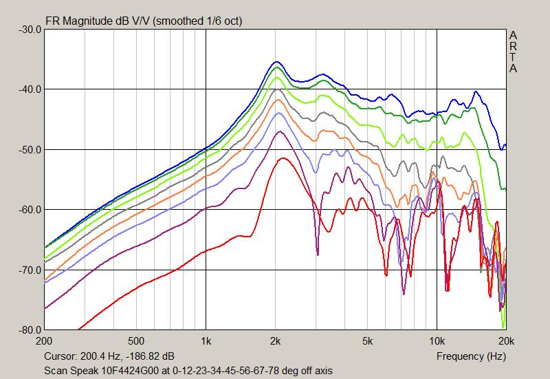

I looked into the 10F several years ago, when I thought that smaller drivers would be best for dipole midranges. It's an excellent driver all around, and not bad as a tweeter used as diypole suggests. You will definitely need to take the response into account, as 1kHz is just below the dipole peak and it's changing fast in this FR region.
I have attached the on and off axis responses I measured for the driver, nude, from the front. Unfortunately I no longer have my rear response measurements, but I recall that there was a significant deviation from the front response starting just above the dipole peak. Most drivers deviate to the rear in this region, and the 10F was just not what I wanted at the time. It would probably work just fine, nonetheless. The sharp dipole peak was another turn off, although it can be tamed a bit with EQ. Unfortunately the peak shifts in frequency as you move off axis, so you can't really "fix it" on all axes.
These days I prefer something that is a little smoother in the 2kHz region, and/or wherever I want to cross it over, and I find that drivers in the 6" class are best in this regard. That's why I suggested the SB17 as a dipole mid.

Yes, the dipole peak is dealt with in the 1000hz crossover.
It is also tamed with a baffle, the nude response is the worst case scenario.
How large/wide of a baffle did you use for the 10F? I would be interested in seeing measurements of how that influenced the FR on and off axis. I imagine the peak broadens and the peak frequency decreases. That would make a 1kHz crossover much easier. Can you share data on that?

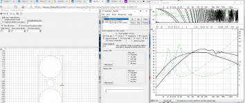

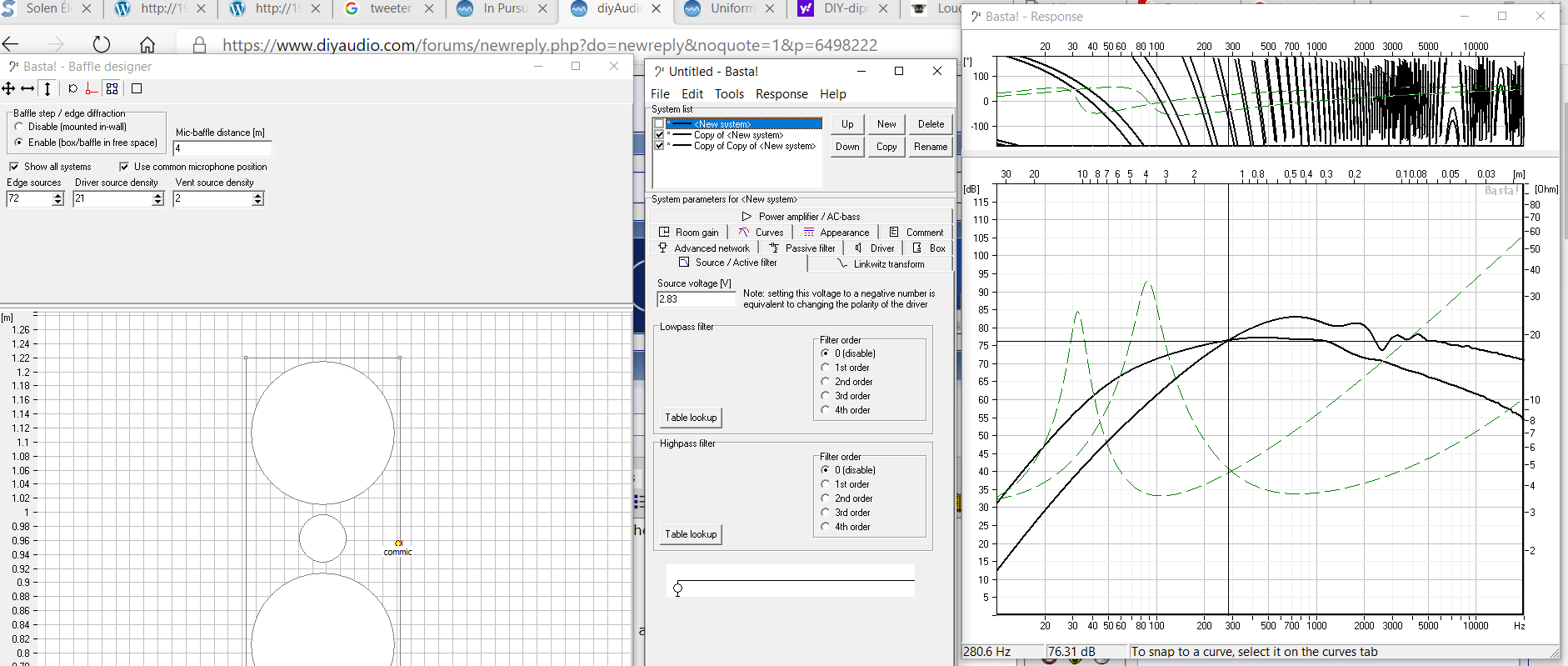

I simulated a MTM using the 830668 and the 10F/4424G00.
The baffle is W8" x H20".
No crossover applied.
The microphone is set 4m away and offset to get 30 degrees off axis.
I'm trying to attach the screenshot of Basta, but I can't load directly from my PC.
Hello Charlie, I can dig that out for you when I get home. The best I can do is direct you to the open baffle gallery for now, about 3 or 4 pages from the end I posted the speaker and the measurement.
Have to give credit to John K for figuring out the magic of the 8" to 4" minimal baffle. The 8" is run below the null and peak, and with a crossover at around 1000hz, the peak of the 4" can be dealt with in the crossover. Linkwitz did not want to go 4 way, but after he experimented with it he came to the same conclusion.
I use hardly any baffle...not even a half inch on top, but squared a bit, and expanding below to the 8". Worst case scenario is that the sound is reaching all edges at the same time, as I'm sure you already know. Change it a tiny bit and you reduce the ripple, same as regular diffraction in a closed box.
I still maintain symmetry in the horizontal plane. It does flatten and broaden the peak a bit, and it's close enough to the crossover point that you simply address it with the crossover.
