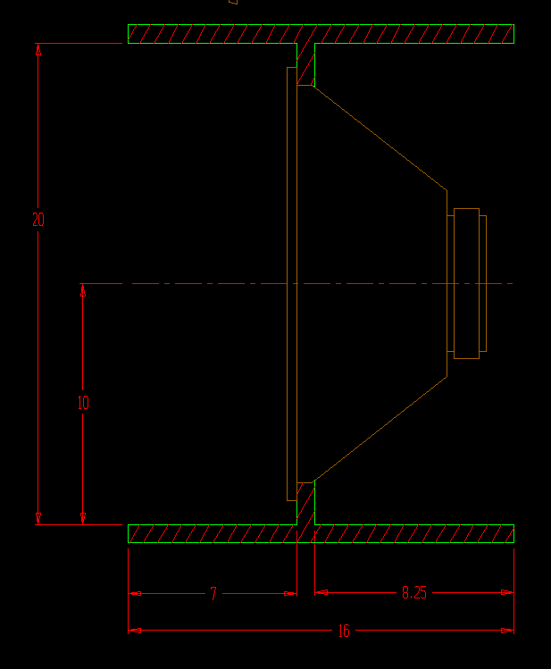

Here is a stupid question, when simulating an H baffle in Basta (i.e. a flat baffle with wings extending both front and rear), I unfold it to be a flat baffle, but how do I determine the overall baffle width (i.e. acoustic distance)?
Taking the attached drawing as an example:
1. Is it simply the sum of the main baffle plus the overall length of the 2 wings: 20+16+16 = 42"
Or
2. The sum of the complete linear path from the acoustic center of the driver: 20+20+16+16+8.25+8.25+7+7 = 102.5"

Should be 1 but keep in mind that the baffle (unfolded h-frame) is not equivalent to the h-frame not only due to the resonance.
That said it should give you an idea at least.
I do the same thing in Basta as I don´t have access to the mathcad sheets of Martin King.
