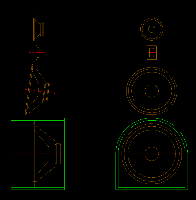

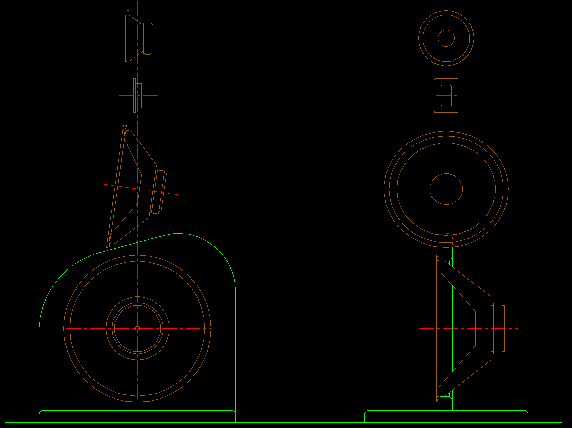

I drafted a quick 4-way solution with the same drivers as before, GW-1858, Deltalite II 2515, SB17CAC35-4 and AST2560.
I had to place the SB17 above the tweeter to keep this one at a height of 40".
The baffle holding the GW-1858 is 1.5" thick.
Not shown is the 4 post structure from which the nude drivers are suspended.

Getting back to your question, with crossover points like 80Hz or 100Hz, where the wavelength is around 4.3m and 3.4m, you can have an offset of several centimeters and it will be OK. For example, 36 degrees equates to 40cm at 80Hz, and 34cm at 100Hz.
In the draft design above, I estimated the acoustic centers and manage to line them all up, but only by putting the SB17CAC above the tweeter.
Why orientate the woofer like that? The null is pointing towards you.

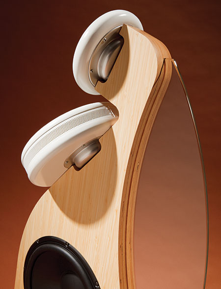

I was just trying to see if the configuration shown in the commercially available speakers in post #113 could made to work with the drivers I plan on using AND keep the tweeter between 38" and 40" off the ground.

I have always looked at that design with the woofer rotated so that the 90degree null points at the listener with surprise. I suppose this is an example of how important the "room sound" is, because that is probably what is dominating (over the direct sound) assuming the 90 degree off axis null is 20dB deep. Why do that?

If you want to save a few vertical inches, you can reverse the orientation of the woofer (lowest band driver) by 180deg so that from the listening location you are looking at the magnet. Then you overlap the mounting flange of that driver with the driver in the next higher band. This works because, for low frequencies, the output from a woofer is symmetrical, e.g. essentially a true dipole. So you can use the driver either way up to 300Hz or so.

Jorma had switched to shooting for a cardioid in the midrange on the design with the tilted white foam baffle. I don't remember the exact details, as it's been a year or ten, but that is a shallow, wide enclosure made of different densities of foam.
As someone who has built and sold quite a few speakers, I have to say that there is also the aesthetic aspect consideration in a commercial design.
Compromises are made, you have to sell speakers. Turning the baffle and extending it with glass allows for a very wide baffle to support the low end capabilities, while giving a dead sexy narrow front profile that the wife will allow in the room, without forcing the buyer to sleep in there with it.
And cost is a thing too. A very important thing if you want to stay in business. If that mid was a true dipole, it could never reach down low enough to cross with that woofer at a frequency that would not have major beaming in the woofer.
And if you don't have a room where you can keep a full dipole speaker well away from the back wall, the mid-highs can get very hot off the wall behind. As an aside, the depth of that baffle actually means they can't shove it right up the wall also, and that will sound better in and of itself regardless of design.

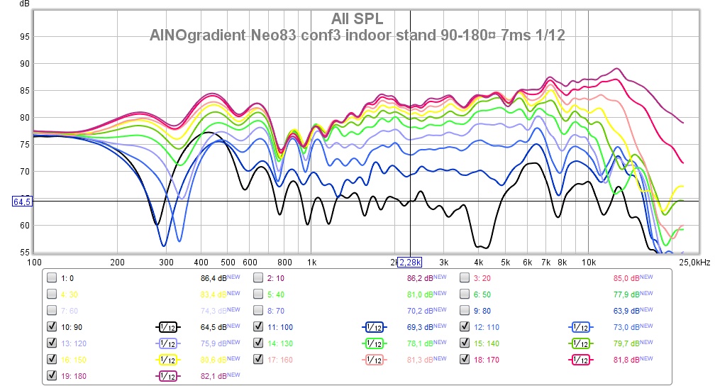

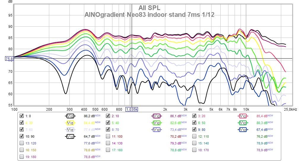

About timing and aligning acoustic centers - with multiway dipoles it is almost impossible to get perfect match at 0 and 180deg. It can be done with planars, but harly with cones or mixing cones and planars.
I searched my measurements of AINOgradient and studied them with different time windows, but various reflections and differences in dsp settings make analysis tricky. Anyway, I decided to optimize frontal response in matching 12" low mid cone and planar upper mid around 600-800Hz. LR4 slopes give prettier measurements but still I prefer the sound of LR2. Perhas because of less group delay ove xo and smoother vertical response...

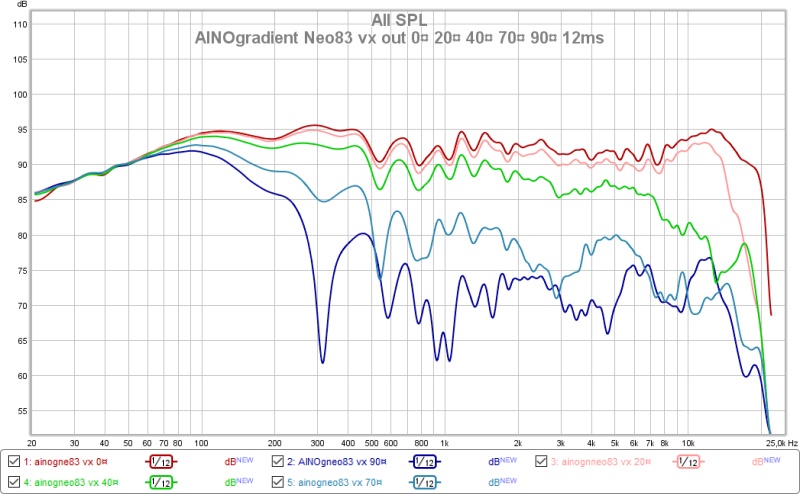

Here some in- and outdoor measurements - more in the thread found in my signature.

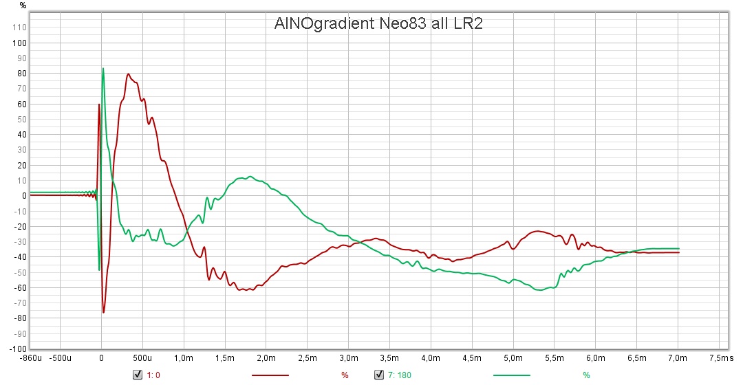

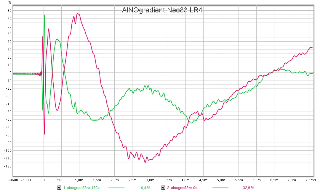

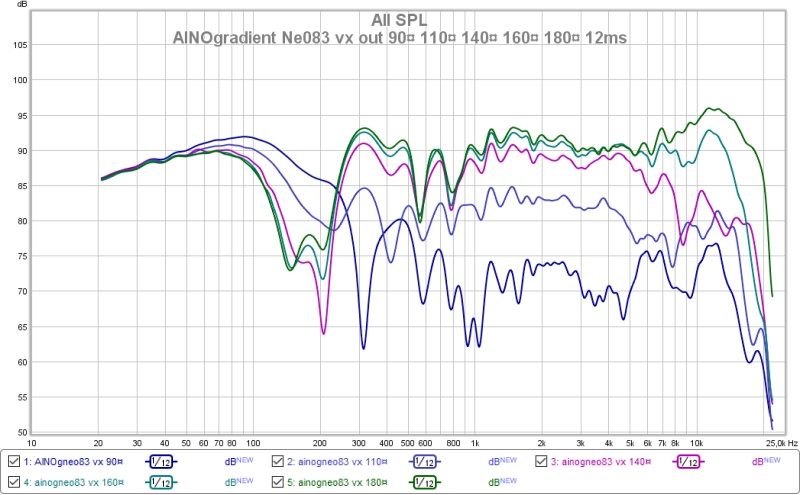

And step responses 0 and 180 for LR2 and LR4 crossovers. Notice the 180deg irregularities and bend in step at cardioid response. Backside responses green. Same measurement series as in previous post.
So, for a 4-way dipole, LR2 is preferable for all drivers, but what about BW3?

No rules! With DIY you are free to try everything, just try to understand what and why you do, and learn more from experiments. I think measurements are most important, but when all basics are in good form, final touches in sound are subjective. And there is always something left to make better...
