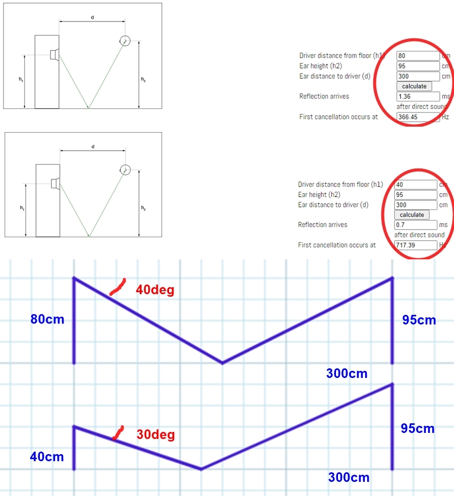

Still about floor reflections...
Dipole response will be substantially lower only at 60 deg or more off-axis. Here sims with listening distance of 3 meters and rough estimate of angles when radiator is at 40 or 80 cm height. Tilting of the mid is a way ot enhance reflection minimization - Jorma Salmi was a smart guy!
Looking at this explains the 3 way with woofer closer to the floor concept.
Cross the mid at 300hz or slightly above to minimize or eliminate it's floor bounce.
Lower the woofer enough that it's working well under the frequency of it's floor bounce.
But from my understanding, the floor bounce seems to mainly affect the midrange (i.e. 300+ Hz).
Therefore, in a 3-way system, the woofer is placed close to the floor for LF reinforcements, and the midrange is above the latter, and hopefully higher than the aforementioned 40 cm, which should be sufficient to be above the 60 degree off-axis for floor bounce, unless I totally missed something on the subject!?!

In theory, if a driver cannot be positioned with sufficient height to not suffer from floor bounce, couldn't a solution be to place a 3D diffuser at the point of bounce to help with the issue?
When I made that post I surmised that Juhazi's sim would come through with the quote, but it did not.
This is what I was referring to...with the mid at 80cm bounce is around ~300hz and at 40cm it's pushed up to ~700 range.
I've seen many designs that go three way, lower the woofer, and cross the mid above where it's bounce is located, while the lowered woofer is operated below where it's bounce is located.
I see that now, the higher you go with the driver in relation to the listener, the lower the frequency null caused by the floor bounce get, hence get the driver high enough that the null is outside of the selected frequency range (i.e. crossover points) of said driver.
This being said, where can I find the calculation formulas behind that schematic you attached? I am now curious about the placement of the drivers in the 4-way layout I'm currently planning.

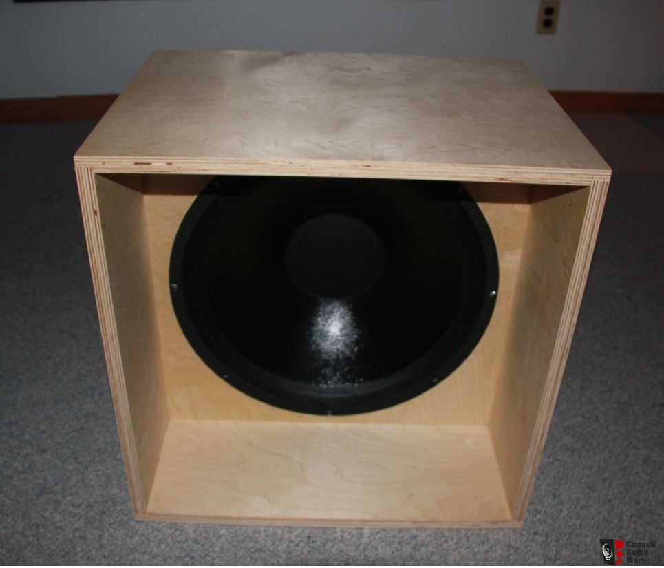

I have a question on open baffle bass using a GW-1858 18" woofer since Basta/Edge can't simulate H-frames (at least to the best of my knowledge); what would be the bass response/extension difference between a complete H-frame subwoofer vs an H-frame with no top panel (see attached photos) if they have the same overall dimensions (i.e. 20x20x16" internally)?
MJK did a full case study using a GW-1858 in an H-frame of the dimensions above (http://www.quarter-wave.com/Project08/Jordan.pdf), but I can't find measurements of the same driver and H-frame size that doesn't have a top panel or of any other driver in an H-frame with and without a top panel.
D
You should be able to model the LF response of your H-frame without top as a planar open baffle with an equivalent front to back pathlength. But in addition there be a resonance formed by the remaining "sides" of the H-frame even though the top is missing. This is best found via a measurement at what would have been the plane of the H-frame opening, e.g. in line with the edges of the two side panels, and in front of the woofer. I don't think there is a modeling program for that exact geometry.

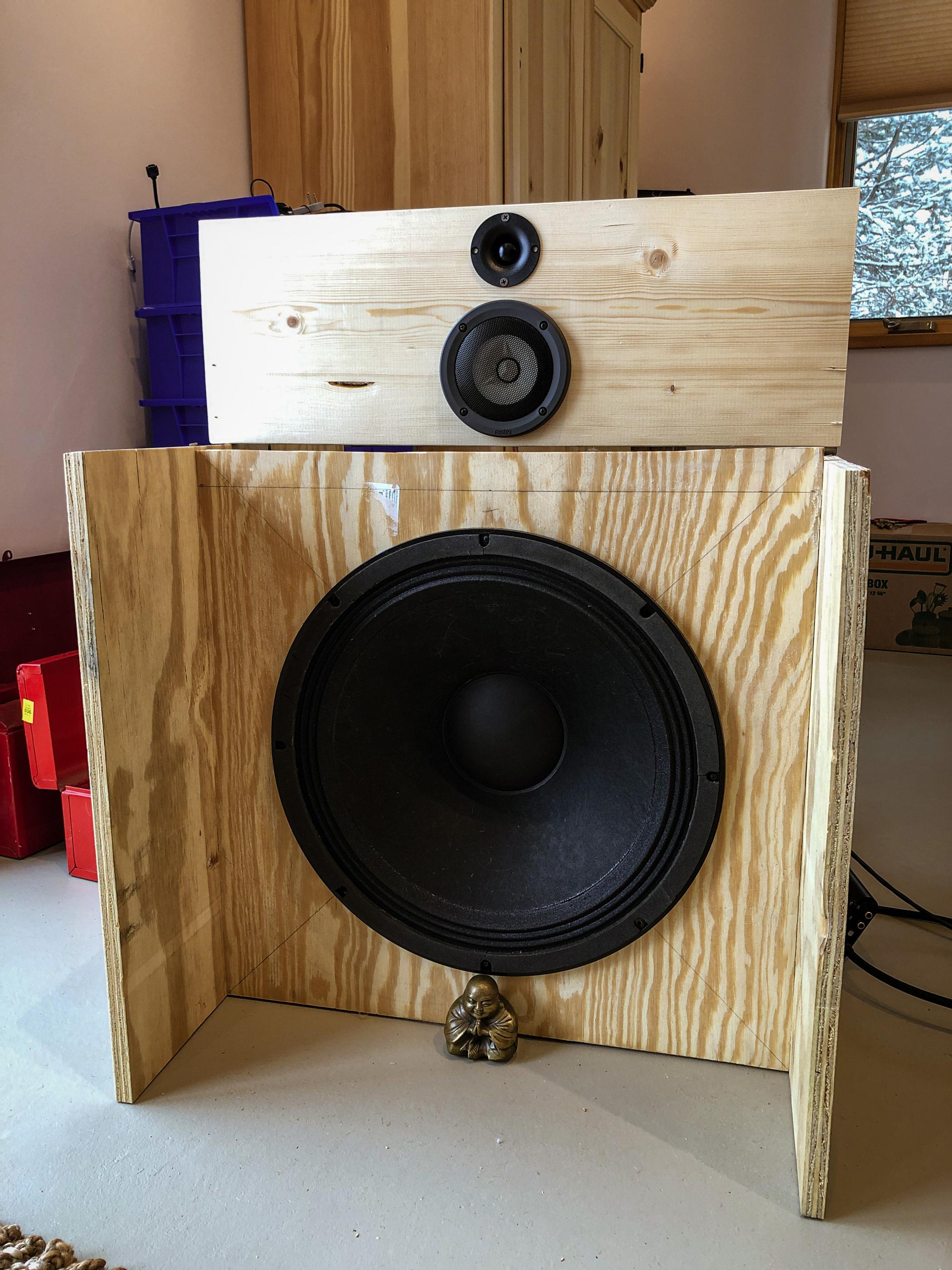

- Hybrid H-Frame, OB and nude driver
