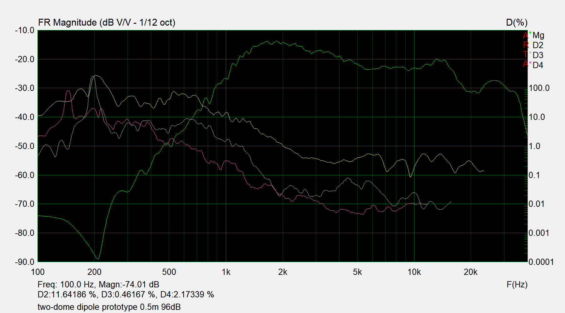

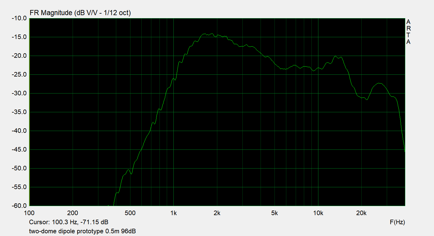

I was trying to make a dipole out of two domes so I didn't try to use two ribbons. A good dome has less distortion compared to a ribbon anyway, at least in general. There are exceptions, of course they are the expensive ones!
I used two Dayton ND25FW-4, back to back. These are inexpensive neo motor 1" domes in a small waveguide. The motor is quite small, and you can nest the motors to make the pathlength as small as possible. This does require them to be offset, so the pattern is not 100% perfect in that plane, but overall is very close to a dipole with CD responses for the most part.
Surprisingly for such a low cost tweeter the distortion remains pretty low above about 1.5k-2k Hz (see image below). The response shape when two are used back to back has a hump around there and falls off as you go up in frequency, sort of like what you see with CD drivers on horns (see image below). Front and back on and off axis responses can be found in THIS POST. The performance is pretty good, all in all. I even used them crossed over around 1.6kHz to that Deltalite 2515 (nude) and it worked! I surprised a lot of people at a DIY event with that speaker!
886679d1603395364-measurements-nude-ribbons-dome-dipole-dome-dipole-prototype-fr-png
886685d1603395537-measurements-nude-ribbons-dome-dipole-dome-dipole-prototype-quick-distortion-png

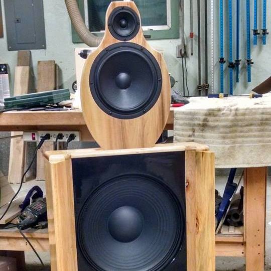

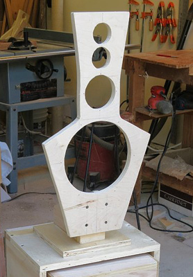

Here is the build I was referring to, done in 2017. As you can see, not much baffle at all, just enough to make it solid and mitigate dipole/diffractive effects.
Can't seem to locate the outdoor measurements I did, but I have the last one I made in my shop before I sent them to their owner. No gating, 500millisecond default setting in REW...all room reflections in there as can be seen starting in the midbass, 1/3 octave smoothing.
I believe our design goals are the same; uniform polar response for 360 degrees.
Linkwitz would never have used a 15" because of beaming, but as you have found, the problems with dipole baffles relate to their size relative to the driver, and so using as large as possible a driver that will not beam at the top of the range you intend to use it makes things much easier and requires less equalization.
I wanted to use the 15" all the way up to 150hz, and so I made a baffle with 2" thick sides but open top, and tapered the sides so that there were no parallel surfaces or cavity to resonate.
A 150hz wavelength is around 7.5 feet long, so a baffle like this is not obstructing any rear reflections at those lengths.
The average size domestic listening space does not have room modes below 50hz, and those frequencies are not heard but felt, and omnipolar. My goals for dipole are to get down to 50hz, and below that I use a sealed sub, which can also take advantage of room gain while the dipole cannot.
In the interest of keeping cost down for the customer, design trade offs are made. In this case, I really could not hear much of any difference with or without a tweeter. I have used neo 3 before, and they work well. But in this case the 10f worked stellar and I decided it was not worth the extra expense to add a tweeter. In fact, the 10f has better off axis response than many tweeters I have seen.

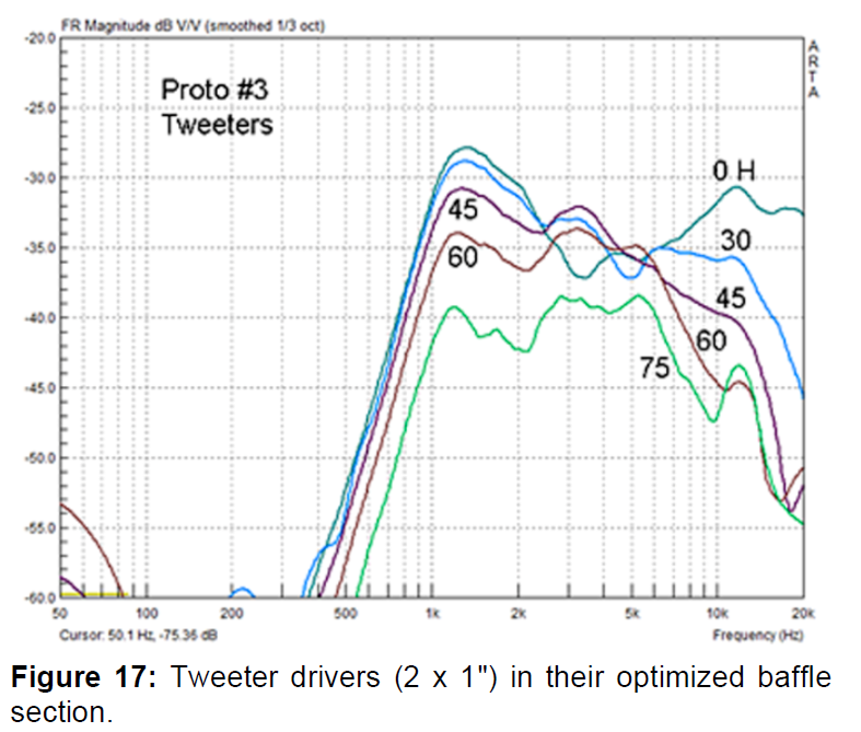

If you try to place the tweeters so that the two domes "line up" on a single line/ray, the heatsinks on the back of the motors makes the separation distance so large that the pattern breaks down. To get around this, I slightly offset the tweeters so that the motors and heatsinks are sort of next to each other. In the pic of my system you can see that one tweeter is above the other, while being hung from above. In the horizontal direction you get the response I linked to. In the vertical direction the pattern breaks down a bit because of the offset, but it is not bad.
Siegfried wrote and published an article about the LX521 development. I have the attached figure from it on my desktop, which shows how his tweeters performed on and off axis. You can see why he did not want to cross over at or below 5kHz - the pattern is bad. I don't see that kind of problem with my own two-dome dipole, and I think it is partly due to the waveguide (and also some good luck!).

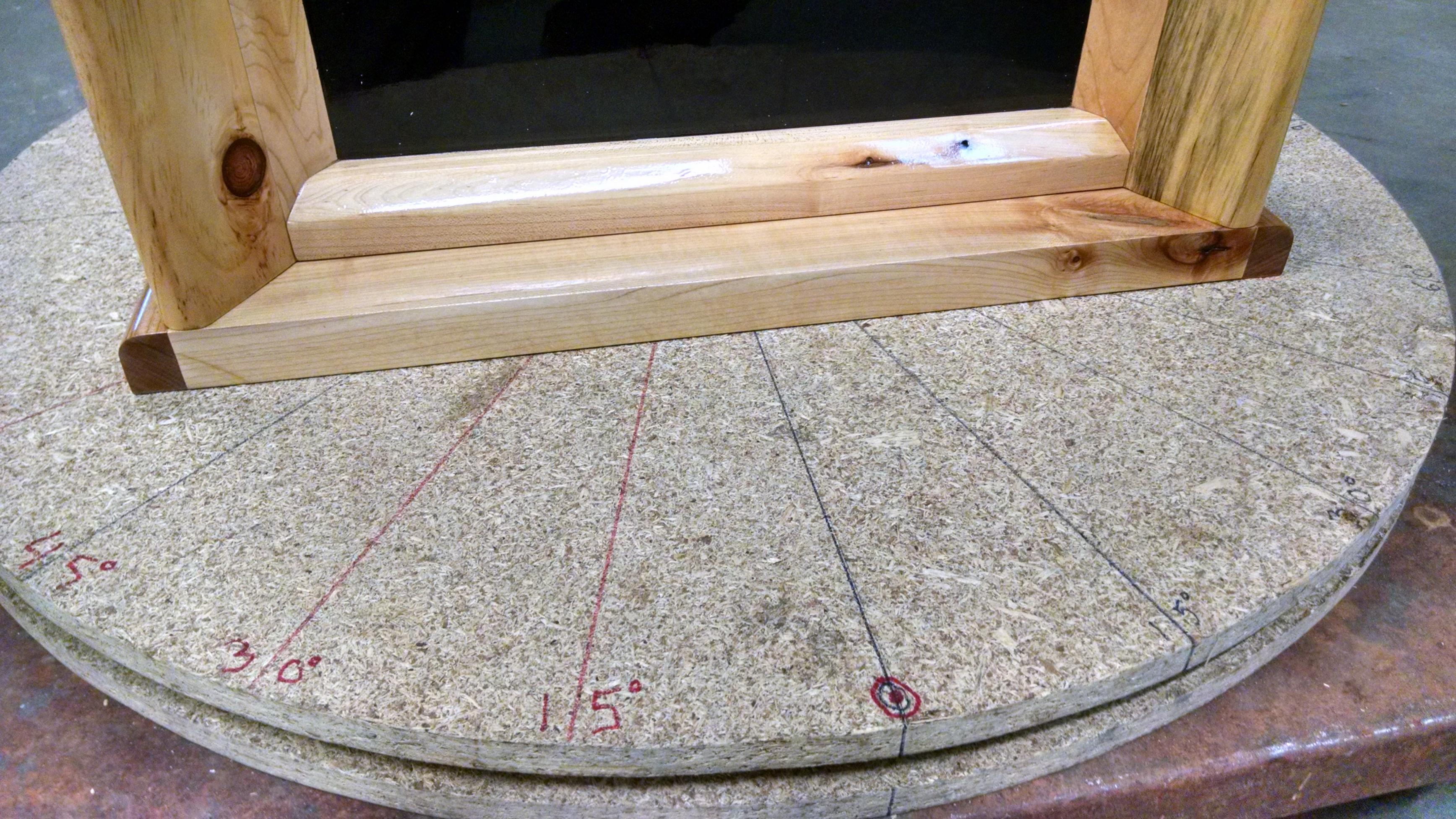

I guess I actually did that build in 2016 lol the older I get the worse it is. Found another picture in the cloud that better shows the taper of the sides I was talking about.
On top of the mondo huge carousel I had to build to measure them.
Cheers!

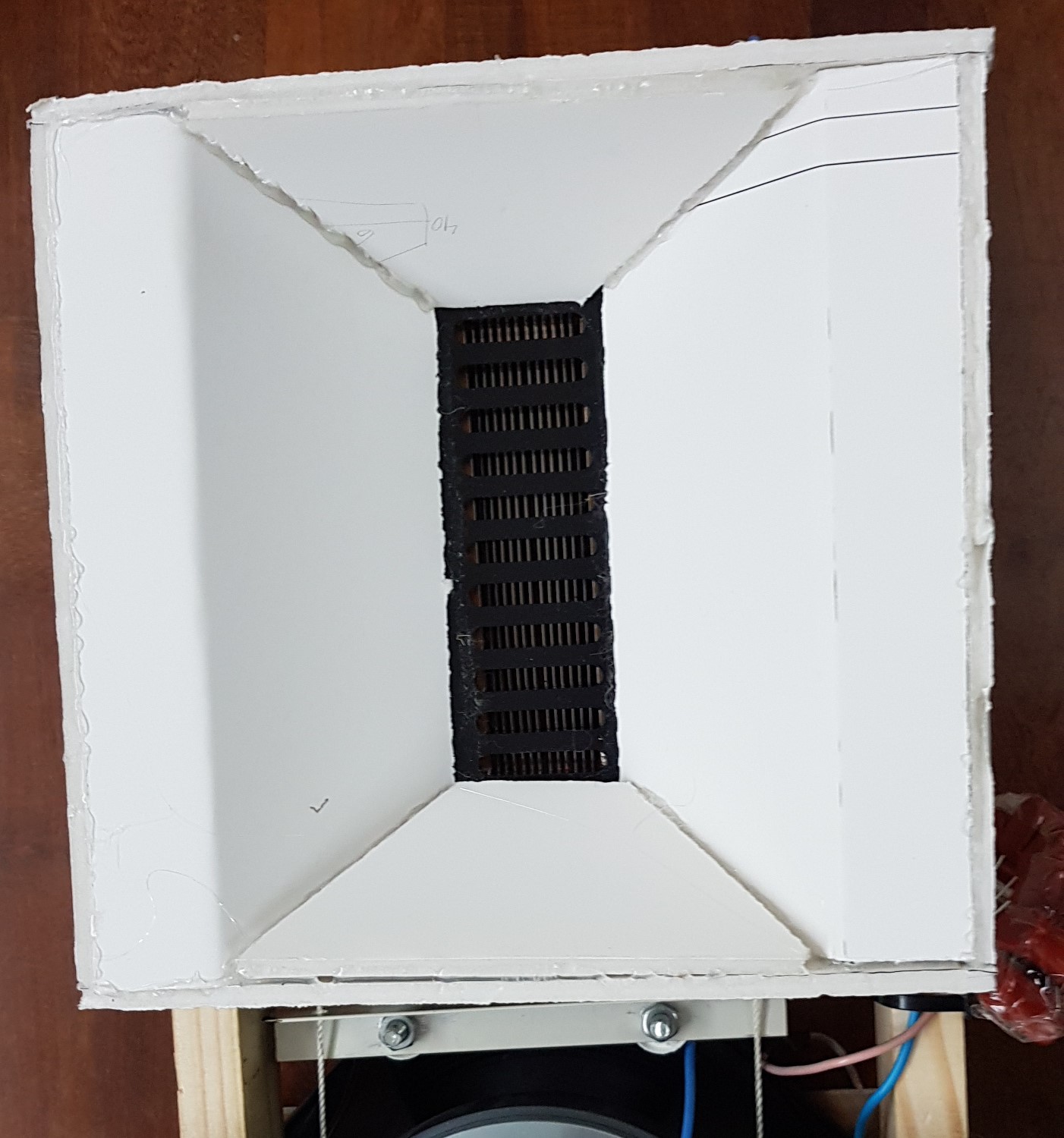

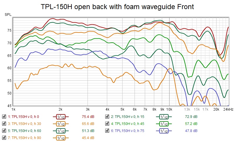

I'm also experimenting with dipoles. Thought I'd share my experiments with Beyma TPL-150H open back, with a back waveguide as proof of concept and corresponding outside measurements.
Tweeter was 2.2m above a hard floor, with no other nearby surfaces.
Front measurements 0 to 90°, every 15°, with a protection cap at 1.1kHz approx:

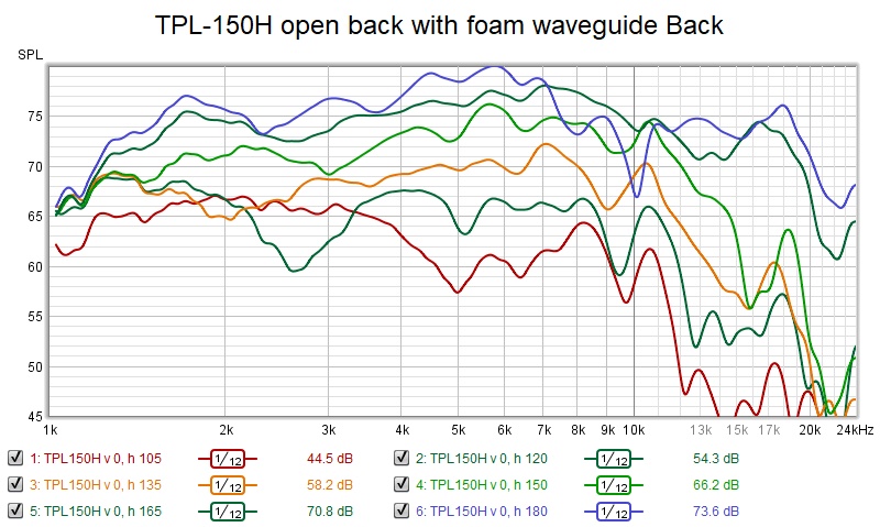

I assembled a simplified foam wave on the back, with similar depth to the Beyma waveguide:
These are the back measurements, 105 to 180°, every 15°:
Seems response is fine above 7kHz, which was mentioned as a threshold for meaningfulness for the back wave.
I'm crossing this to a nude 8" midrange. Still to experiment with baffles. Oval, per diypole is certainly on my list.
My experience is way more limited than others here, but have to say this is sounding good. Earlier tried the TPL with back cover on, then open back without waveguide, now with waveguide.
Hope it helps as food for thought!
