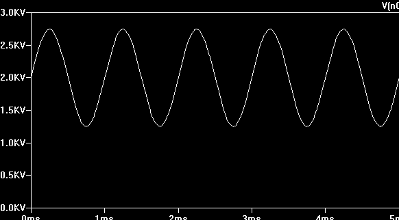

Forgot to mention it should be suitable for class A operation. I need to produce output that looks something similar to the attachmed graph.

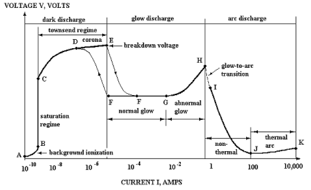

Anyway, you can see the I-V characteristics of my load in the attachment. It will be in the region F-H. Sound compression wave generated is approximately proportional to Power input, but in the F-G region this means essentially current input. Class A is efficient driving this since the bias goes towards maintaining plasma power and is not wasted. This is single ended since the rarefaction wave depends on the thermal relaxation constant of the plasma and not the amplifier.
What I said about the zeners is because I have seen region F-G simulated in SPICE using zeners.
I don't know whether I'm going to have an F-G or G-H type discharge, because I don't have a finalized electrode configuration. Is it possible to have an amplifier that will drive both well?
The medium is gas. The graph shows the I-V characteristics of an electrical discharge between electrodes. This graph is more applicable to low pressure discharges, but it is similar enough to my case of using atmospheric pressure air (Hill's Plasmatronics also were atmospheric pressure glow discharge tweeters, but used helium plasma instead).
BUT THAT DOESN'T TELL ME ANYTHING!!! :cannotbe: :cannotbe: :cannotbe: :cannotbe: :clown: :clown:
Ok... No idea exactly what it is, though, nor at what pressure/temperature?

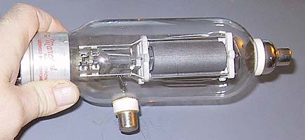

The 810 should do the job nicely. This is like an 805 on steroids and has a grid cap on the side as well as a plate cap on the top. Graphite plate good for 175 watts PD and 2500 volts on the plate is the CCS DC rating IIRC.
The 810 is a lovely looking tube -- like an 845 on steroids -- one of these centuries i'll find a use for the pair i have (but only if i can make it work with less than the typical voltages, those are totally scary).

Sch3mat1c[/i] BUT THAT DOESN'T TELL ME ANYTHING!!! ... Ok... No idea exactly what it is said:

In any case, my question regarding the picture I posted remains unanswered. Is it reasonable to build an SE class A that will drive a load behaving as in the glow discharge region of the graph in either the normal or abnormal subregions, or would different designs apply to each subregion?
