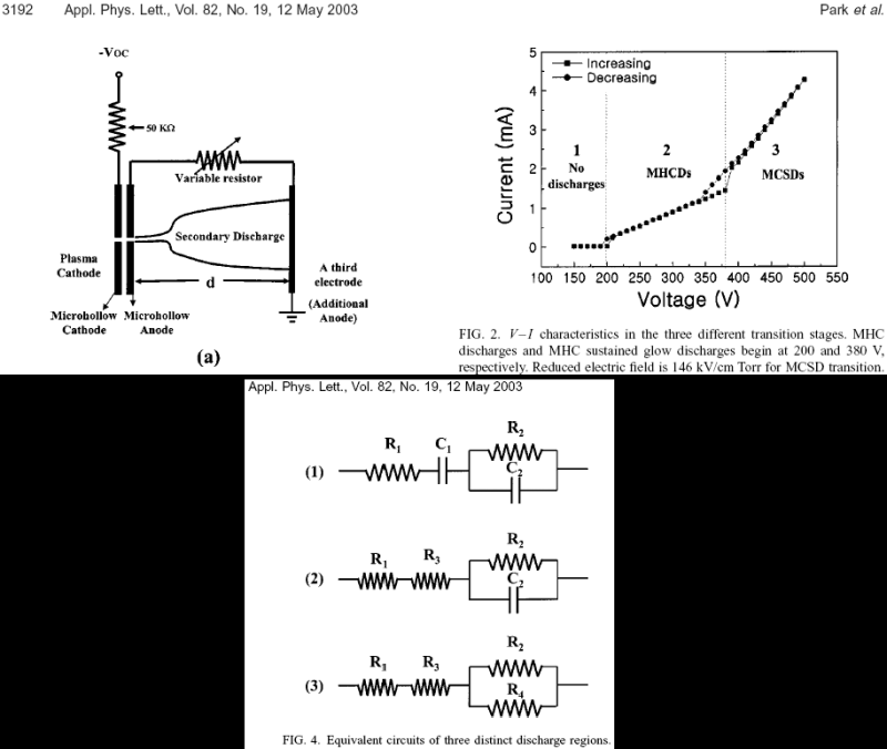

OK. For reference again the graph is here.
In the constant voltage area, the amplifier essentially acts as a AF modulated current regulator. I was under the impression that voltage-in-current-out amplifiers are called transconductance amplifiers. I haven't found any information on audio use, (after all this is not a usual type of load). In SPICE simulations, several common audio amp circuits I tried completely fail to drive this. To simulate this load in SPICE I used an idea from some website dealing with simulating a spark gap:
I only used part of this circuit, the glow simlulating zeners, as the rest is not applicable here.
F-G occurs because increasing voltage in that region makes the discharge use more area of the electrode. If I make the electrode sufficiently small, then it becomes an abnormal discharge (G-H region), which I'm not sure how to represent as a load in SPICE.
I'm still experimenting with electrodes, so that's why I was hoping I could have an amp for experimenting that will work in both conditions.
Now take a look at the attached image (source can be seen in upper left). On the left you see their setup. The use of the microhollow cathode discharge itself as a cathode allows a large volume atmospheric pressure plasma to form which is much more stable and less likely to transition to an arc than if a simple cathode were used. The graph's third section shows that the load becomes essentially resistive in that region.
It is not clear to me, however, if Hill's result (as described in his patent) that short-duration input power variations result in proportional pressure variations, making this useful for sound reproduction remains true here, in the sense of how linear the relationship is. Using power supplies for the MHCD and the MHCD sustained discharge may be better.

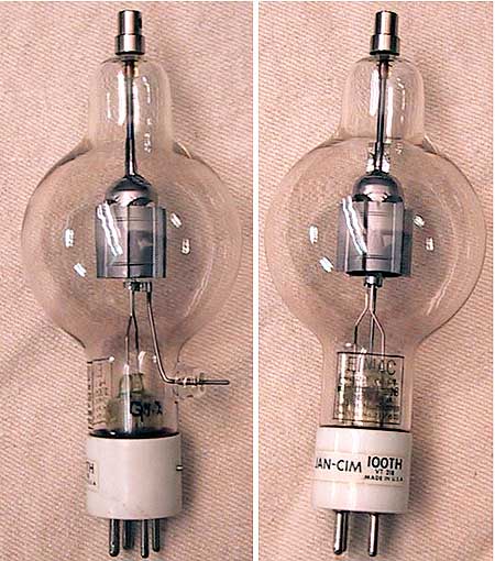

My favourite tube for huge amplifiers is the 100TH triode. Its a bonza of a tube designed for RF amplifiers in the 1940's, works well at audio, and looks great when lit up - very impressive with a top cap for the anode and a side connection for the grid.

If I want the audio frequency output to vary over a limited range of the total bias, say a few hundred volts amplitude centered around a 2 kV average, can a tube with lower dissipation be used (to save money)? For example, say the base plasma power is 400 W, with an additional 100 W going into the audio frequency modulation. What's the minimum wattage rating of the tube needed?
You're in class A (constant average current, constant voltage if it doesn't turn to arc) so dissipation is constant. Loadline is perfectly vertical (which begs the question of how power output is obtained.. I'm going to guess a difference in power due to changing size and thus radiating sound, of intensity which pales in comparison to average power consumption of the discharge, hence you wouldn't notice it on the loadline). Yes, you're operating on transconductance.
So to sum up, tube dissipation depends on idle current times idle voltage, plus a little extra for arc protection or something.

Take a look:
Power variation creates pressure differences, as long as the variations are small enough not to give time for the plasma to equalize pressure with surrounding air (and increase volume instead, by ideal gas law). The use of microhollow discharges as cathodes removes cathode fall region instabilities and decreases the problem of glow to arc transition.
I don't think it matters where the ground is in this circuit, it should still operate the same. Now if I put the ground between the bias and modulator instead, wouldn't that make the tube only have to dissipate the modulation portion of the total power? Or am I missing something?
Also, I'm not sure that I need a transconductance amplifier, because I don't really know the I-V characteristics of this thing at audio frequencies (at DC it's pretty much a resistor). Rather than a voltage controlled voltage or current source, it would be better to use a voltage controlled power source, as that would work in any case.
The other thing I'm unsure of is if it would be better to have a separate supply for the MHCD array, rather than the resistor I put there (biasing with a resistor is something I saw in a paper dealing with DC characteristics). And of course, it's possible to modulate the plasma cathodes instead of the anode, which would make this more similar to Hill's design where he drives the cathodes, but I don't think it matters, and would make this more complicated.

I'm under the impression that you are operating in a constant-voltage region, where current is proportional to power (P = V*I, V constant > dP = V*dI, to use calculus). As a result, the impedance will also be low, requiring a high impedance drive to prevent overloading something, distortion, or other unwanted bad things.

There are three glow discharge modes using two normal electrodes: subnormal (transition from dark discharge, V inversely proportional to I), normal (V constant as increasing I just makes more electrode surface to be covered by discharge), and abnormal (V proportional to I until glow-to-arc transition).
But I'm not using normal electrodes, but a plasma cathode, where a microhollow discharge is the electron source instead of a simple cathode. Take a look at the attachment. In the equivalent circuits, R2 and R4 are the MHCD and the main discharge, respectively. This implies not constant voltage to my understanding. Moreover, these are all DC conditions. I have no idea how it would behave at audio frequencies, and with multiple MHCDs and gas flow (needed to shape the plasma properly).
That's why I was thinking of an amplifier that will work in any case.
Oh yeah, that diagram. Seems to me a simple amplifier would suffice, with some NFB to correct the transitions (unless you're running in just one region) and variable impedance (if applicable).
