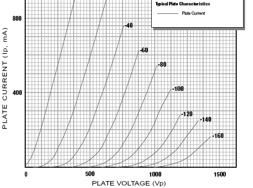

BTW, when looking for a tube, what sort of characteristics am I looking for, other than power handling? For example, I was looking at this 300 W Svetlana designed for audio applications:
http://www.svetlana.com/graphics/products/pdf/3CX300A1.pdf
Now, I don't know anything about tubes, but since we are looking at current output, I assume a high transconductance is needed. So is that tube's too low for this application, given it's a triode (it's about twice that of a 6DJ8)? Also, on some website I read this:
"Transconductance in triodes and pentodes increases quite dramatically with plate current, which is a source of distortion because it increases as the signal swings negative and decreases as it swings positive (at the plate). This is the basic distortion mechanism in all active devices, vacuum and solid state."
What types of tubes would then have smaller distortion? Tetrodes?

Like I said, the basic 3/2 power law that exists at all times in all tubes. The idea being, if you take a certain operating point, a differential increase in grid voltage will cause a respective increase in plate current. This increase is a percentage of the previous current (how so depends on the characteristics; tubes are 3/2 power while SS is exponential), thus Gm increases without bound, in step with current... of course, dissipation limits this from being infinite.
If NFB is applied, tetrodes have lower distortion than triodes. (Lots of transistors have even less, but that's sheer gain at work.)
I wouldn't worry about absolute parameters, stick to class A1 current capacity and dissipation. Gain (mu or Gm) can be amplified by other stages.

Triodes are the worst due to internal NFB; holding current constant, minimum voltage depends on perveance and current drawn (and if you are allowing grid current). A 12AX7 (low perveance) bottoms out at 2.1mA at 100V, 6SN7 at 10mA and 6KD6 at 720mA. Generally speaking it is proportional to heater power and inversely proportional to mu.
Screen grid tubes have Vsat as low as 30V (6V6; or less for signal types) on up to 500V or more for transmitter pentodes. Tetrodes (particularly beam tets) are better because the curve has a sharper knee; compare EL34 to 6L6, for instance. Because of the very limited internal NFB, they have a much higher impedance (read: better CCS characteristic, requiring little grid compensation). That's the flat part of the plate curve.
All transistors have the same characteristic (except "plate resistance" is called "Early effect"), but at lower voltages (down to 0.1V or less) and higher currents (a nice MOSFET can easily do 40V saturation at 40A, i.e., 1 ohm Rdson). (There is no BJT, no FET, anything which has the low impedance characteristic of a triode.) As such, a CCS will perform better, but cannot handle as high voltages - I haven't seen *any* transistor capable of more than 1.5kV.

So what do you recommend for best performance? Hopefully something that won't drop more than something on the order of 500 V at the average current (between 150 and 200 mA for a channel).
Triode, tetrode, pentode, BJT, MOSFET, or some kind of hybrid?
Keeping in mind that the audio frequency modulation is going to be less than 10 percent, what about having most of the current dropped by some device as a constant current sink, and just enough to do audio frequency modulation by a controlled current sink in parallel with the other device. This would allow the audio device to be chosen for linearity rather than power handling.
BTW, since I don't know anything about tubes, how can I calculate what voltage it will drop to get a given current, using data in the standard datasheet?

I'd go with a good transmitter tetrode or pentode... although if dissipation isn't too high a sweep tube would handle it (rated upwards of 5kV, at least in cutoff). Look at the plate curves, set voltages as shown and the plate responds according to whichever grid line you're on. You'll want to cathode bias it to get additional degeneration which increases Zo. If you have a screen voltage (instead of grid voltage being traced multiple times) graph, you can find a reasonable screen voltage to reduce required grid bias. Remember screen is just a control grid with so little transconductance that it needs to be at a positive voltage to keep current flowing; you can throttle the tube just as well with both, minus Gm that is.
