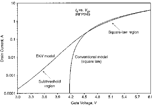

That depends on what you want to extract. But I do agree they are not good models.
On the other hand I can understand manufacturers also do not want to give too much details away to competitors.
You can, e.g., only get models from Toshiba by written request, from a company (commercial customer).
My 2 pfennig -- aren't we working in the sub-threshold region of the mosfet anyway? (Not the square law region) so you have to run Id vs Vgs graph over a much lower range of currents and build your own EKV model. These low Id/Vgs data aren't published by the manufacturer so you'll need a curve tracer.
I don't have a FQP3N80C on hand, but will get a couple from DK on the next order, and put them through their paces on the 576.
Just so ya know, the EKV model is Level 44, at least in Multisim. Cordell uses a VDMOS model and EKV model in parallel for the sub-threshold region -- and MSIM does not support LTSpice VDMOS.
